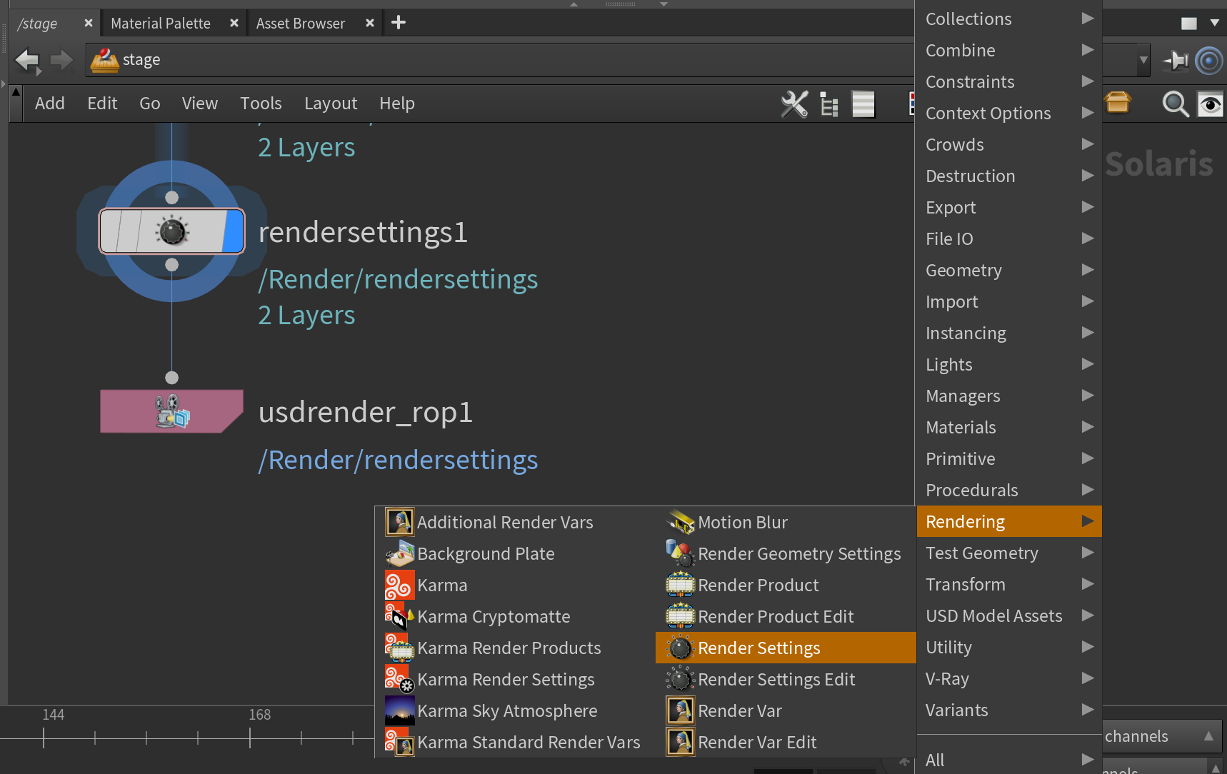

Create a Render Settings LOP from ||stage Network|| > Rendering > Render Settings.
Then connect a USD Render LOP (||stage Network|| > Managers > USD Render ROP) to the Render Settings LOP.

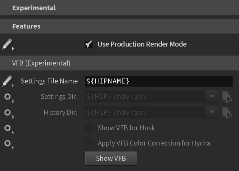

Go to Render Settings LOP > V-Ray tab > Render Settings subtab > Output tab and enable the Use Production Render Mode option.
Specify the Settings File Name field.

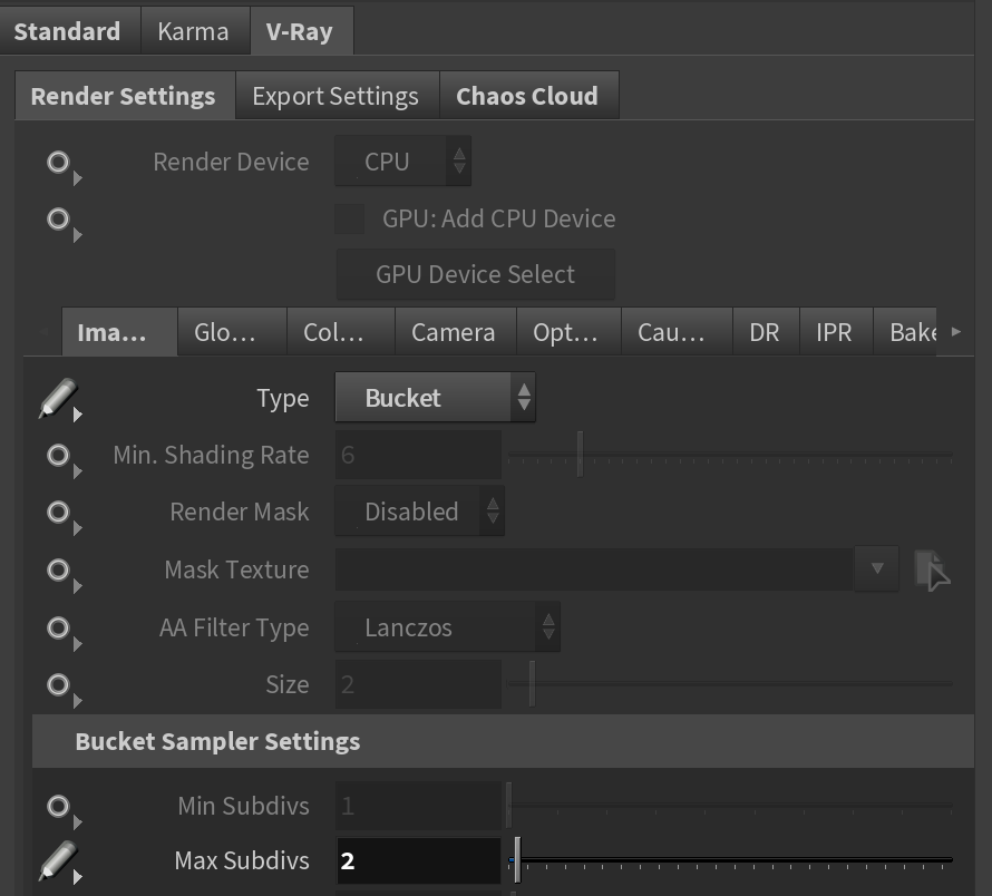

Go to Render Settings LOP > V-Ray tab > Render Settings subtab > Image subtab  and configure the settings there.
You can set the type of rendering to Bucket and adjust the Max Subdivs, for example.

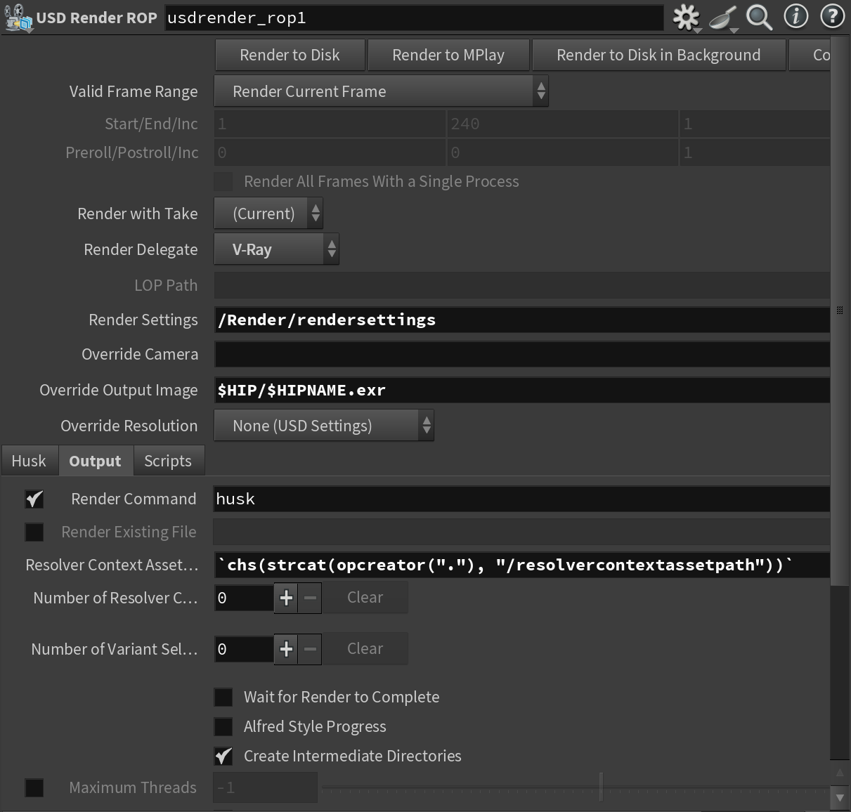

Configure the USD Render LOP parameters.
Once ready with the configuration, click Render to Disk to send your job to the Chaos Cloud for rendering.

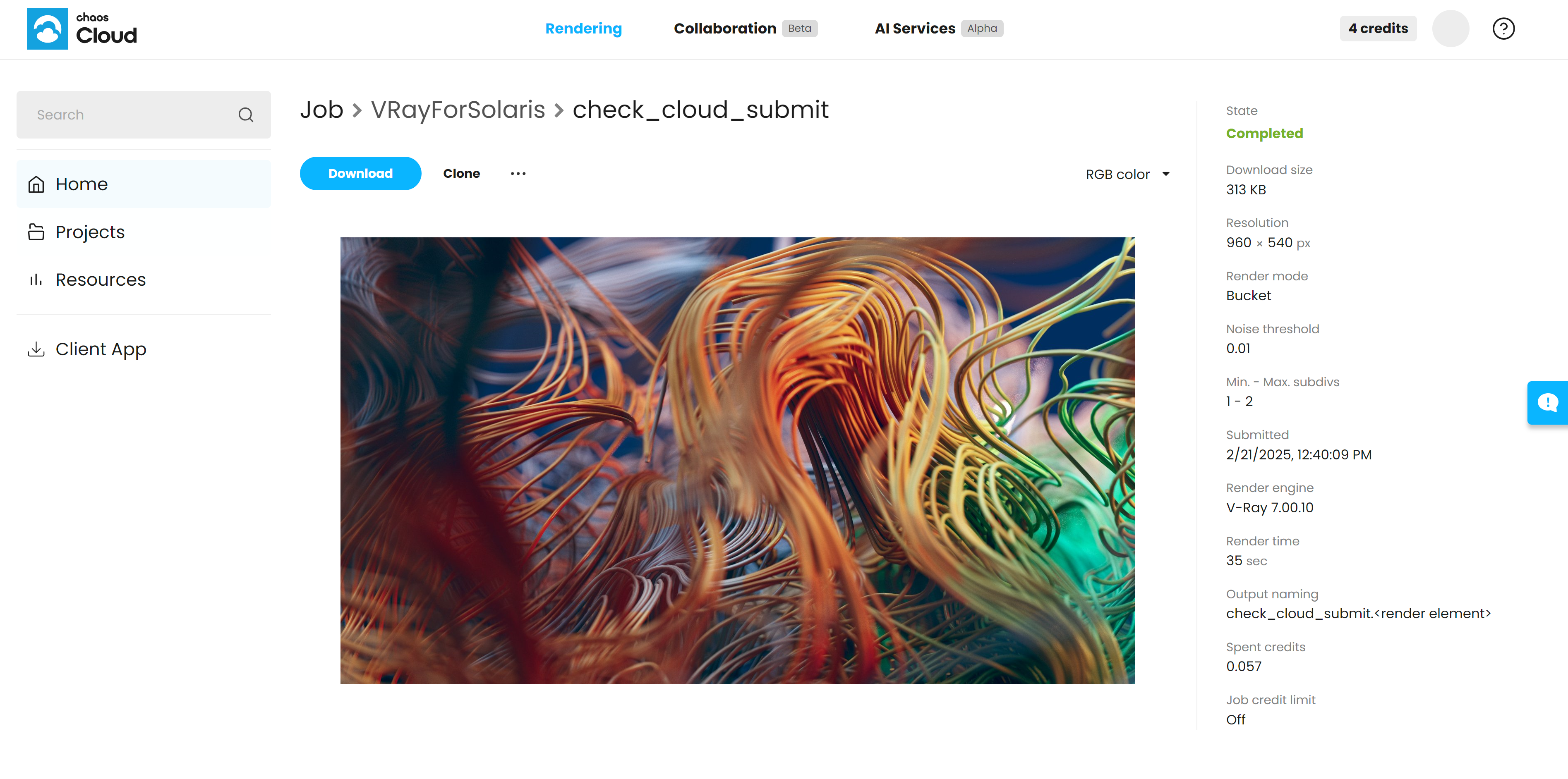

You can check your job at https://cloud.chaos.com/
There you can monitor the status of your render jobs, download them, organize them in projects, resubmit, or delete them.
