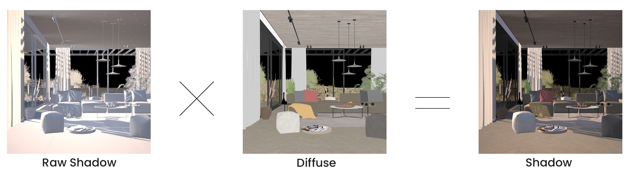

The Shadows render element is the product of multiplying the Raw Shadow Render Element with the Diffuse Render Element in the composite.

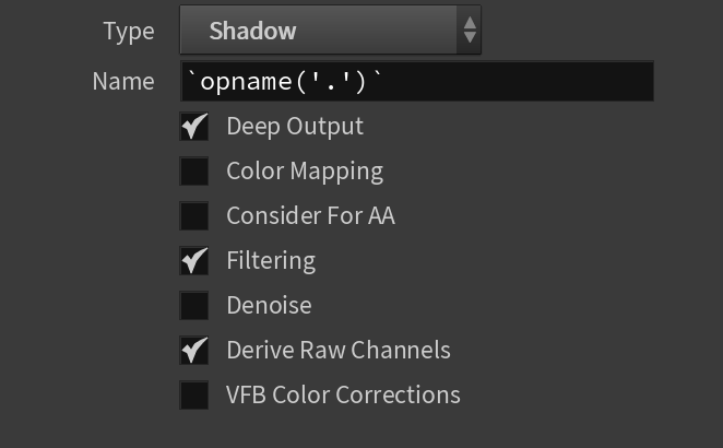

Attributes
The parameters for this render element appear in the V-Ray RenderChannelColor render channels node.
Deep Output – Specifies whether to include this render element in deep images.
Color Mapping – When enabled, the Color Mapping options in the render settings are applied to the current render channel.
Consider For AA – When enabled, anti-aliasing is used where possible.
Filtering – Applies the image filter to this channel. Image filter settings are in the Image Sampler tab of the Sampler tab of the V-Ray Renderer node.
Denoise – Enables the render element's denoising, provided the V-Ray Denoiser render element is present.
VFB Color Corrections – Applies the post render color adjustments made from the VFB.

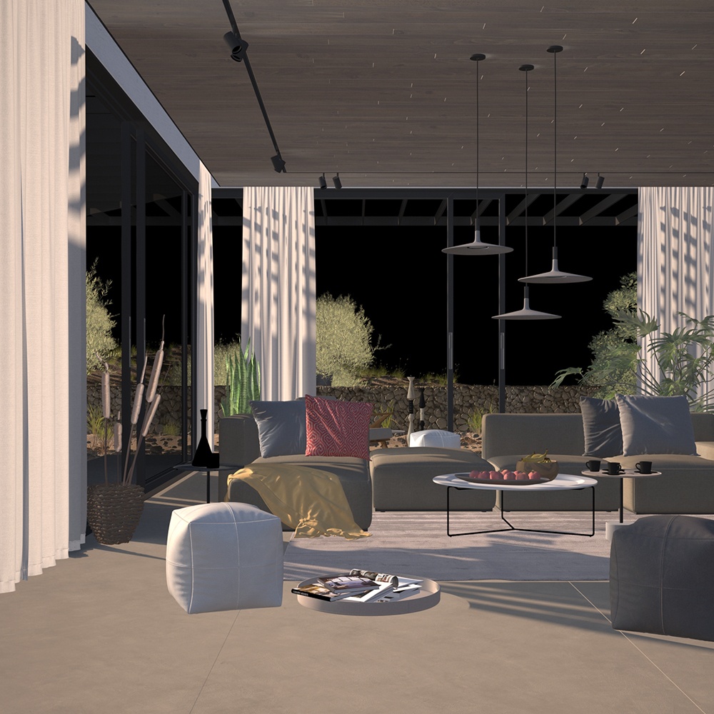

The Shadow Render Element is useful for changing the appearance of shadowed areas in a compositing or image editing application. In the example the Shadow RE is subtracted from the Beauty element, resulting in a darker render.
Before
After
Underlying Compositing Equation
Raw Shadow x Diffuse = Shadow
