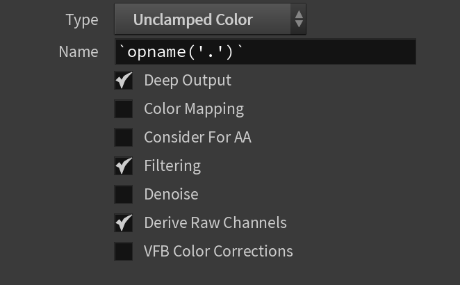

The parameters for this render element appear in the V-Ray RenderChannelColor render channels node.
Deep Output – Specifies whether to include this render element in deep images.
Color Mapping – When enabled, the Color Mapping options in the render settings are applied to the current render channel.
Consider For AA – When enabled, anti-aliasing is used where possible.
Filtering – Applies the image filter to this channel. Image filter settings are in the Image Sampler tab of the Sampler tab of the V-Ray Renderer node.
Denoise – Enables the render element's denoising, provided the V-Ray Denoiser render element is present.
VFB Color Corrections – Applies the post render color adjustments made from the VFB.

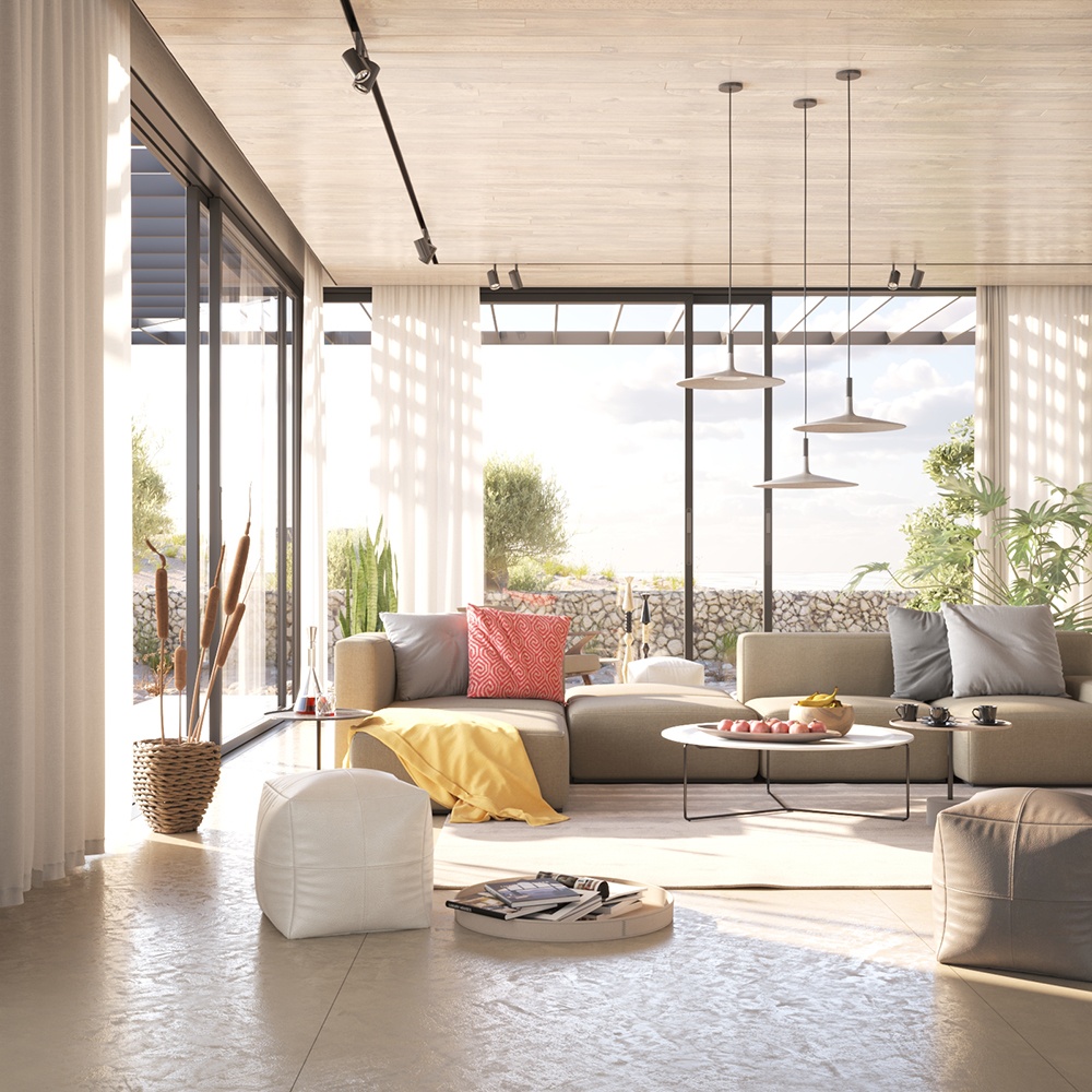

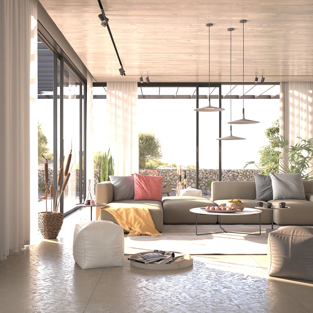

The Unclamped Color Render Element is useful for revealing the true values of clamped colors and editing their look in a compositing or editing software. See the render before and after compositing.
Before
After
