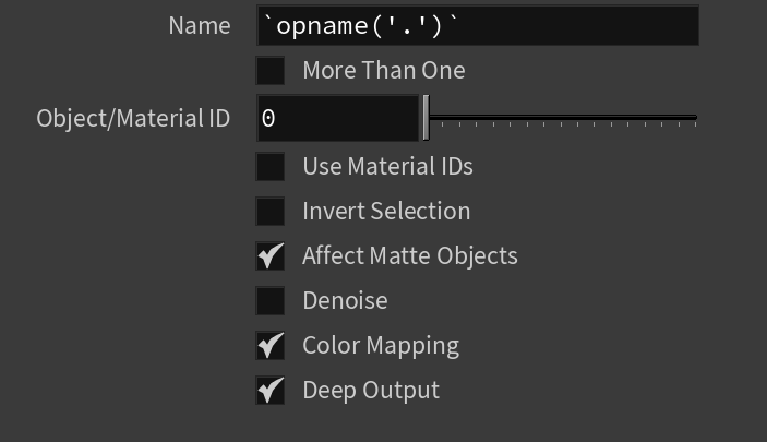

Name The text added to the end of the rendered file, when saved as a separate file.
More Than One – When enabled, more than one object is exported.
Object/Material ID – List of selected IDs included in this render pass.
Use Material IDs – When enabled, the pass considers the Material ID and renders accordingly. When disabled, these values are considered to be the Object ID.
Invert Selection – Use the opposite of the selected objects in the render pass.
Affect Matte Objects – Specifies whether to include matte objects when generating the render element. A matte object is an object that has been assigned a Wrapper Material.
Denoise – Enables the render element's denoising, provided the V-Ray Denoiser render element is present.
Color Mapping – When enabled, the Color Mapping options in the render settings are applied to the current render channel.
Deep Output – Specifies whether to include this render element in deep images.

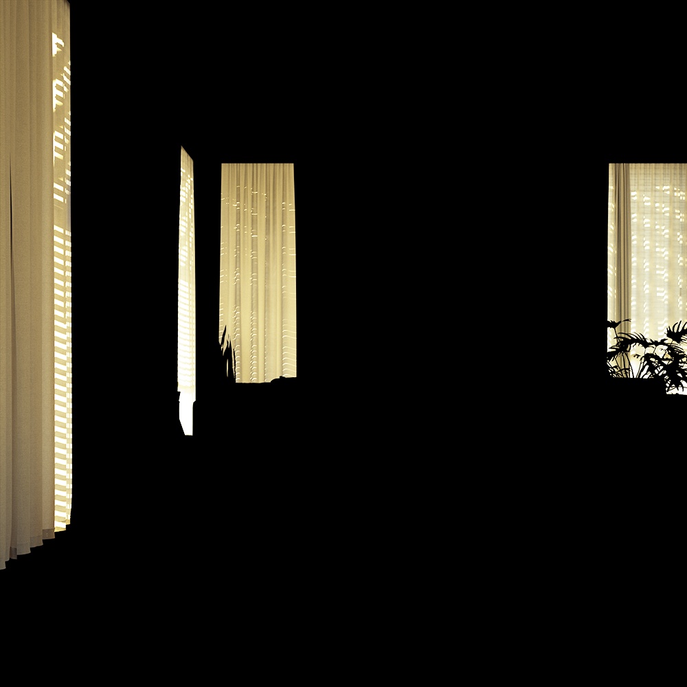

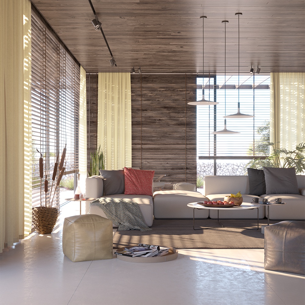

The Object Select render element allows items to be isolated for easier control at a composite level. In the example shown below, the curtains are color corrected and tinted yellow.

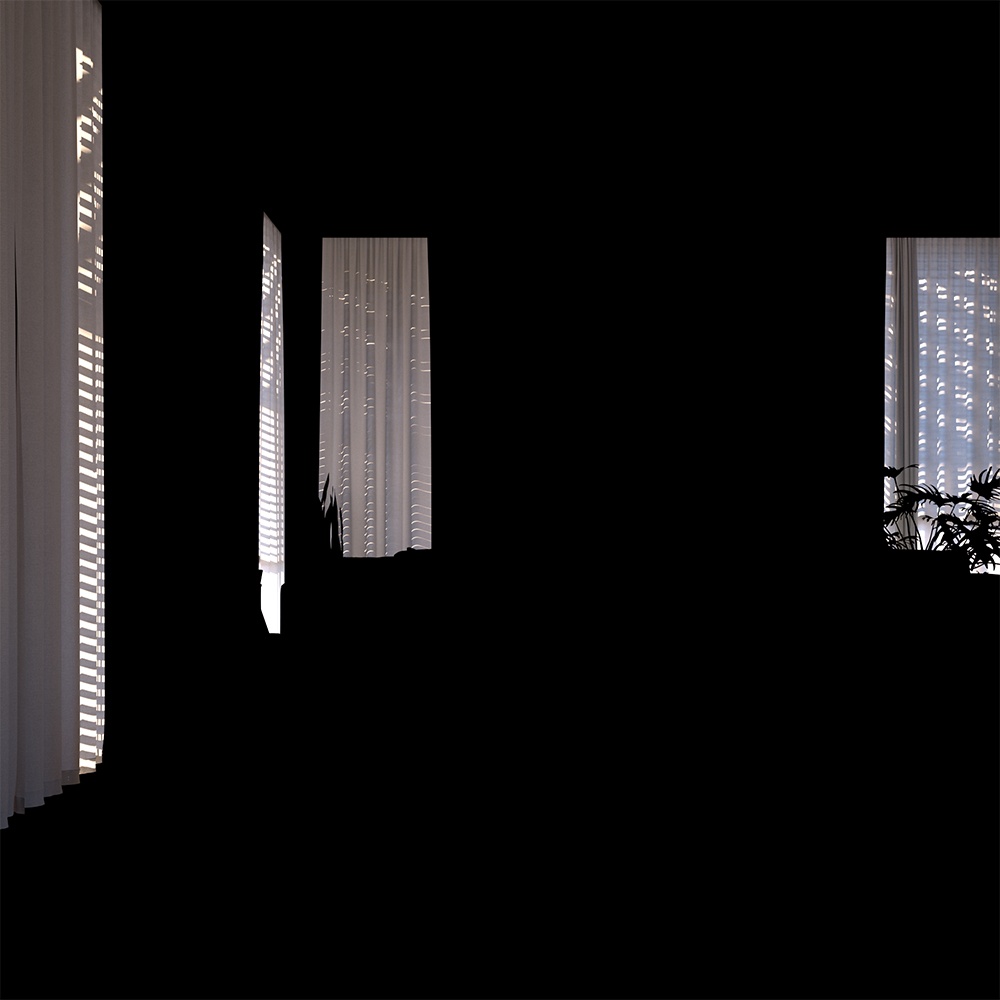

V-Ray Object Select

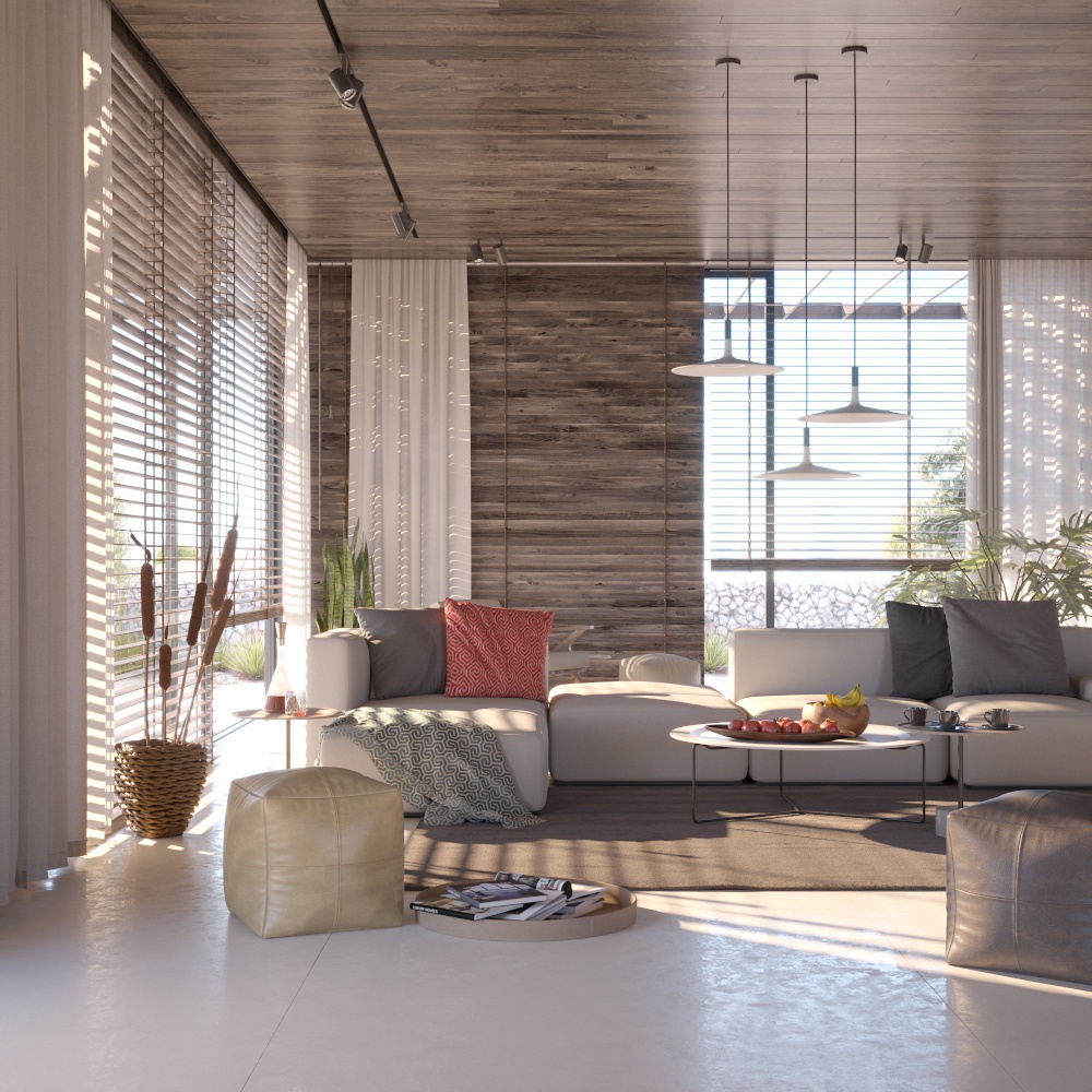

Original Beauty composite
V-Ray Object Select edited
Resulting Beauty composite
