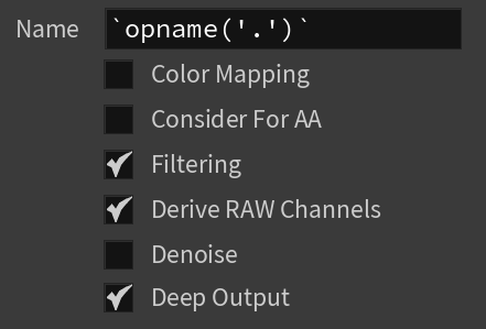

The parameters for this render channel appear in the Parameters tab under the out Network and within the render elements node.
Name – The text added to the end of the rendered file, when saved as a separate file.
Color Mapping – Applies the color mapping options specified in the Color mapping tab of the V-Ray Renderer to this render element.
Consider For AA – When enabled, antialiasing is considered where possible.
Filtering – Applies the image filter to this channel. Image filter settings are in the AA sub-tab of the Sampler tab of the V-Ray Renderer node.
Derive RAW Channels – Generates data in the raw channels by combining the respective color and the filter color channels.
Denoise – Enables the render element's denoising, provided the V-Ray Denoiser render element is added.
Deep Output – Specifies whether to include this render element in deep images.
