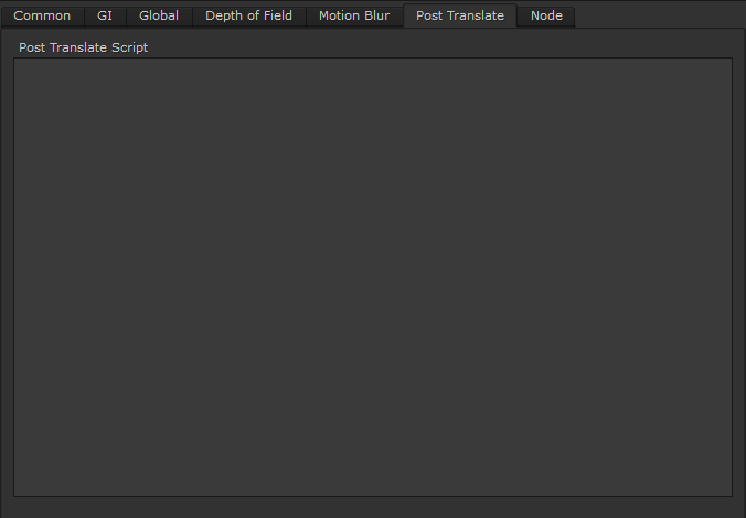

You can specify the Python script to be executed in the VRayCommon tab of the Render Settings dialog, in the MEL/Python callbacks rollout. The script is executed right after the scene is translated and before it is rendered and/or exported to a .vrscene file. When rendering an animation, the script is executed just once, before any frame is rendered.
UI Path: ||Select VRayRenderer|| > Properties Panel > Post Translate tab
