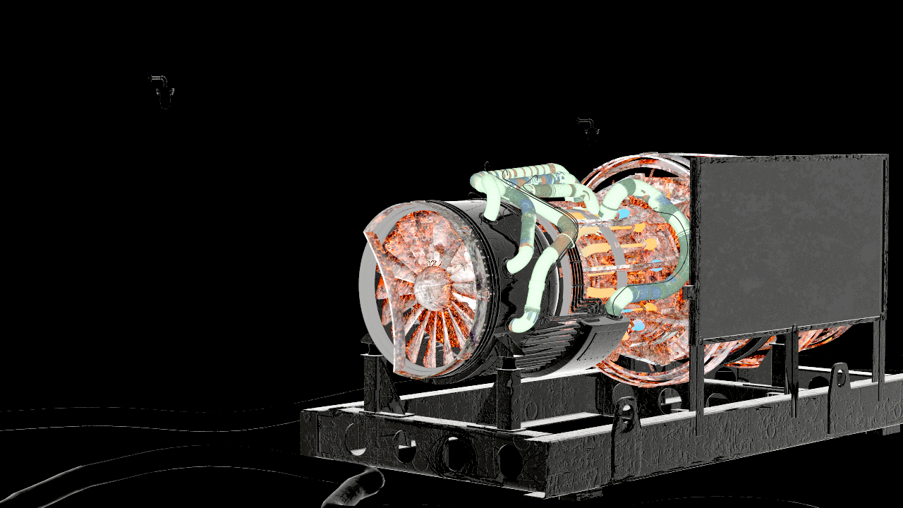

The Reflection Filter Render Element stores reflection information calculated from the materials' reflection values in the scene. Surfaces with no reflection values set in its material(s) will contain no information in the render pass and will therefore render as black.
While the Reflection Raw Render Element gives the full reflection of objects reflecting in the scene, Reflection Filter shows how much of that reflection should come through in the composite. In other words, the filter defines the strength of the reflection, while the raw image defines what is being reflected in the image. When these two elements are multiplied, the true level of reflection is given and produces the Reflection Render Element. Using these component parts of the reflection, you can better fine tune the reflection in your final composite.

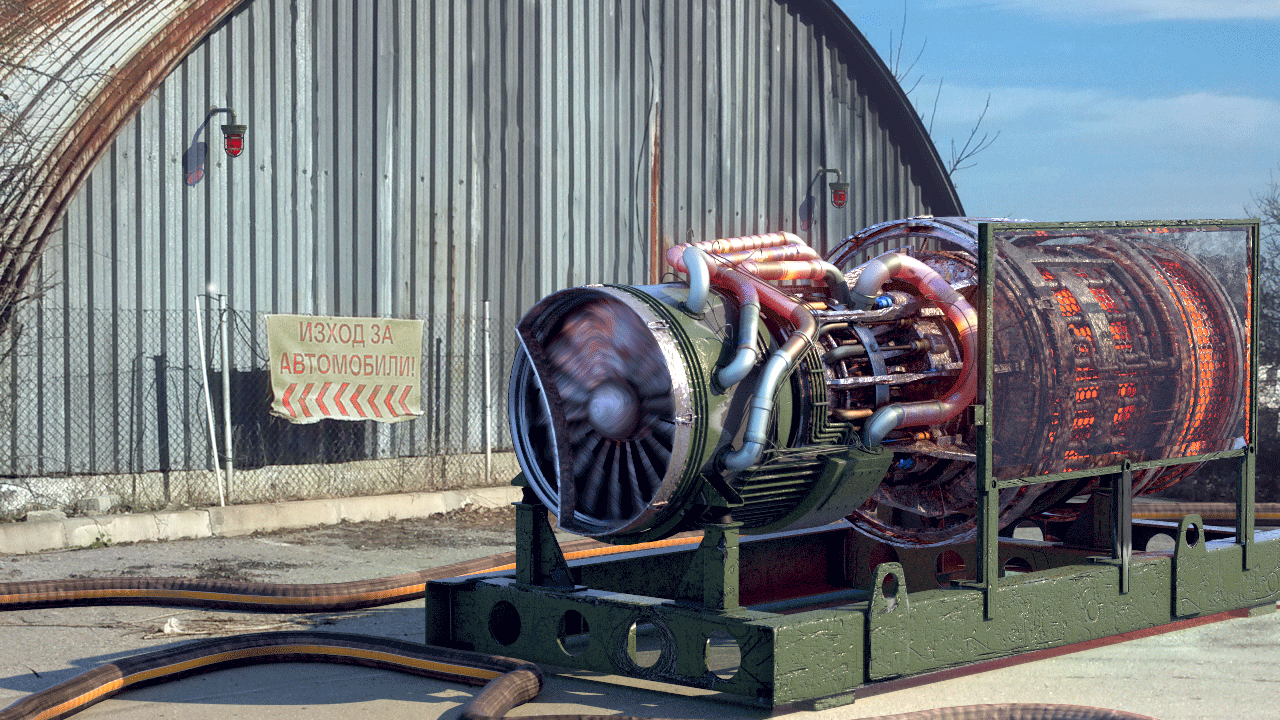

The Reflection Render Element is useful for changing the appearance of Reflective elements after rending in a compositing or image editing software. Below are a couple of examples of their use.
The Original Beauty Composite
More contrast added to Reflection Filter
Brighter with more contrast Reflection Filter
Reflections with more contrast

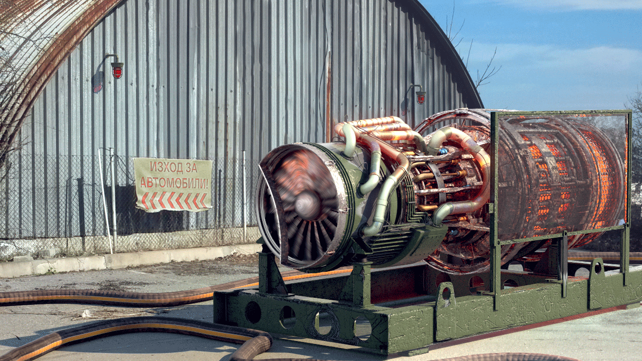

Brighter Reflections with more contrast

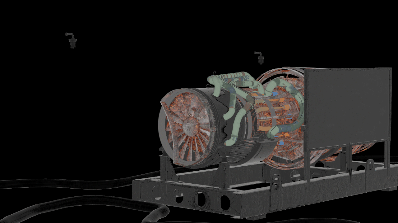

Cooler, brighter with more contrast Reflection Filter
Cooler, brighter Reflections with more contrast
Underlying Composite
Reflection = Reflection Raw x Reflection Filter
