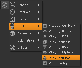

UI Path: ||Toolbar|| > V-Ray menu icon > Lights > VRayLightSpot

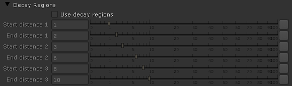

Decay Regions
Use decay regions – Enables decay regions to be used with the V-Ray Spotlight.
Start distance – Specifies the distance of the decay region's starting point.
End distance – Specifies the distance of the decay region's ending point.
