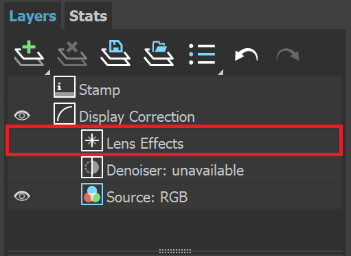

V-Ray Lens Effects simulates real-world camera lens effects such as bloom and glare. The plug-in uses a fast multi-threaded technique to compute the result and provide immediate update in the new V-Ray VFB. V-Ray Lens Effects are applied in the effectsResult channel together with other post effects executed over the RGB rendered image.
The Lens Effects layer is accessible from the Layers panel in the new VFB and can be activated when the lens effects are enabled. It can be blended with the rest of the layers in the new VFB.
Additionally, V-Ray includes a standalone Lens Effects Generator Tool for composing custom lens filters.
Lens Effects layer can be disabled from the visibility icon ().

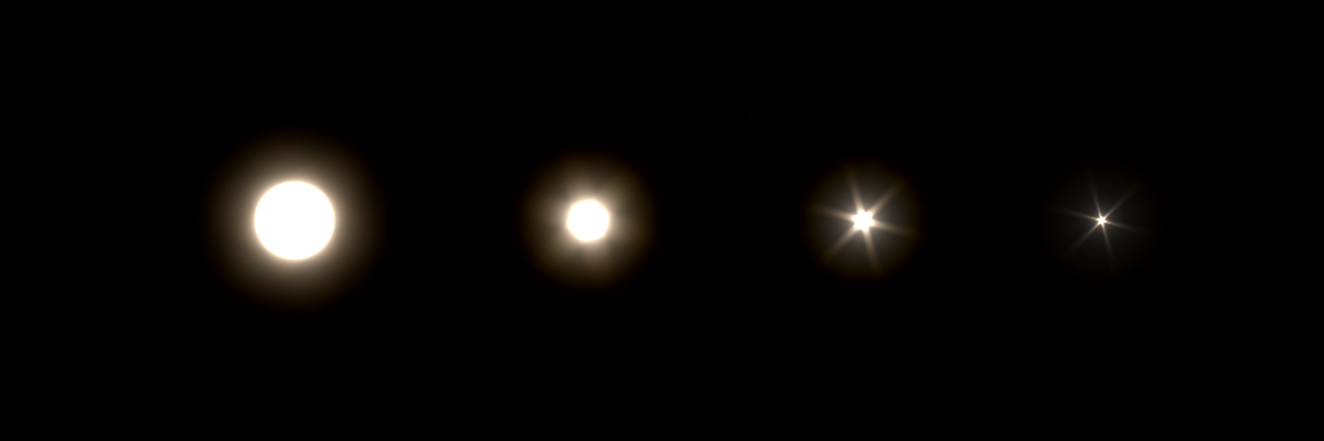

Example: Size
Size = 1
Intensity (constant) = 1.00
Size = 10
Size = 20
Size = 30
Size = 40
Size = 50
Size = 60
Size = 70
Size = 80
Size = 90
Size = 100

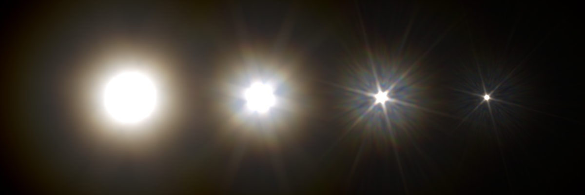

Example: Bloom / Glare
Bloom = 0.0
Streak blur (constant) = 0.20
Bloom = 0.1
Bloom = 0.2
Bloom = 0.3
Bloom = 0.4
Bloom = 0.5
Bloom = 0.6
Bloom = 0.7
Bloom = 0.8
Bloom = 0.9
Bloom = 1.0

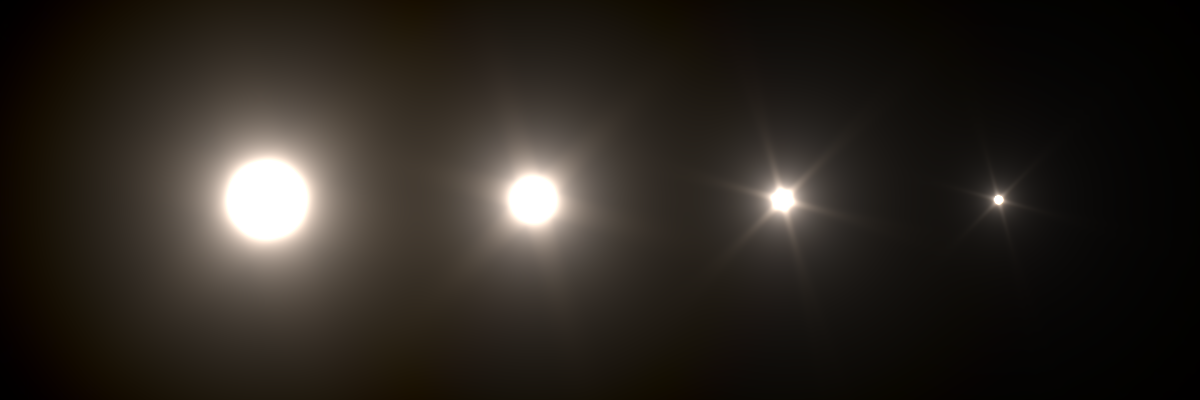

Example: Intensity
Intensity = 0
Size (constant) = 50
Intensity = 1
Intensity = 2
Intensity = 3
Intensity = 4
Intensity = 5
Intensity = 6
Intensity = 7
Intensity = 8
Intensity = 9
Intensity = 10

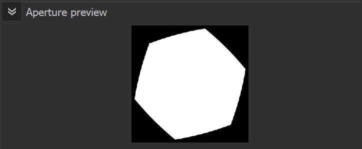

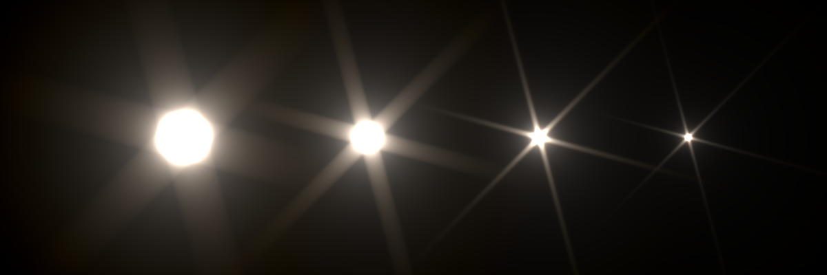

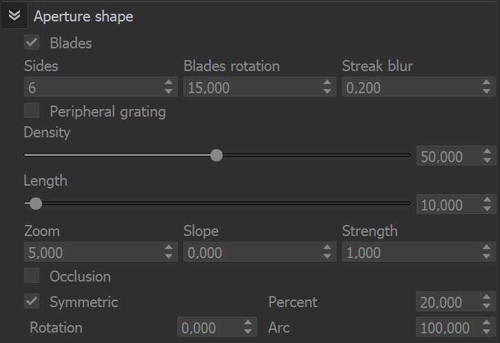

Aperture Shape
Clicking the button displays/hides the parameters of the rollout.
Blades – Enables the Blades effect.
Sides – Sets custom camera aperture blades number to be considered for the lens effects. This parameter directly controls the number of "rays" of the glare.
Blades rotation  Controls the rotation of the camera aperture and blades.
Streak blur – Determines the width of the angle at which glare rays spread. The larger the value, the wider the spread. If set to 0, rays are directional; if set to 1, glare rays spread out and completely blend together. Observe in the Streak blur example below how values in-between change the glare rays appearance.
Peripheral grating – Enables grating along the sides of the aperture shape.
Density – Controls the density of the grating effect in percent, where 100 is fully black.
Length – Controls the length of the grate lines.
Zoom – Controls the size of the halo around the lights.
Slope – Controls the direction of the lines.
Strength – Controls the strength of the blades effects.
Occlusion – When enabled it controls the aperture shape by occluding part of it.
Symmetric – Enables symmetric occlusion of the shape. When disabled, the occlusion appears only on one side of the shape.
Percent – Controls how much of the shape is occluded.
Rotation – Determines the position of the occlusion over the shape by rotation.
Arc – Controls the arc of the occlusion. A value of 0 sets a straight line, while a value of 100 makes an arc.

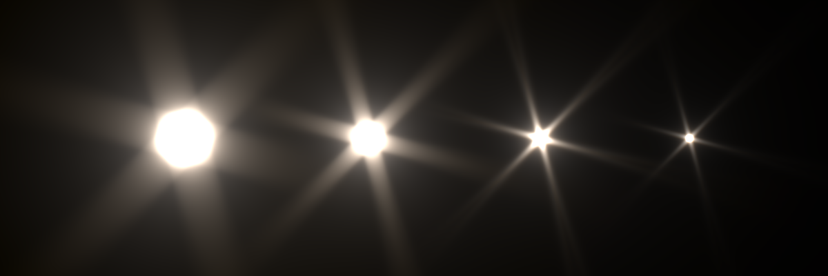

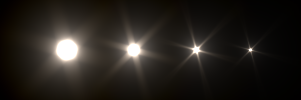

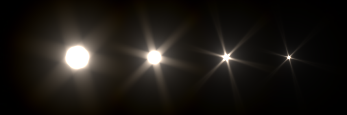

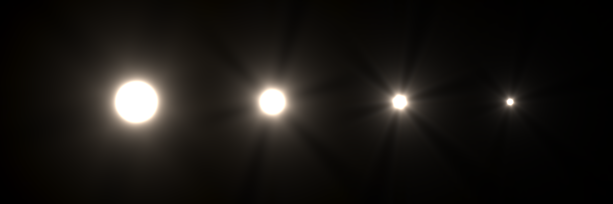

Example: Streak blur
Streak blur = 0.0
Bloom (constant) = 0
Streak blur = 0.1
Streak blur = 0.2
Streak blur = 0.3
Streak blur = 0.4
Streak blur = 0.5
Streak blur = 0.6
Streak blur = 0.7
Streak blur = 0.8
Streak blur = 0.9
Streak blur = 1.0

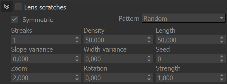

Lens Scratches
Lens scratches – Enables the lens scratches effect.
Symmetric – When enabled creates symmetric pattern of the scratches. This option is available only when Pattern is Random.
Pattern – Specifies RandomStripesSquare or Hexagonal type of pattern for the scratches.
Streaks – Specifies the number of streaks that are clustered together. If Symmetric is enabled, the streaks are stemming from one point with equal angles. If Symmetric is disabled, the streaks are scattered from random angles.
Density – Controls the density of the scratches effect in percent, where 100 is fully black.
Length – Controls the length of the scratches.
Slope variance – Randomizes the direction of the scratches.
Width variance – Randomizes the width of the scratches.
Seed – Specifies a seed parameter to introduce variance in the randomization.
Zoom – Controls the size of the pattern.
Rotation – Determines the position of the scratches by rotation.
Strength – Controls the strength of the effect.

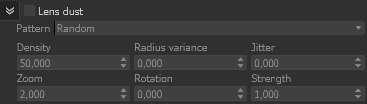

Lens Dust
Lens dust – Enables the lens dust effect.
Pattern – Specifies the RandomSquare or Hexagonal type of pattern for the dust.
Density – Controls the density of the dust effect in percent, where 100 is fully black.
Radius variance – Specifies a variance in the radii of the dust dots. A value of 0 makes the dust dots uniform.
Jitter – Controls randomization of the position of the dots.
Zoom –  Controls the size of the dust dots.
Rotation – Determines the position of the dust dots by rotation.

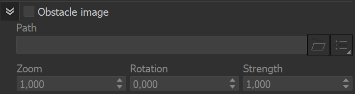

Obstacle Image
Obstacle image – When enabled an obstacle image can be specified. You can use it to simulate various effects on the camera lens. See how this changes the lens effects in the Obstacle Image example below.
Load Obstacle Image – Loads an obstacle image.
BrowseOpens a browser to search for an obstacle image.
RecentShows a list of recently used obstacle images.
Zoom – Controls the size of the obstacle image.
Rotation – Rotates the obstacle image.

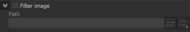

Filter Image
Enabling this rollout disables the controls for the generated filter:
Filter image – Enables a filter image from the Filter generator tool to be used.
Load Filter – Specifies the path to a filter kernel. You can create filters using the Filter generator tool which comes with the V-Ray for 3ds Max installation.
Browse – Opens a browser to search for a filter image.
Recent – Shows a list of recently used filter images.
