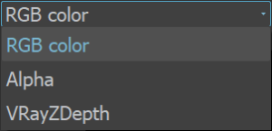

This dropdown gives access to render elements rendered for the scene. The selected render element is displayed in the VFB. By default, the RGB color and Alpha render elements are available. Any additional render elements that have been added to the scene also appear in the drop-down.

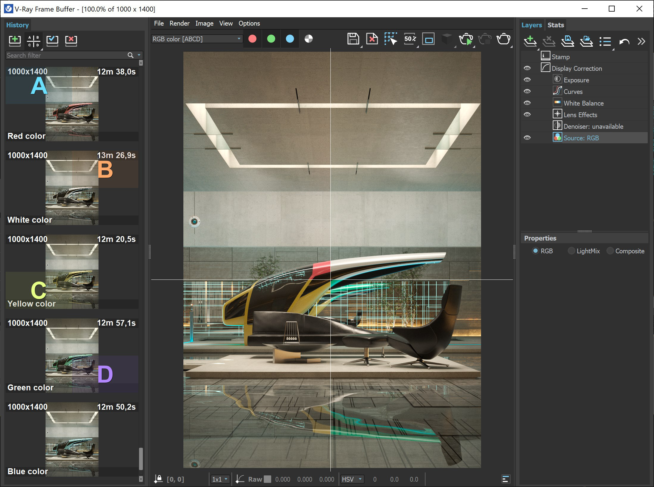

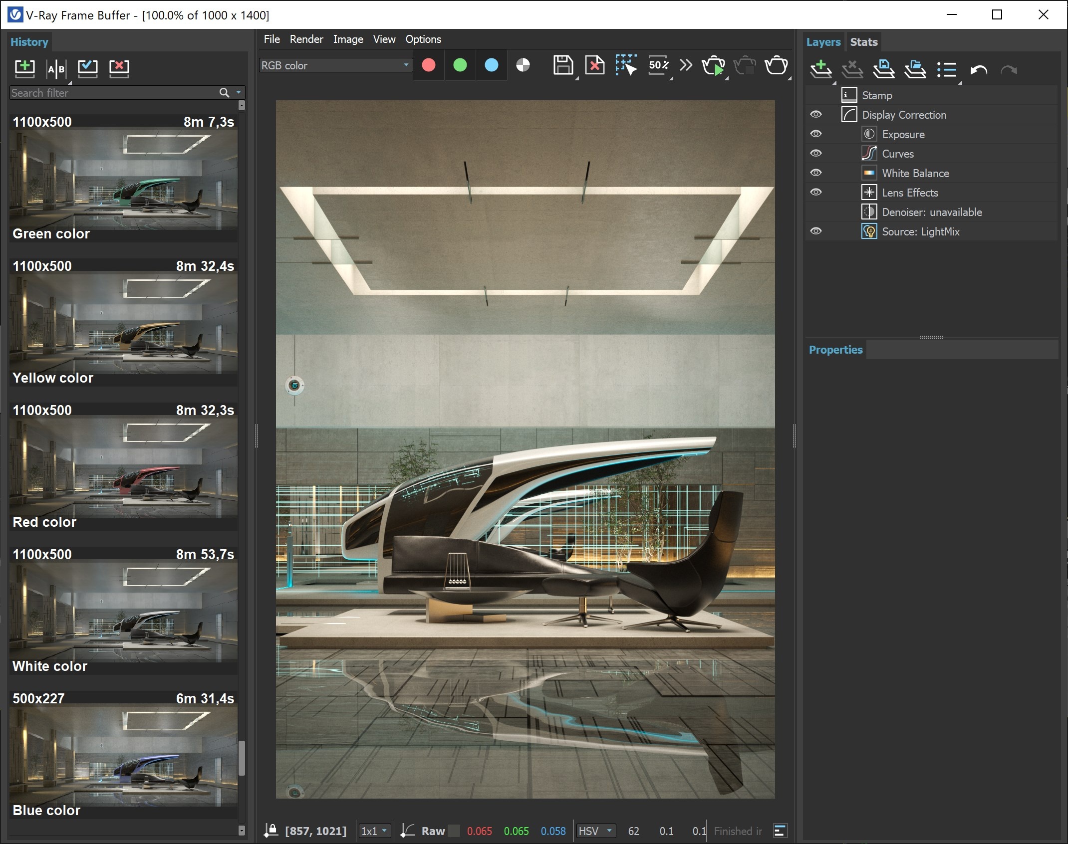

Render History
The V-Ray VFB keeps a history of previously rendered images, and lists each with a number, thumbnail, and textual details in the Render history panel. Up to four images can be called from the history to be compared in the VFB (as shown below). History files are stored as .vrimg files in a user-specified folder. Render history settings can be configured in the VFB Settings window.
Enables or disables image A/B vertical comparison. Select images A and B from the render history.
Enables or disables image A/B horizontal comparison. Select images A and B from the render history.
Enables or disables image A/B/C/D comparison. Select images A, B, C and D from the render history.
Saves the current image from the VFB to the render history. The image is placed at the top of the render history list.
Loads the selected image from the render history to the VFB.
Removes the selected image from the render history.
A search field where you can filter the images based on the scene paths and notes. The filter text is selected when pressing the Enter from the keyboard.
The keyboard keys from 1 to 9 can be used to quickly load the first 9 images from the history to the VFB.
The History panel with notes/name, resolution/time, and shortcut key info displayed. Right-clicking on an image in the VFB history brings up a pop-up menu with some useful options.

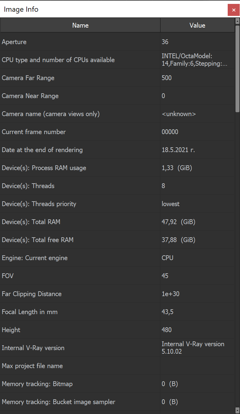

Image Info window
Edit note – Allows you to add a text comment to the image; the comment appears below the image.
Set A – Sets the render as A image for A/B comparison.
Set B –  Sets the render as B image for A/B comparison.
Load to VFB – Loads the selected image in the VFB (same as double-clicking on the image).
Delete – Deletes the selected image from history. The image is moved to the system's Recycle Bin and can be restored from there if needed.
Load layers – Loads the layer tree preset of the selected image.
Load V-Ray settings – Loads the V-Ray settings used for the  saved render.
Compare V-Ray settings – Opens the Compare V-Ray settings dialogue, where you can compare the render settings of saved renders.
Image Info – Opens a window containing detailed information about the image, including, but not limited to Camera, Aperture, FOV, Target Distance, V-Ray version, render time, and also custom attributes specified in the exr metadata of VRayOptionRE render element. Have in mind that the camera values are saved in system units. Also, the vrayrevison info displayed in the list is not related to the saved .vrimg file but to the current V-Ray build installed for 3ds Max.
Open scene – Opens the rendered scene in the viewport. This option works as long as the initial file path of the scene has not changed after the render.
Copy scene path – Copies the full path to the scene.
Copy project path – Copies the full path to the project.
Show in folder – Opens a file explorer with the respective image selected.
Reload history – Re-reads the history image list. This may be needed if the history folder is updated outside of 3ds Max (e.g. from another 3ds Max session).
Manually saved .vrimg files can also be added to the History folder, but they need to be saved with all image channels in one .vrimg file to keep the complete image info.

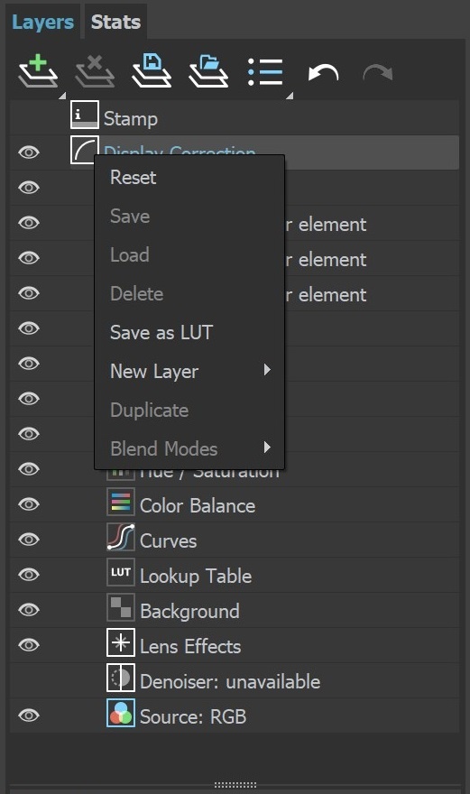

Each layer has a context menu. Right-click to display it:
CommandDescription
ResetResets all changes done to the selected layer.
SaveSaves the layer as a preset.
LoadLoads a preset for the selected layer.
DeleteDeletes the selected layer.
Save as LUTBakes all the color corrections to a LUT file.
New LayerCreates a new layer.
DuplicateDuplicates the selected layer.
Blend ModesSpecifies how the selected layer blends with the result from all layers below it.

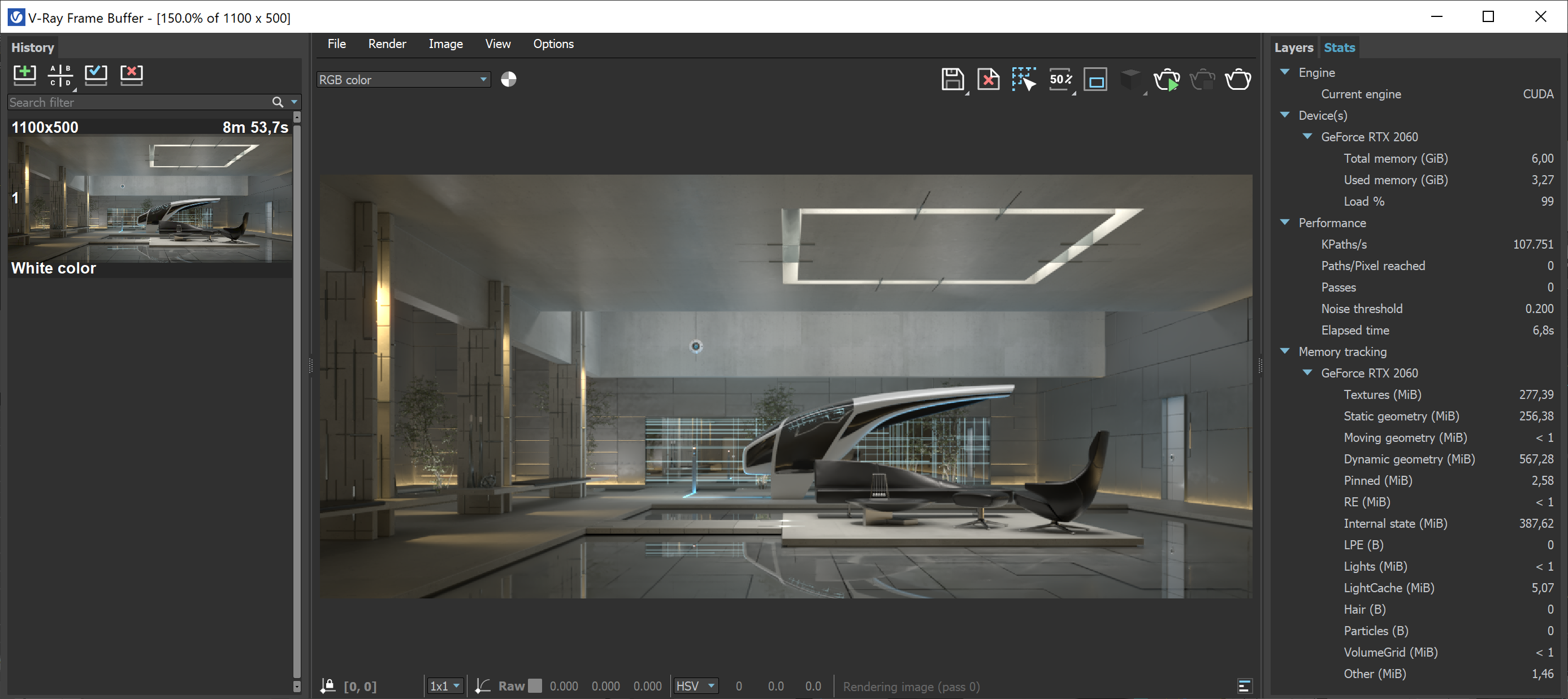

Stats
The V-Ray Frame Buffer allows monitoring of different statistics and information about your scene in the Stats panel. The exact contents of the Stats changes depending on the scene,  the rendering mode (interactive vs production, bucket vs progressive) and others.
Right-click to display a context menu, allowing you to copy the Stats values.
