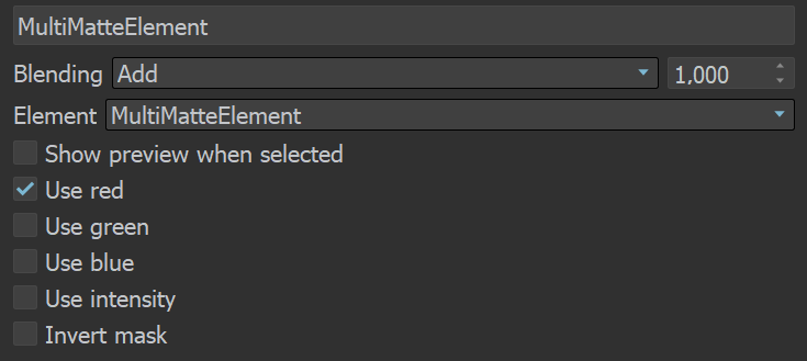

MultiMatte Mask
The MultiMatte Mask is based on the MultiMatteElement Render Element.
Note that this mask may not work on images rendered with older versions of V-Ray.
Use red – When enabled, uses the red channel as a grayscale mask.
Use green – When enabled, uses the green channel as a grayscale mask.
Use blue – When enabled, uses the blue channel as a grayscale mask.
Use intensity – When enabled, uses the pixel intensity as a grayscale mask.

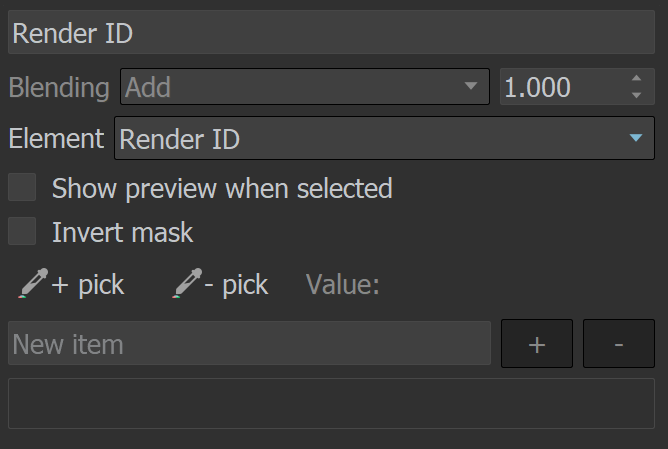

Integer Mask
The Integer Mask is used with VRayRenderID and VRayObjectID Render Elements. You can choose which IDs should be in the mask.
+/- Pick – Allows you to add/remove items by picking them from the Render View. When activated and the mouse is inside the Render View, a red square indicates where the value is exactly picked.
Value – Sows the mask ID on hover over the rendered frame. If you click on a selection in the Render View, the current ID is added/removed from the list below, depending on the Pick mode.
New item – A field to type a mask ID manually and then add it to the current selection with the + button.
+ – Adds IDs to the list.
- – Removes IDs from the list.
Each item in the list has a color icon. The color corresponds to the one saved in the respective render element.
Separate items in the list can be changed by double-clicking on them and editing their names.

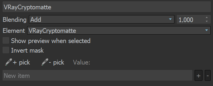

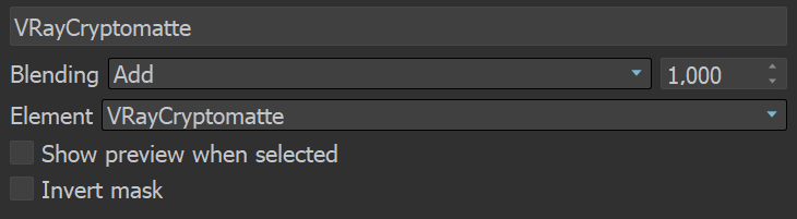

Cryptomatte Mask
The Cryptomatte Mask is based on the V-Ray Cryptomatte Render Element.
Value – Sows the mask ID on hover over the rendered frame. If you click on a selection in the Render View, the current ID is added to the list below.
New item – A field to type in a mask ID and add it to the current selection with the + button. The text is case insensitive.
Wildcards are allowed in the New item field. The following wildcard characters are supported:
* – matches any number of any characters including none (e.g. "Law*" matches "Law", "Laws", or "Lawyer")
? – matches any single character (e.g. "?at" matches "Cat", "cat", "Bat" or "bat")
[abc] – matches one character given in the bracket (e.b. "[CB]at" matches "Cat" or "Bat")
[a-z] – matches one character from the range given in the bracket (e.g."Letter[0-9]" matches "Letter0", "Letter2")
You can create Exclude items via the -Pick button. This is possible when you have wildcard items and then try to -Pick an item that is not present in the list. For example, we can add all boxes from the scene with a wildcard Box* and then exclude only Box001 with an Exclude item. Exclude items have a minus in their icon so they can be distinguished.
