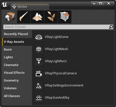

V-Ray Assets Category
The V-Ray Assets category in the Modes tab allows you to quickly create V-Ray related actors.

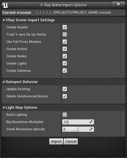

Import vrscene Dialogue
The V-Ray Scene Import Options window appears when you are importing .vrscene files into Unreal.
For more information, see the Import a VRayScene page.
