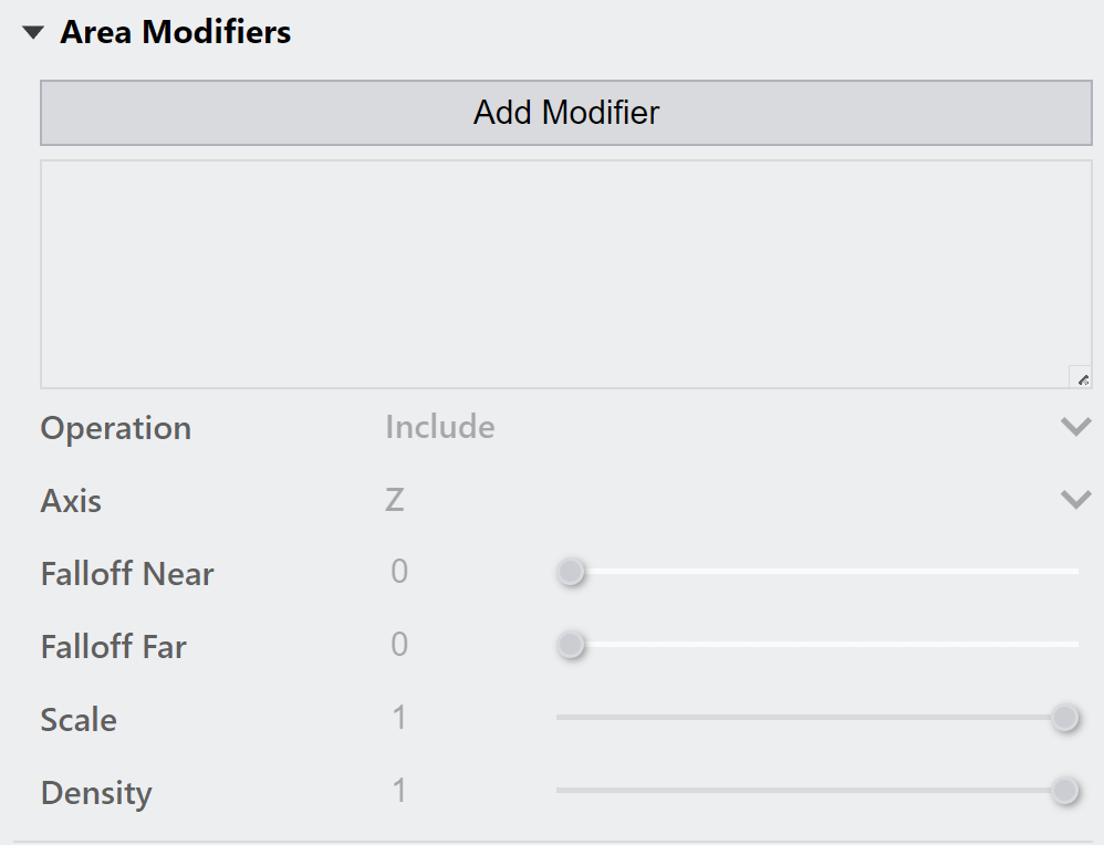

The Area Modifiers rollout is part of the Scatter parameters.
Add Modifier – Specifies objects to be used for generating projected areas of exclusion or inclusion of Scatter guests. These areas are projected along specified axes and determined by the dimensions of objects or splines included in this list. Scatter Area Modifier objects cannot be the same as the Scatter Host objects. Note that Area Modifiers are available only in Surface and Volume Scatter modes.
Operation See the Operation example below.

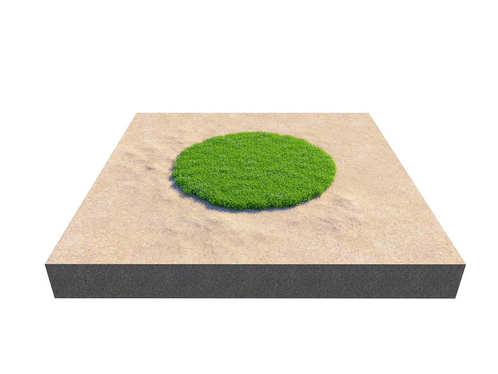

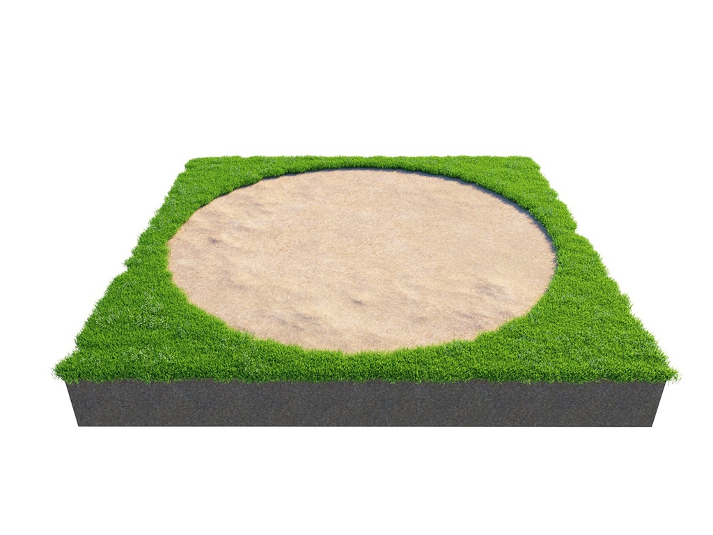

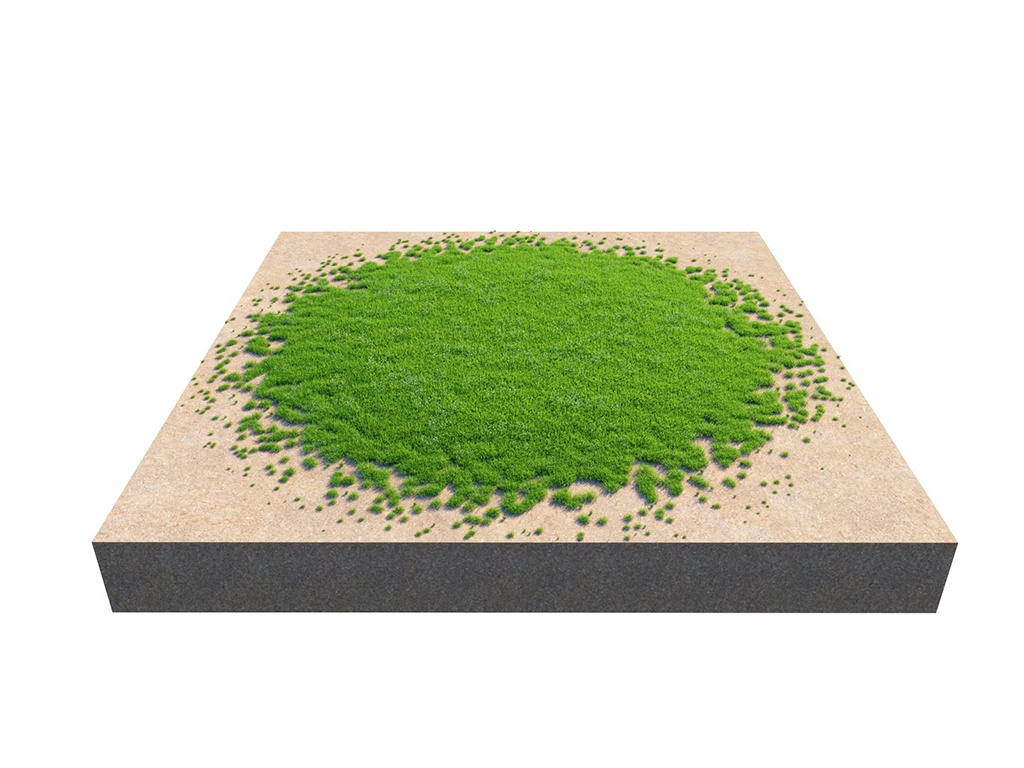

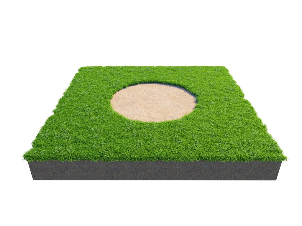

Include – Only instances within the projected area are created.
Exclude Only instances outside the projected area are created.

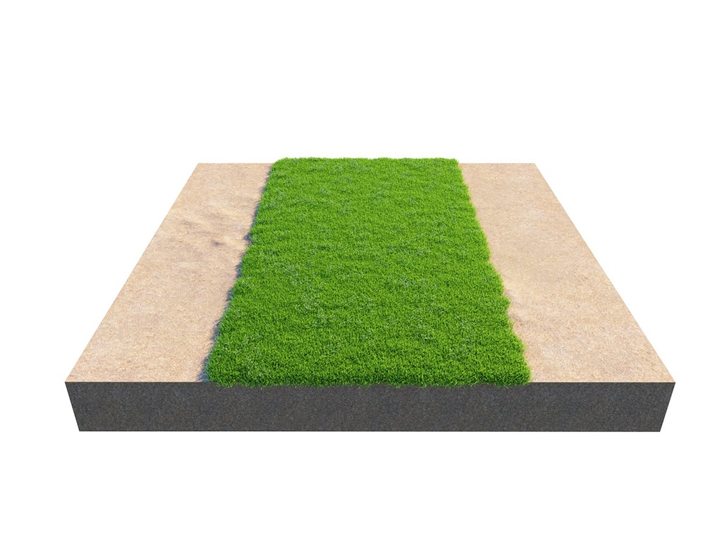

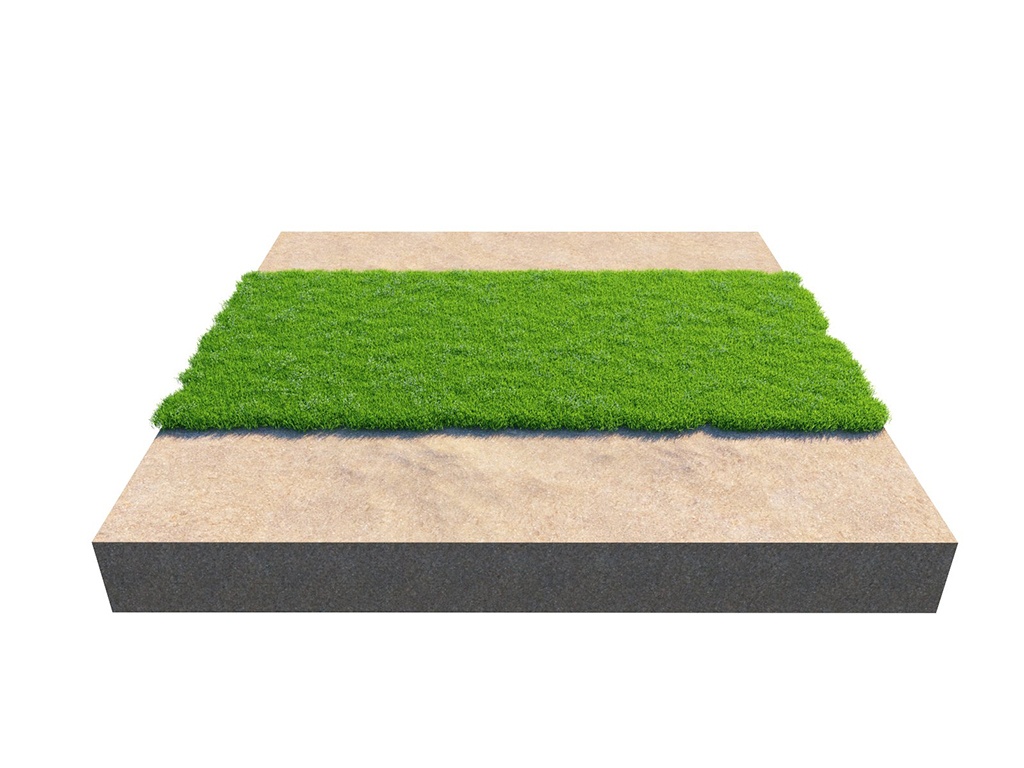

Axis – Determines the plane of the area modifier projection along the X, Y or Z axis. See the Axis example below.

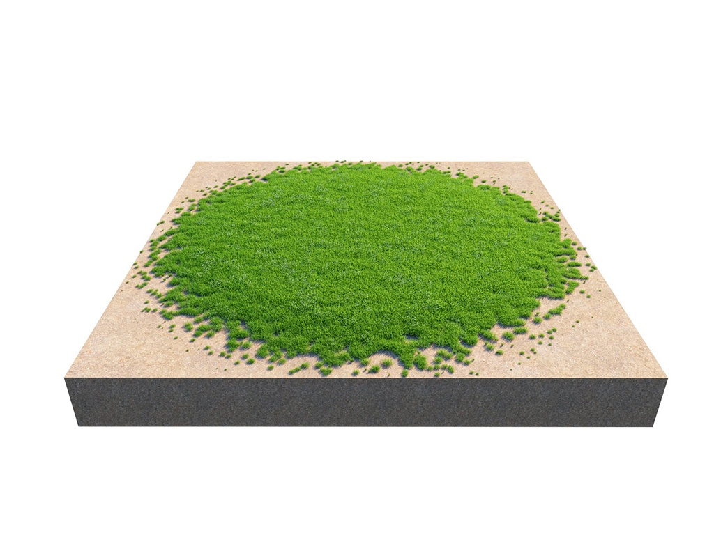

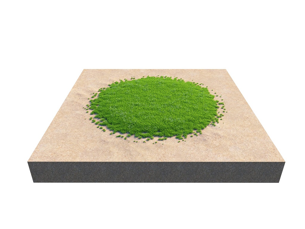

Falloff Near – Determines the distance from the selected area modifier object where the falloff begins its effect. The falloff range is the gradual fading of the area modifier effect between 100% and 0%. See the Falloff examples below.
Falloff Far – Determines the distance from the selected area modifier object where the falloff range ends and the area modifier loses effect.

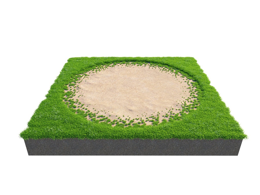

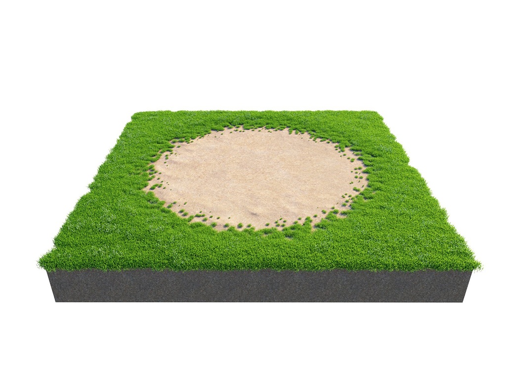

Scale – Scale factor affecting instances between the Near and Far Falloff distances. The value represents the effect strength at the end of the falloff range.
For example, a value of 0.5 causes instances to have a scale of 0% at the Falloff Near distance gradually increasing to 50% at the Falloff Far distance. Note that a value of 0 negates the falloff effect altogether. See the Scale example below.
Density – Density factor affecting instances between the Near and Far Falloff distances. The value represents the effect strength at the end of the falloff range. For example, a value of 0.5 causes instances to appear at a density of 0% at the Falloff Near distance gradually increasing to 50% at the Falloff Far distance. Note that a value of 0 negates the falloff effect altogether.
Offset Area Modifier objects that obstruct your view by moving them along their projection axis. This way they produce the same effect but are out of sight.
Example: Operation
This example shows the difference between the Include and Exclude Operation modes.
Example: Axis
This example shows the modifier projection plane.
01_AreaModifiers_Modifier_Cyl
Modifier = Cylinder
02_AreaModifiers_Cyl_Operation_Include
Modifier = Cylinder; Operation = Include
03_AreaModifiers_Cyl_Operation_Exclude
Modifier = Cylinder; Operation = Exclude
01_AreaModifiers_Cyl_Axis_X
Modifier = Cylinder; Axis = X
02_AreaModifiers_Cyl_Axis_Y
Modifier = Cylinder; Axis = Y

Example: Falloff
This example shows what falloff ranges look like.
Example: Scale
This example shows how the Scale factor affects instances between the Near and Far Falloff distances. The parameters are set as it follows: Operation = Exclude; Falloff Near = 5; Falloff Far = 40.

Operation: Include; Falloff Near = 60; Falloff Far = 0
Operation: Include; Falloff Near = 15; Falloff Far = 15

03_AreaModifiers_Exclude_N5F40_Scale_0.5
Scale = 0.5
