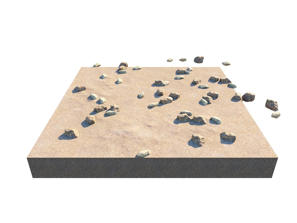

Random Translation
Moves the instances From the given distance To the given distance on the corresponding axis. See the Random Translation Example below.
Step Size – Specifies the random step size.
Example: Random Translation
This example shows how instances are moving along the corresponding axis.
01_RandomTranslation_X0-0_Y0-0_Z0-0
X = 0-0; Y = 0-0; Z = 0-0
02_RandomTranslation_X0-25_Y0-0_Z0-0
X = 0-25; Y = 0-0; Z = 0-0

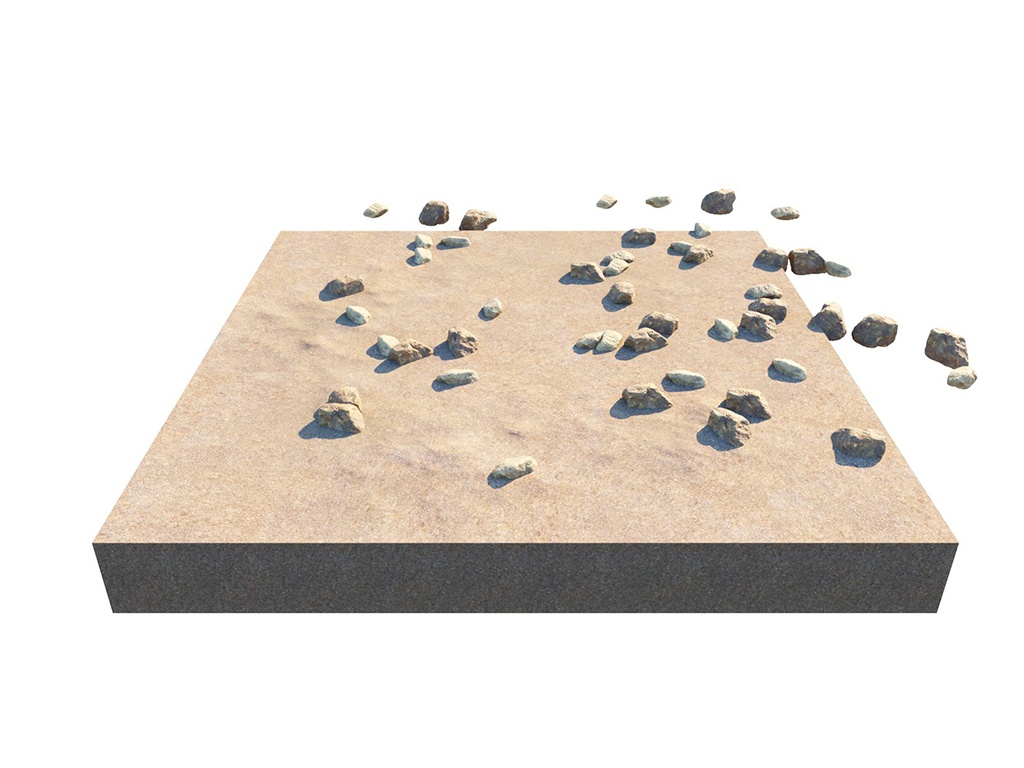

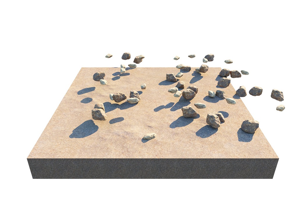

05_RandomTranslation_X0-100_Y0-100_Z0-0
X = 0-100; Y = 0-100; Z = 0-0
06_RandomTranslation_X50-100_Y50-100_Z0-0
X = 50-100; Y = 50-100; Z = 0-0

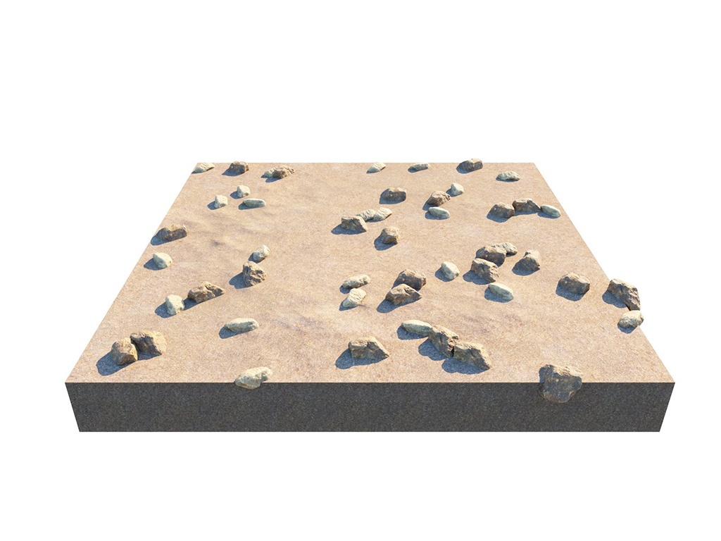

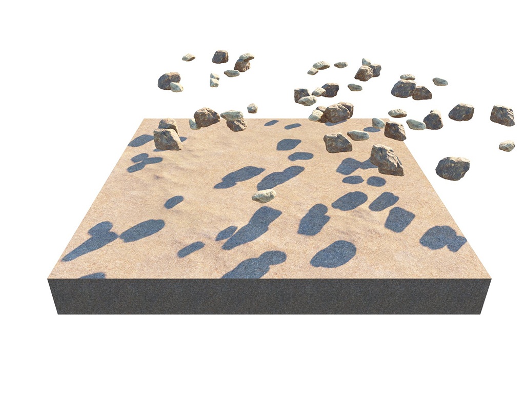

09_RandomTranslation_X50-100_Y50-100_Z0-25
X = 50-100; Y = 50-100; Z = 0-25
10_RandomTranslation_X50-100_Y50-100_Z0-100
X = 50-100; Y = 50-100; Z = 0-100
11_RandomTranslation_X50-100_Y50-100_Z50-100
X = 50-100; Y = 50-100; Z = 50-100

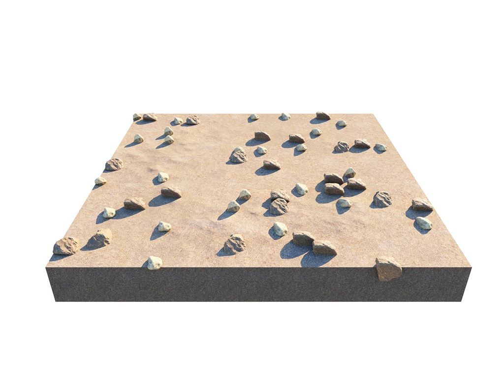

12_RandomTranslation_X0-100_Y0-100_Z0-0_StepSize0
X = 0-100; Y = 0-100; Z = 0-0; StepSize = 0
14_RandomTranslation_X0-100_Y0-100_Z0-0_StepSize50
X = 0-100; Y = 0-100; Z = 0-0; StepSize = 50
