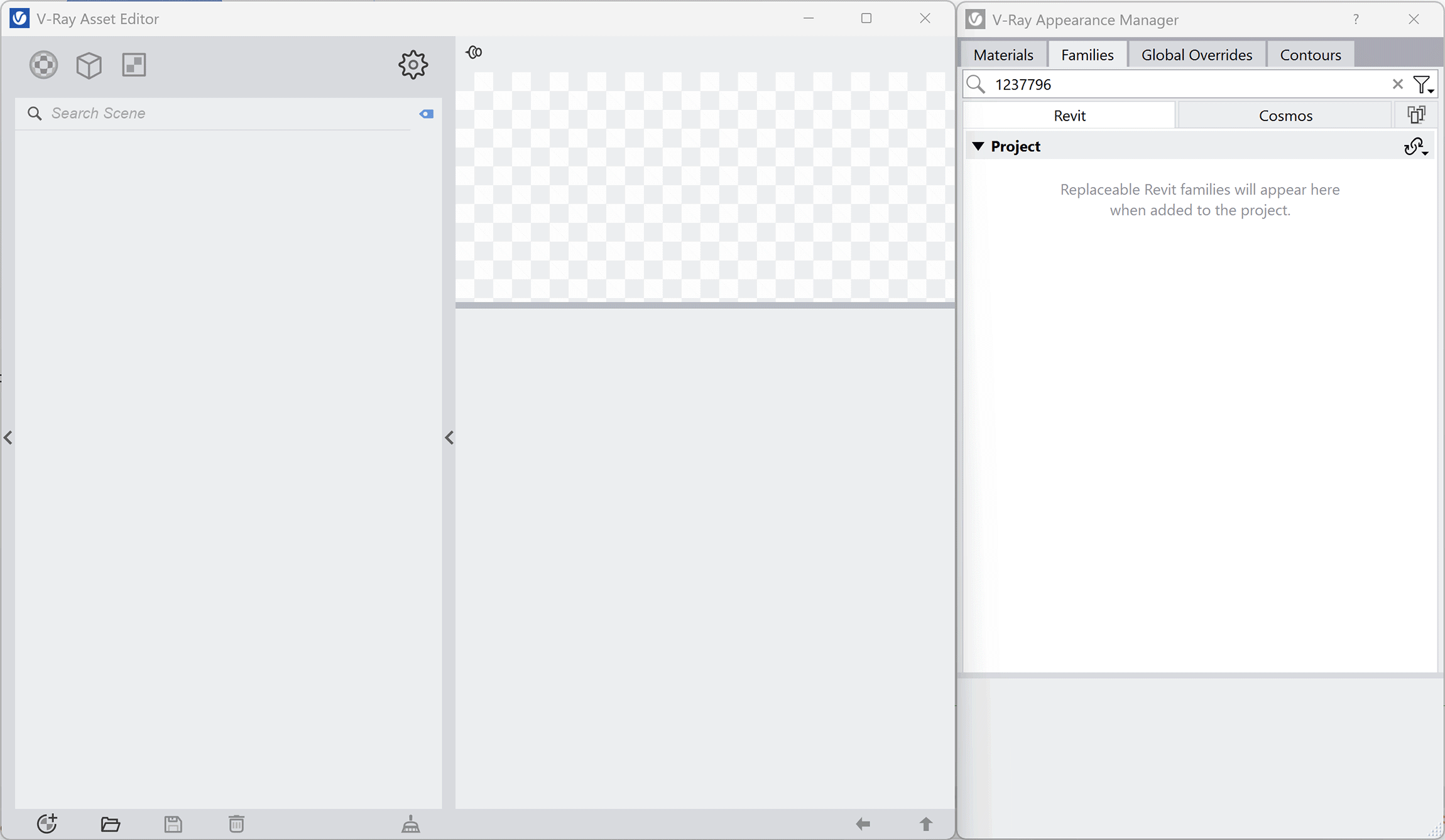

Creating Scatter:
||V-Ray Asset Editor|| > Geometries (right-click) > Scatter
||V-Ray Asset Editor|| > Create Asset (left-click) > Geometries Scatter
Assigning Scatter:
||Appearance Manager|| > Families tab > Scatter subtab > Add Scatter Host button (left-click)
||Appearance Manager|| > Families tab > Scatter subtab > Add Scatter Host button (right-click) > Pick Face

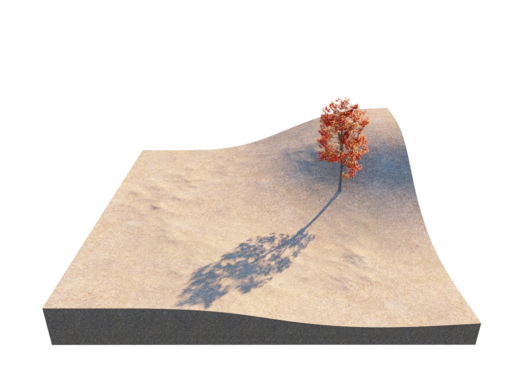

V-Ray Scatter consists of two types of objects – Host objects, and Guest objects that are scattered over the Host object's surface. There are several ways to create Scatter Host and Guest objects.
Creating Scatter Host Objects
Select an object in the viewport. Go to Appearance Manager > Families tab > Scatter subtab > Add Scatter Host button (left-click) > Pick Face.
To remove the Scatter from an object, use the Delete keyboard button.
Creating Scatter Guest Objects

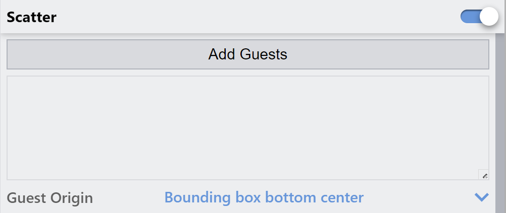

Add Guests – Select an object in the viewport and use the Add Guests button in the Asset Editor. The object appears under the Add Guests button.
When Fur or Displacement geometry is part of a Scatter guest, it is ignored for both the added guest instance and its scattered instances.
If a Revit family which has been added as a Scatter Guest is deleted from the model, it is also deleted from the Scatter Guests List.

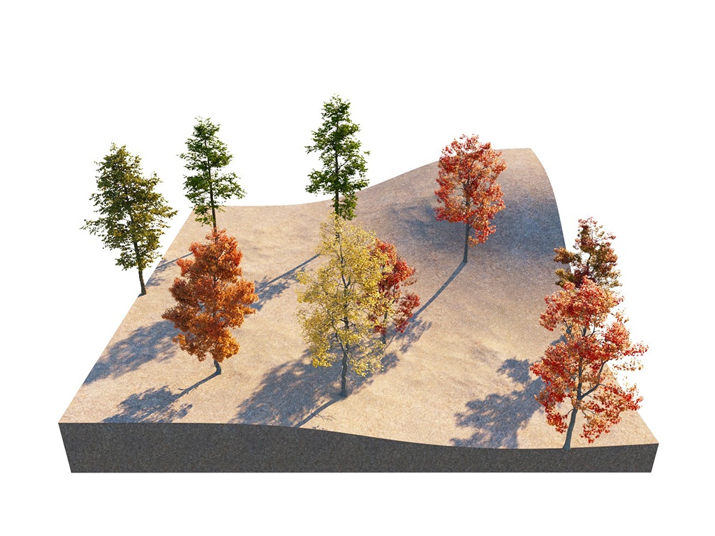

Scatter
Scatter – Enables Scatter.
Add Guests – Adds the currently selected scene objects to the Guests list. The objects in this list are scattered on the base geometry.
Guest Origin – Determines how the objects are positioned relative to the random Scatter points.
Bounding box bottom center – The bounding box bottom center of the object.
Bounding box volume center – The bounding box volume center snaps to the instance.
Object origin – The original object origin point snaps to the instance point.

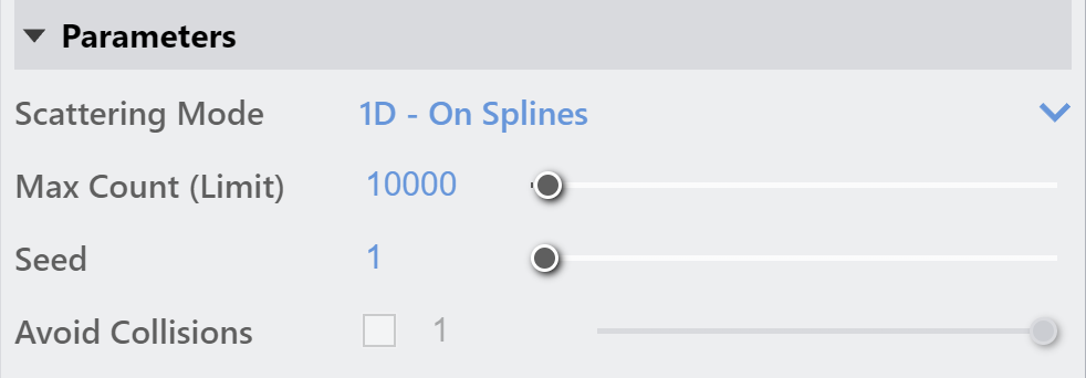

Scattering Mode – Specifies the guest objects scattering mode.
1D - On Splines – Objects are scattered along splines. When a mesh is added to the guests' list, the items are scattered along all mesh edges.
2D - On Surfaces – Objects are scattered on surfaces. It doesn't matter if the surface is horizontal, vertical, or if it is a complex 3D object
3D - In a Bounding Box – Objects are scattered inside the object's bounding box. Keep in mind that bounding boxes are cube-shaped. Using this mode on a round object, scatters instances in a cube around it.
Max Count (Limit) – Limits the maximum number of instances. See the Max Count (Limit) example below.

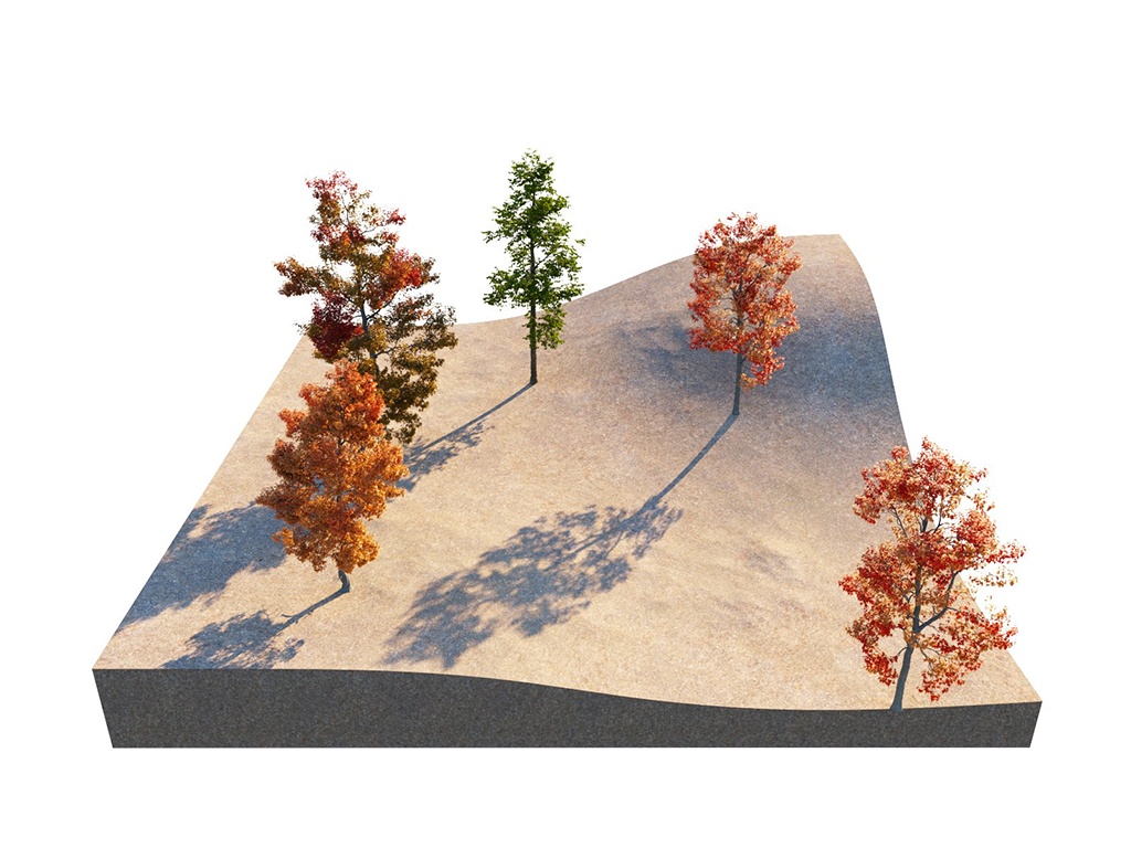

Seed – Controls the random Scatter seed.
01_Scatter_Seed_1
Seed = 1

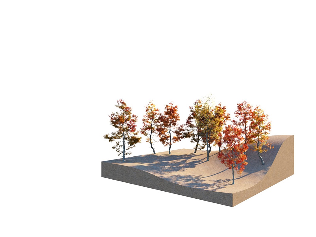

02_Scatter_Seed_2
Seed = 2

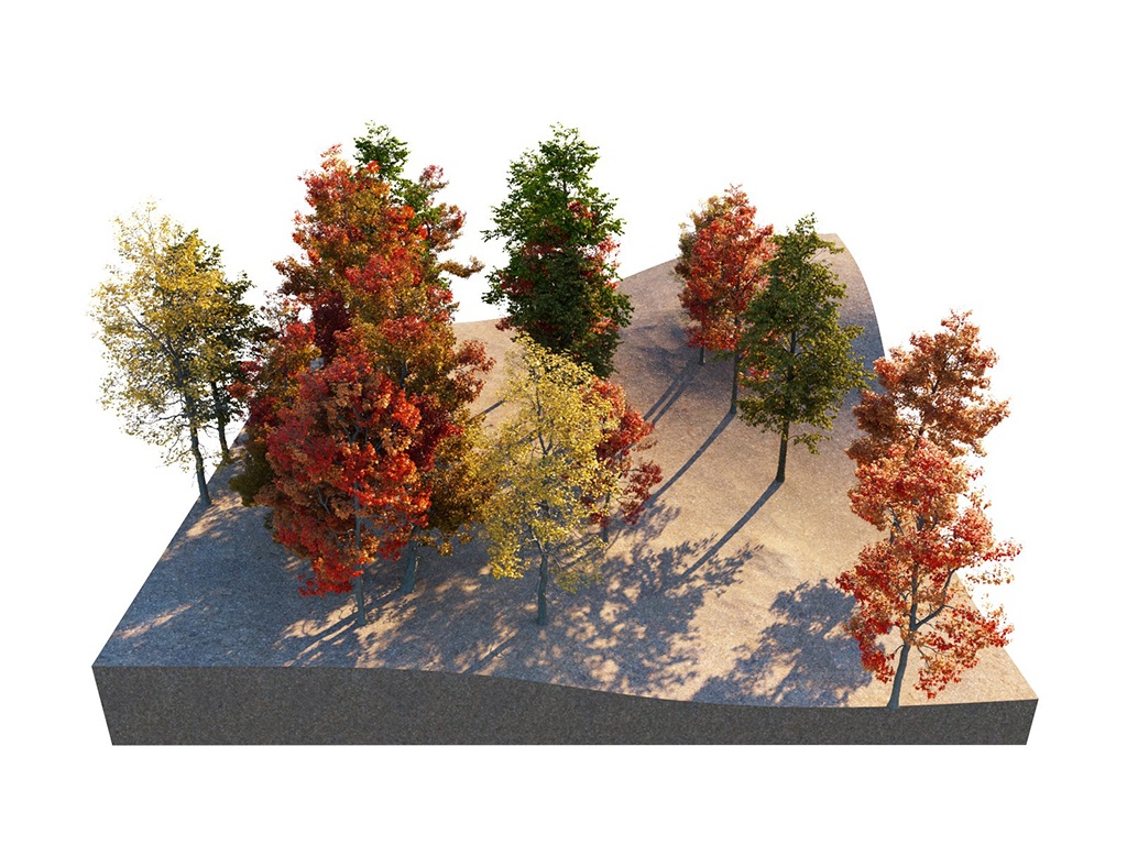

03_Scatter_Seed_3
Seed = 3
Avoid Collisions – When enabled, instances colliding with each other get discarded. See the Avoid Collisions example below.

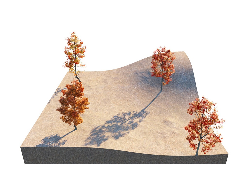

Max Count (Limit) is a limit to help avoid creating too many instances and overloading the system. This option has no effect if the Instance Count value is lower than the Max Count value. Depending on the hardware, this limit can be adjusted to ensure smooth performance and avoid excessive memory consumption. At Instances Count - 100, the scattered objects do not exceed the Max Count (Limit) - 50 and the render is the same as when the Instances Count is 50. Scattering Mode = 2D On Surfaces; Max Count (Limit) = 50.
02_MaxCount_50_InstancesCount_5
Instances Count = 5

Scatter treats multiple host objects as one with combined surface area (or volume). If you set Scatter to produce 100 instances of a guest object over two host objects, it does not produce 100 for each host. Instead, it produces 100 randomly distributed instances over both host objects' combined surface area (or volume).
