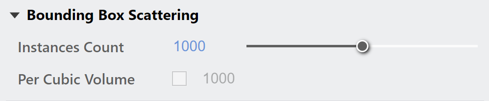

This submenu is only available when the scattering mode is set to 3D - In a Bounding Box.
Instances Count – Gives the total number of instances on all Host objects. Note that adding Area Modifiers or defining Slope Limitation will decrease this number. If the Per Cubic Volume option is enabled, the scattering is defined by the density. See the Instances Count example below.
Per Cubic Volume – When enabled, the number of instances is determined by the count combined with the size of the host's bounding box volume. The value specifies the length of the distribution cube's side/edge. If the Count value is set to 1, this number determines the relative density of the instances. See the Per Cubic Volume example below.

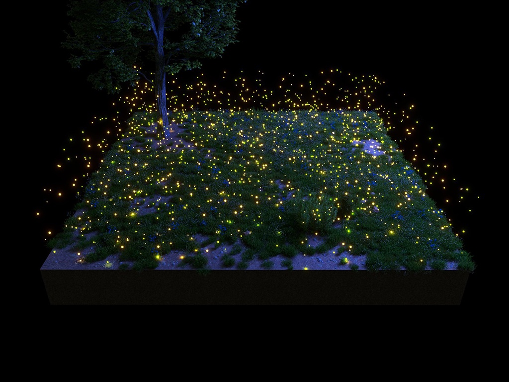

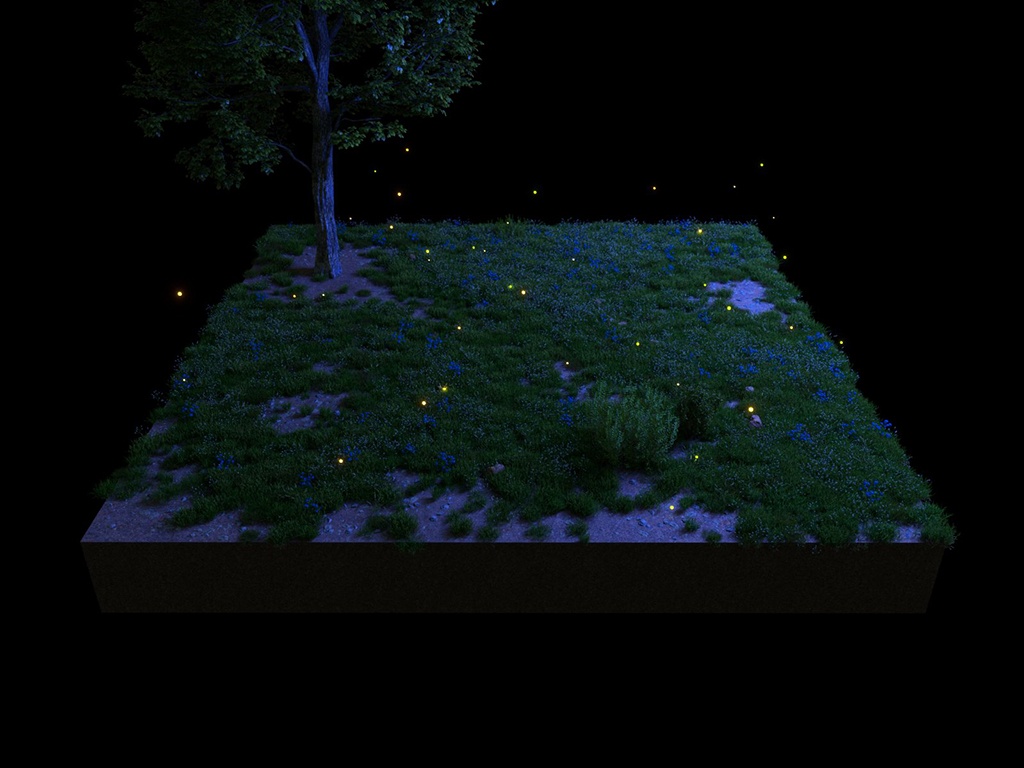

01_Scatter_BBoxScattering_InstancesCount_40
Instances Count = 40
04_Scatter_BBoxScattering_InstancesCount_5000
Instances Count = 5000
