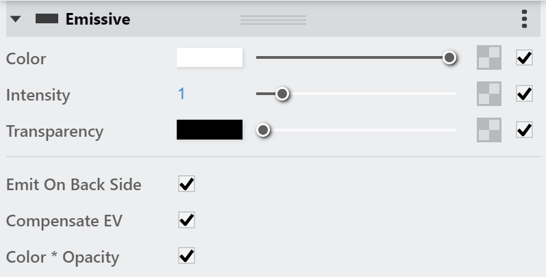

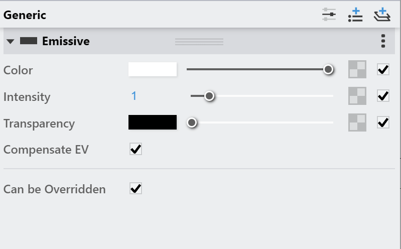

Emissive
Some options are available only in Advanced mode.
Color – Specifies the color of the light. A texture can be specified as well. See the Color and Texture examples below for more information.
Intensity – Controls the strength of the light.
Transparency – Specifies the color that is transparent. For this parameter black stands for opaque and white for transparent color. A texture can be specified as well. See the Transparency Texture example below for more information.
Emit On Back Side – When enabled, the object emits light from its back side as well. When disabled, only the front side emits light, and the material renders as black on the back sides. See the Emit On Back Side examples below for more information.
Compensate EV – Used when rendering with the V-Ray Physical Camera. When enabled, the intensity of the material is adjusted to compensate for the camera exposure.
Color *Opacity – When enabled, the color of the light material is multiplied by the opacity texture. Otherwise, the color and opacity act independently (so-called additive transparency).

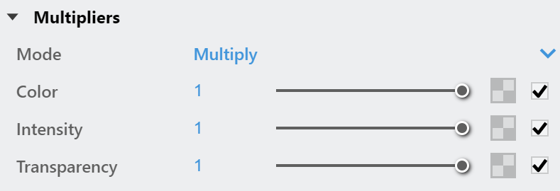

Multipliers
This rollout is available only in Advanced mode.
Mode – Specifies one of the following methods for adjusting textures.
Multiply – Multipliers can be specified to adjust colors and textures.
Blend Amount – Blend amounts can be specified to adjust colors and textures.
Color – Controls the intensity of the Emissive Color (light color).
Transparency – Controls the intensity of the Transparency Color, which determines the color that is transparent.

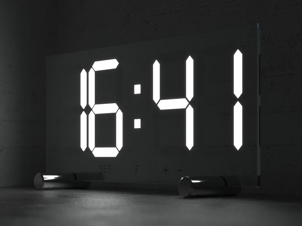

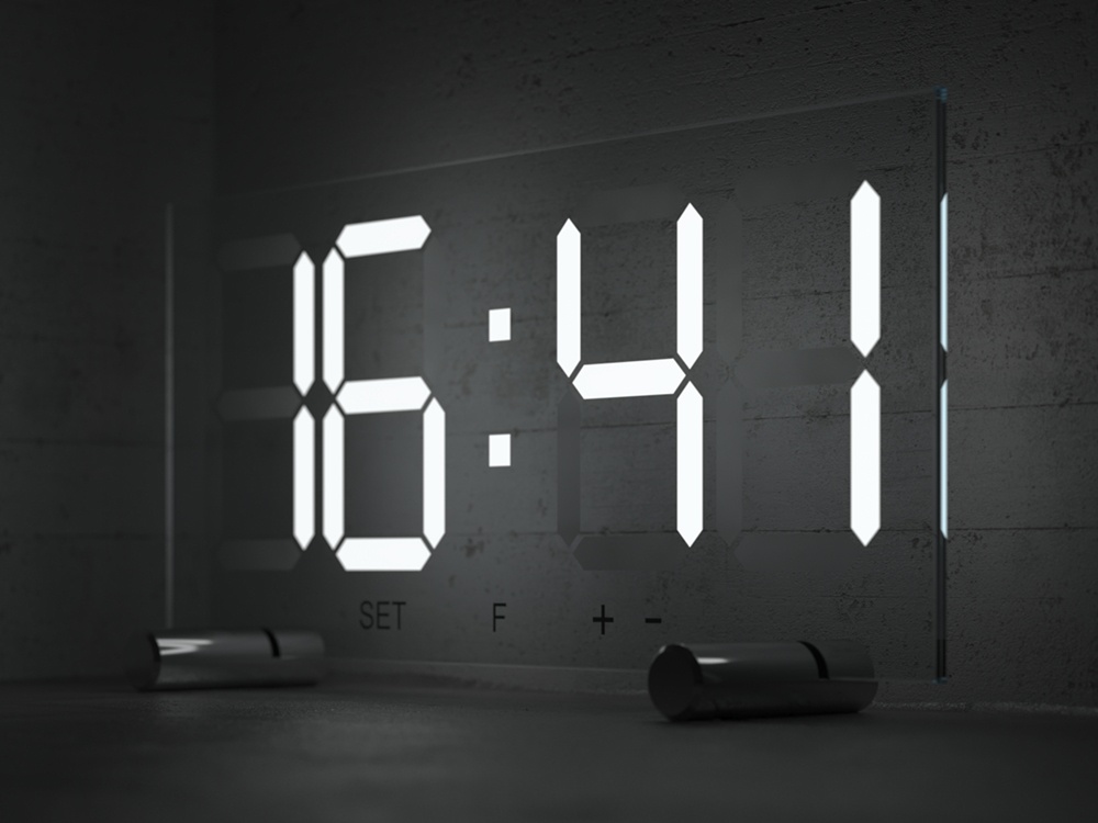

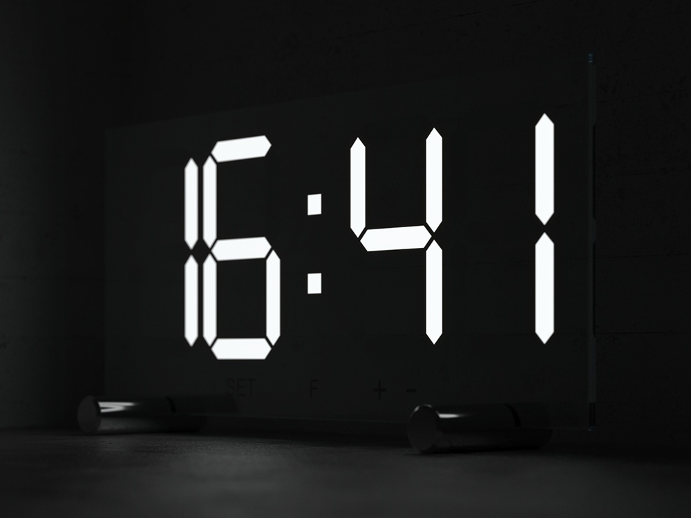

Example: Color and Texture, Intensity, Emit On Back Side
Here are some examples showing the difference in Intensity, the Emit On Back Side turned on and off and using an image in the Color Texture slot.
Intensity: 1
Color: White
Emit On Back Side: Off
Intensity: 5
Color: White
Intensity: 1
Color: White
Emit On Back Side: On
Intensity: 5
Color: White

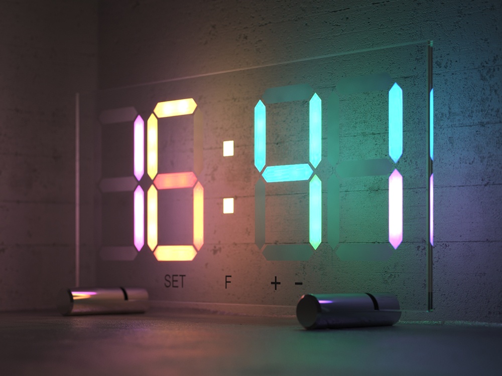

Intensity: 5
Image loaded in the Color Texture slot.
Emit On Back Side: on

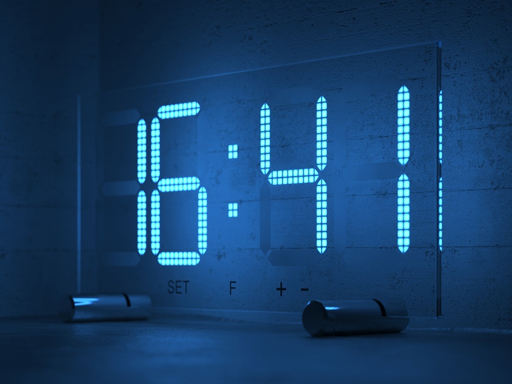

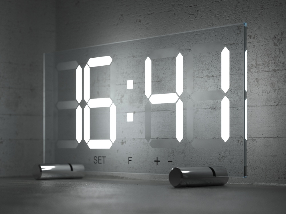

Transparency Texture On/Off
This example shows the usage of an image in the Transparency Texture slot. Both renders have the Emit On Back Side function turned on as well.
Off
On
Intensity: 10
Color: Blue
Override Control
Can be Overridden – When enabled, the material can be overridden when you enable the Opaque override option in the Global Overrides tab of Appearance Manager.
