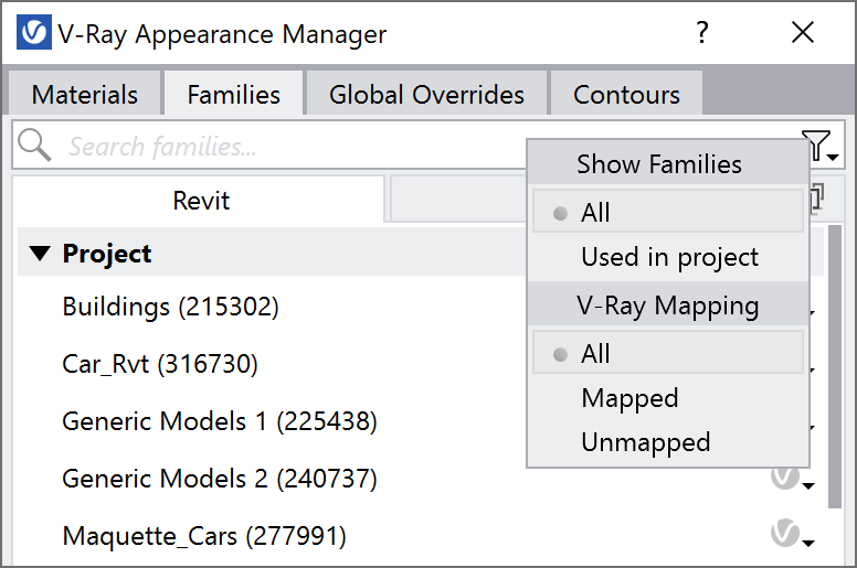

Search Bar and Filters
Show Families
Filters the list of objects based on the following options:
All – Shows all families that are currently loaded into the Revit project file.
Used in project – Shows all families that are already placed into the Revit model.
V-Ray Mapping
Applies a filter based on V-Ray replacements status.
All – Shows a list of all Revit families available for V-Ray replacement.
Mapped – Shows a list of all families which are currently replaced with any of the three V-Ray geometry types: Proxy Mesh, Proxy Scene or Cosmos 3D model.
Unmapped – Shows a list of all families which have not been replaced with a V-Ray geometry yet.
You can search either a specific family item name or a whole family category. Families can also be searched by name or element ID in the Filter search bar. Selecting one or more families in the Revit viewport activates the filter as well.
