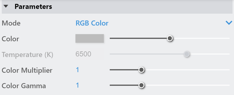

Mode – Specifies the mode in which the color is determined:
RGB Color – The color is directly specified by the Color parameter.
Temperature – The color temperature (in Kelvin) is specified by the Temperature parameter.
Color – This color swatch can be used to visualize the resulting color. It can also be double-clicked to bring up the Color Picker.
Temperature (K) – Specifies temperature in Kelvin degrees.
Color Multiplier – Specifies a multiplier for the color strength.
Color Gamma – Specifies a gamma correction applied during rendering. This does not affect the Color swatch.

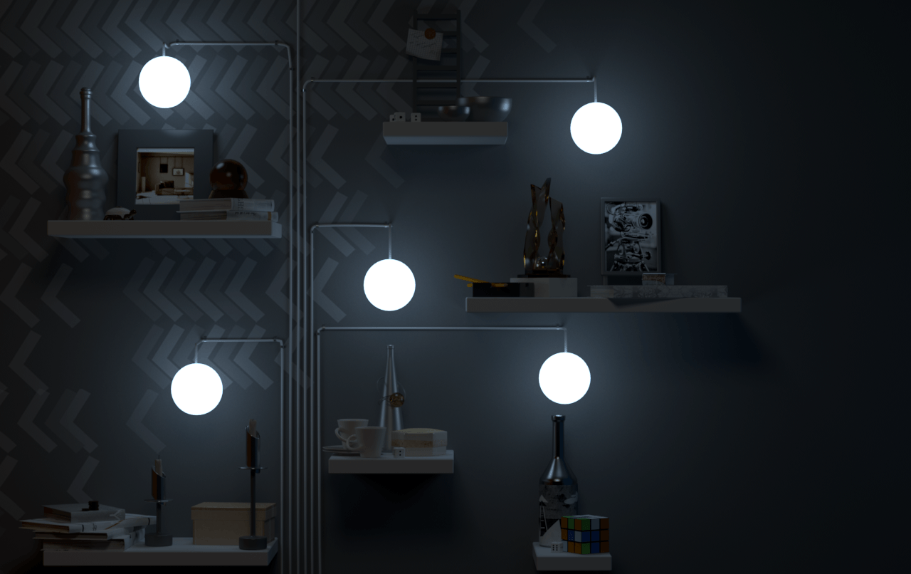

In each example below, the sphere lights have the same V-Ray Emissive Material applied to them. A Temperature texture map is applied to the Emissive Material to show various color temperatures between each example image. The Temperature texture has Color mode set to Temperature.
In the final image below, five separate Temperature texture maps were used, each with a different color temperature to show a variation. No other changes were made to the Emissive Material.
