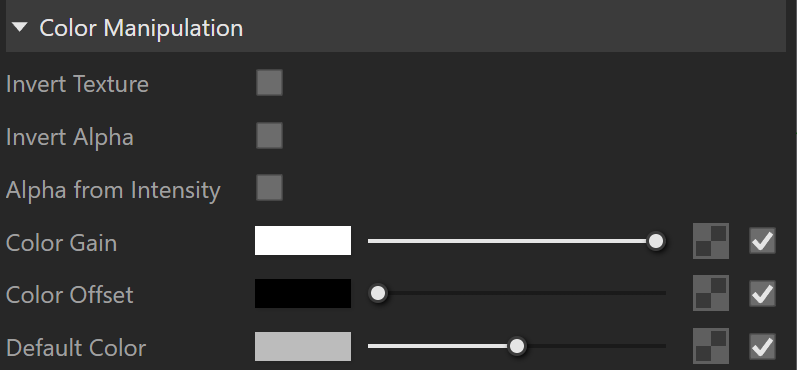

Color Manipulation
Invert Texture – Inverts the RGB texture values.
Invert Alpha – When enabled, inverts the bitmap alpha values.
Alpha from Intensity – Uses the texture RGB intensity/luminance as an alpha channel.
Color Gain – Corrects the color of the texture by multiplying the RGB color values in the texture with the RGB color values specified here. A texture map can be assigned here.
Color Offset – Corrects the color of the texture by adding the RGB color values specified here to the RGB color values of the texture. A texture map can be assigned here.
Default Color – Specifies a default color used for polygons with no valid UVs. In case the map is not tiled, specifies a default color that is used outside the texture square.  When a texture is selected, it overrides the color as long as the texture checkbox is enabled.

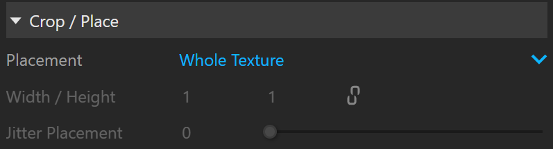

Crop/Place
These settings are available only when you switch to the Advanced mode.
Placement – Specifies the type of placement to be used.
Whole Texture – Uses the whole bitmap.
Crop – Uses a section of the bitmap.
Place – Adjusts of the position of the image.
Width/ Height  – Specifies the width/height of the bitmap. A value of 1 specifies the full width/height.
Jitter Placement – Specifies the amount of displacement to be applied in order to produce better anti-aliasing.
