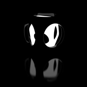

Color Multiplier: 1.0
Compensate Camera Exposure: off
GI: off
The image is dark except the inner cube (self-illuminated) and faint reflection on the ground. Notice there is no GI and no lights at all, so the darkness of the scene is expected.

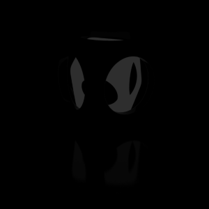

Compensate Camera Exposure: on
GI: off
Notice the inner cube and reflections appear brighter due to the exposure compensation. The rest of the image is still black because GI is disabled.

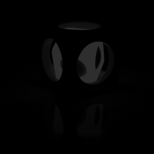

GI: on
With GI enabled, the outer cube and inner sphere become slightly visible. However, the image remains very dark.

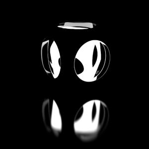

Color Multiplier: 50.0
GI: off
The inner cube and reflections are noticeably brighter. With GI disabled, the image remains in darkness.

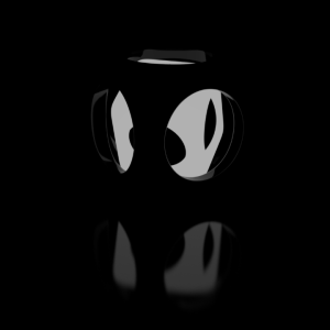

GI: off
By enabling Compensate Camera Exposure, the reflections become brighter with the current Color Multiplier value.

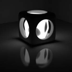

GI: on
With GI enabled, the scene receives more illumination with the current Color Multiplier value.
