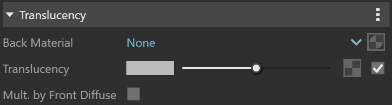

Translucency
Back Material– Defines the material V-Ray uses for back side faces as defined by their normals.
Translucency – Determines if the front or the back side of the material is more visible in the rendering process. By default this value is 0.5, which means that both sides are equally visible. When this parameter is closer to zero, the material facing the camera is more visible, when it is closer to one, the back material is more visible. A texture can be used to control the variation of the effect.
Mult. by Front Diffuse – When enabled, the translucency is multiplied by the diffuse of the front material.

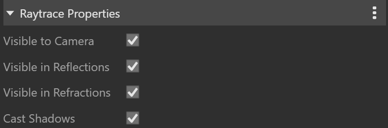

Raytrace Properties
Visible to Camera – When enabled, makes objects using this material visible to the camera.
Visible to Reflections – When enabled, this option makes objects using this material visible for to Reflection rays.
Visible to Refractions – When enabled, this option makes objects using this material visible for the Refraction rays.
Cast Shadows – When disabled, all objects with this material applied do not cast shadows.

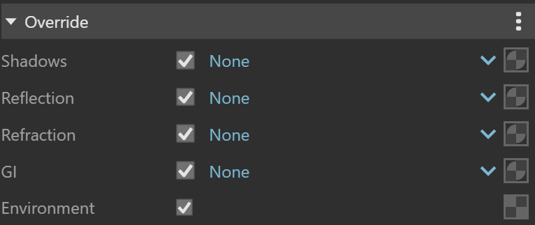

Override
Shadows – The material that is used when a shadow ray hits the surface.
Reflection – The material that is used when a reflection ray hits the surface.
Refraction– The material that is used when a refraction ray hits the surface.
GI – The material that is used when a GI ray hits the surface.
Environment – The texture that will be used instead of the scene environment maps.
