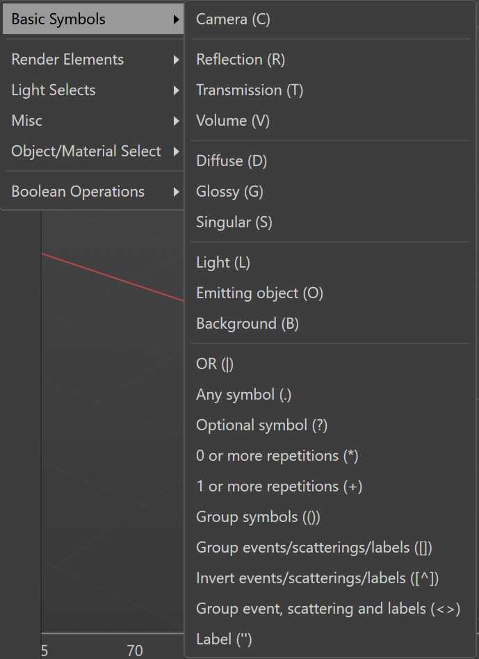

The right-click menu offers a list of all symbols in LPEs, as well as presets to get you started.

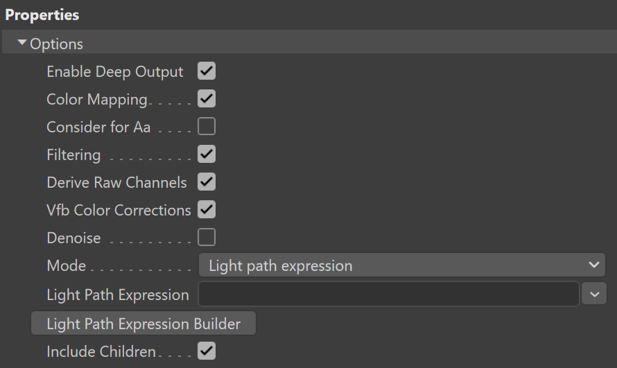

Тhere is a dedicated LPE Builder available to help you compose expressions and track exactly which ray paths they capture.
Scene Setup
The scene setup is similar to the Light Select workflow. As LPEs are a mode of the Light Select render element, the expression will capture contributions of the light(s) added to the Light Select set. If the Light Select is empty, the expression will capture contributions for all scene lights.

LPE Symbols
The LPE alphabet consists of the symbols representing a ray event/type and additional regular expression symbols (“.”, “+”, “*”, “<”, “>”, “[“, “]”, “|”, “?”, “^” and additional label strings).
A valid expression starts from the camera (C), captures ray spawn and scattering events and ends at light (L), emissive object (O) or the environment (B).
Ray spawn events other than C or V can be combined with scattering types (e.g. <RD> - capture only diffuse reflection) to get a more specific ray event or they can be used directly (e.g. R - capture reflections of any scattering type. This is also equivalent to <R.>)
Ray termination events can also be combined with each other when you want to capture the contribution of a light together with emissive objects, e.g. C<RD>.*[LO] will capture the GI coming from lights or emissive objects.
See a full list of LPE Symbols below:

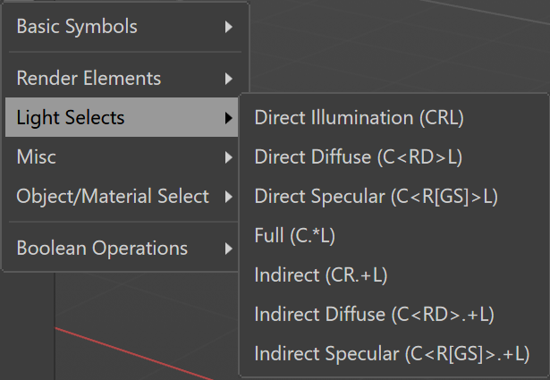

It will be faster and more efficient to use the already available render elements instead of their LPE equivalents in the presets, of course - the examples are there as a point of reference.
Preset
Light path expression
Light selects
Direct IlluminationCRL
Direct DiffuseC<RD>L
Direct SpecularC<R[GS]>L
FullC.*L
IndirectCR.+L
Indirect DiffuseC<RD>.+L
Indirect SpecularC<R[GS]>.+L

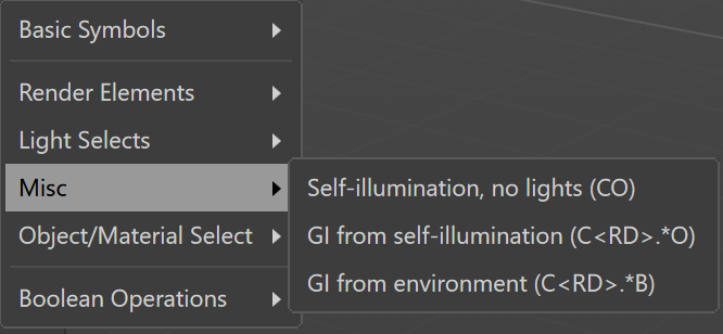

Misc
Self-illumination, no lights
CO
GI from self-illuminationC<RD>.*O
GI from environmentC<RD>.*B

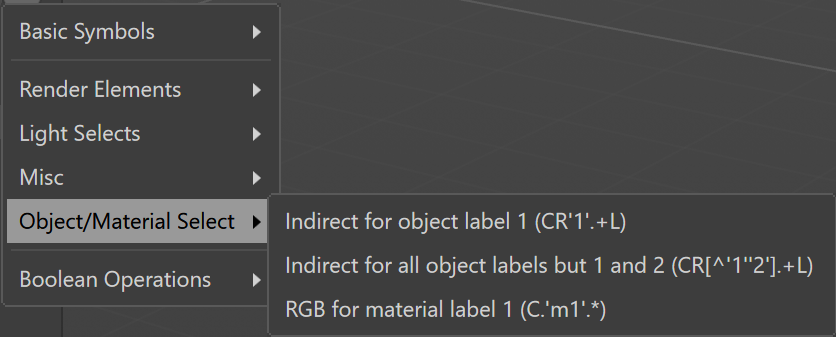

Object/Material select
Indirect for object label 1
CR'1'.+L
Indirect for all object labels but 1 and 2CR[^'1''2'].+L
RGB for material label 1C.'m1'.*
To use object labels, add V-Ray User Attributes to you object, where the attribute name is lpe_label and equals your custom label. For example, lpe_label=myLabel.
To use material labels, add Extra V-Ray Attributes > Light Path Expression Label to your material. When used in expressions, material labels require the m prefix.

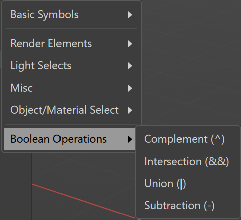

Boolean operations
Boolean operations allow us to combine expressions. We can complement (^), intersect (&) or unite (|) expressions, or we can subtract (-) one expression from another.
Boolean operations can also be very useful in a number of scenarios to simplify the compositing workflow.
