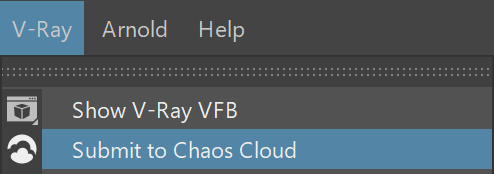

V-Ray for Maya provides in-built integration with Chaos Cloud, allowing you to submit render jobs to the cloud directly from Maya, using the dedicated Render in Chaos Cloud button. The button is located on the V-Ray Shelf and can also be found in the V-Ray Menu.
Clicking on the  button will open the Submit to Chaos Cloud window.
