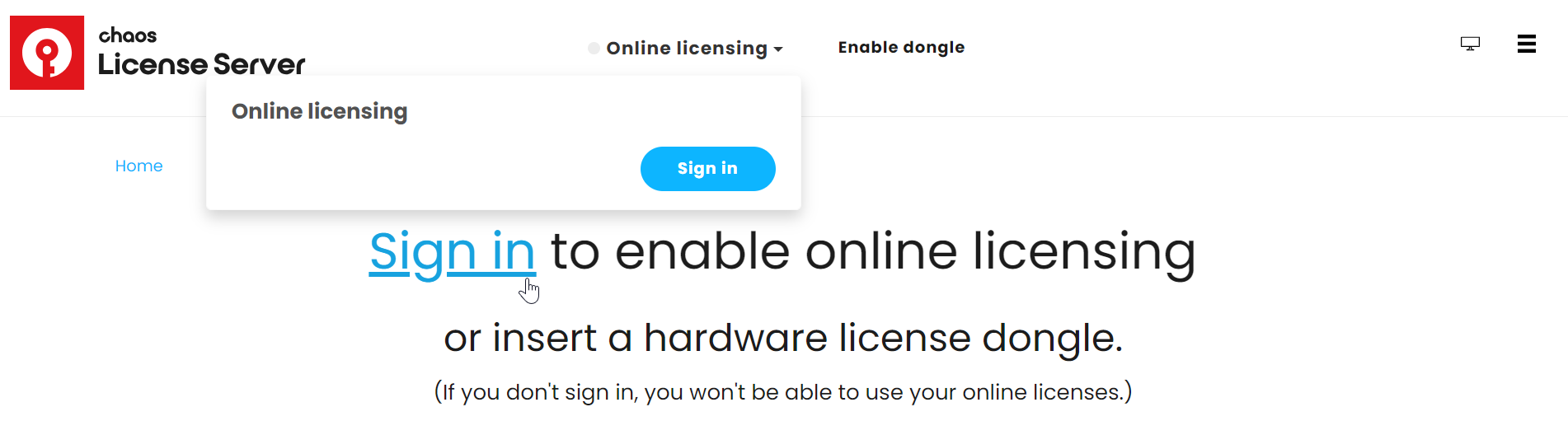

  • After the installation is complete, you will be redirected to the Chaos License Server's Interface. If you are not signed into a Chaos account, go to the Online licensing dropdown menu and select Sign in.
  • You are then prompted to enter your username/email and password.
  • Once the activation is successful, you will be able to see the list of your available licenses on the Chaos License Server home page.

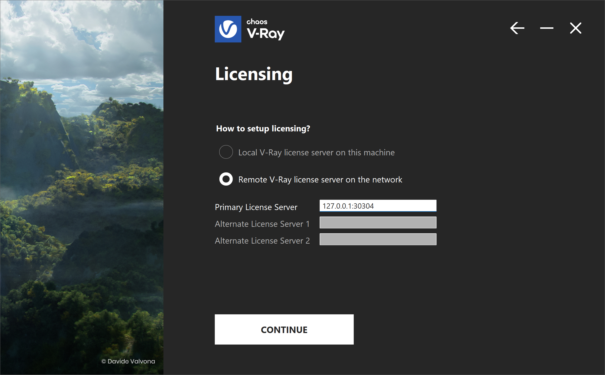

  • The administrator needs to give you their machine's IP address. This serves as your connection point to the Chaos License.
  • When installing your Chaos product, at the Licensing step, select Remote. In the Primary License Server field, type the server IP address that your license administrator gave you. At the end, add the :30304 port.
Example screenshot
  • Continue to finish the installation. You are connected to the active licenses after that.
