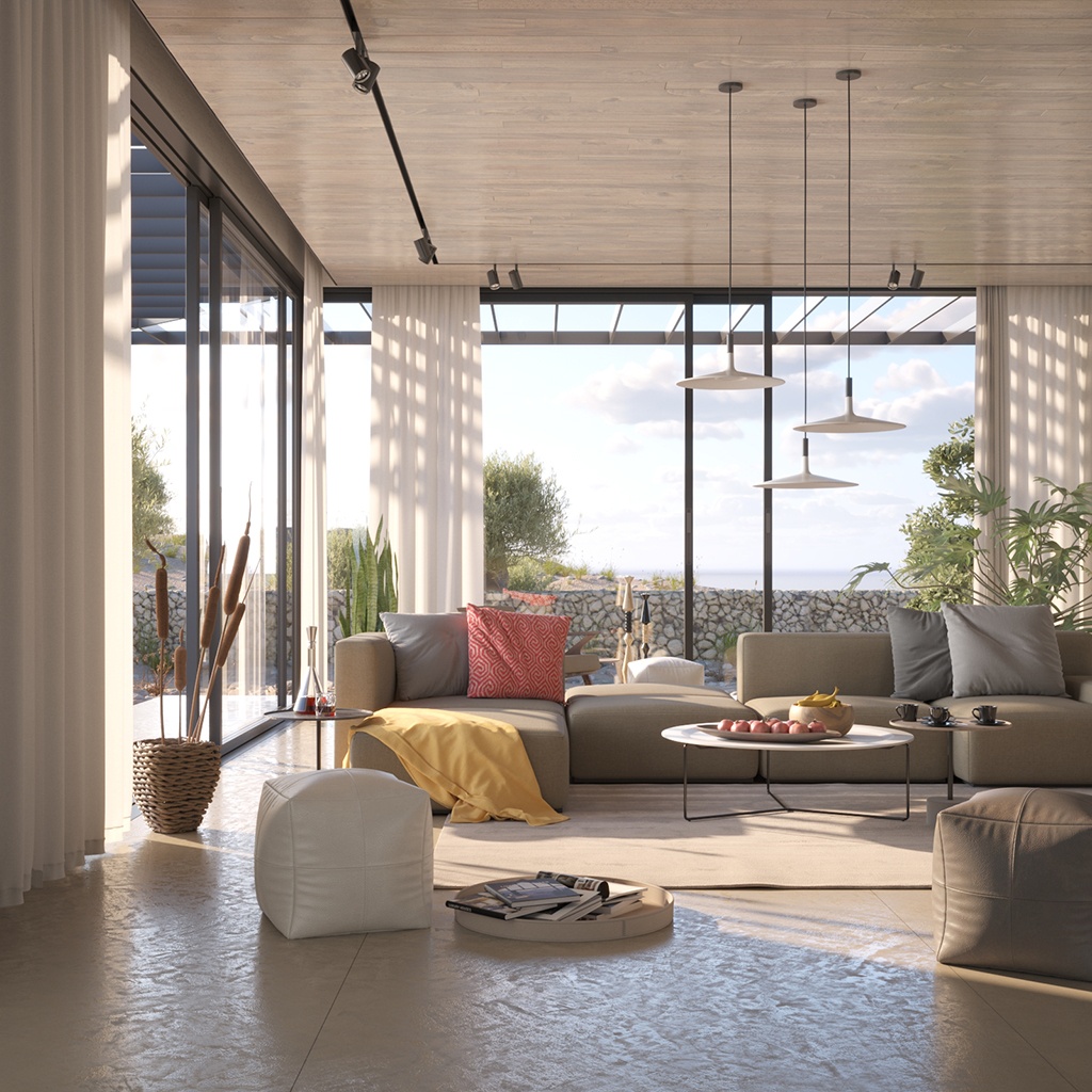

This render element is useful for making overall adjustments and enhancements to colors and textures during compositing.
Common Uses
The Diffuse Filter Render Element helps change the appearance of many passes when combined with Raw render passes (like Raw Global Illumination, Raw Lighting, etc.). In the example below, the Diffuse Filter is multiplied by the Raw Global Illumination Render Element to provide the Global Illumination element. In this way, color correction can be performed upon the raw pass without changing the actual diffuse colors, making it possible to tint a pass realistically without re-rendering.
The Diffuse Filter is a handy render element due to the number of raw passes with which it can be combined, giving the ability to manipulate many areas of the render at the composite level. The Diffuse Filter pass can also be color-corrected, as shown in the example below. In this case, a Multimatte Render Element was used in conjunction with the Diffuse Filter render element to isolate the dangling light and change its color from white to blue without also tinting its lighting or shadowing in any way.

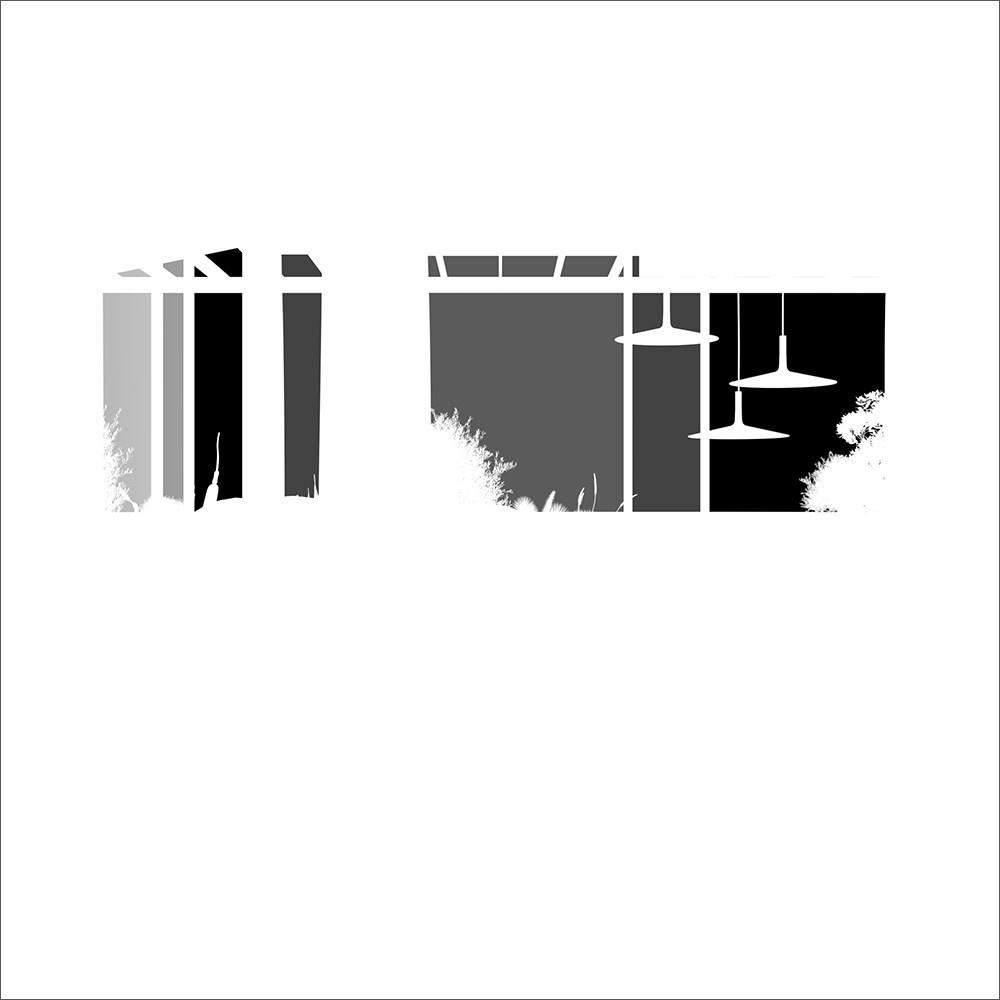

Alpha
Type: RenderChannelColor
The Alpha Render Element shows the transparency of objects in the scene as grayscale colors. Solid geometry is represented by solid white, while those areas not blocked by geometry within the scene are black. Pixels at antialiased edges have varying shades of gray, as do semi-transparent surfaces.
Common Uses
The Alpha Render Element is primarily used as a mask to enable other elements to be placed behind the Beauty composite, such as the Background Render Element. The Alpha Render Element shown below considers the glass's transparency in the windows, including the frosted glass made semi-transparent by a texture mask in the glass material.
Beauty composite with no background
New Beauty composite with the Background Render Element behind the original Beauty composite
When using transparent materials such as glass, make sure that the material is set up to treat the material as transparent with regard to the Alpha channel. For example, when using VRayMtl as the material, set the Affect channels parameter for Reflection (reflect_affect_alpha) and Refraction (refract_affect_alpha) to Color+alpha or All channels. Otherwise, the transparent surface will not be treated as transparent in the Alpha Render Element.

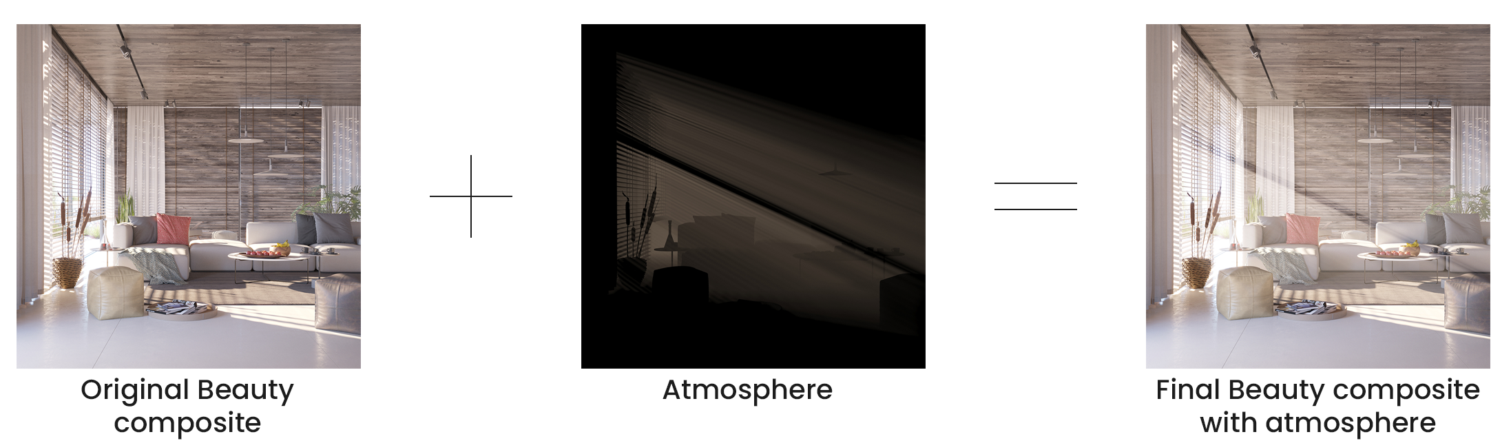

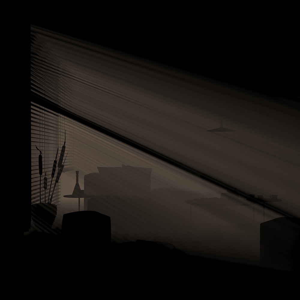

Atmosphere
The Atmosphere Render Element stores only atmospheric or volumetric participating media such as fog or Aerial Perspective. This render element can then be used to enhance or color-correct just the atmospheric component of the image during the compositing process.
When atmospheric effects or fog are included in a scene, they render into the Beauty|RGB channel and should also be output as the Atmosphere channel for compositing use.
The Atmosphere Render Element is useful for changing the appearance of the atmosphere and volumetric effects in a rendered image using compositing or image editing software. Below is an example of its use.
Atmosphere Render Element, with fog generated by VRayEnvironmentFog
Original Beauty Composite
Color of atmosphere changed and intensity increased
The Atmosphere Render Element is added to the Beauty render to form the final image.

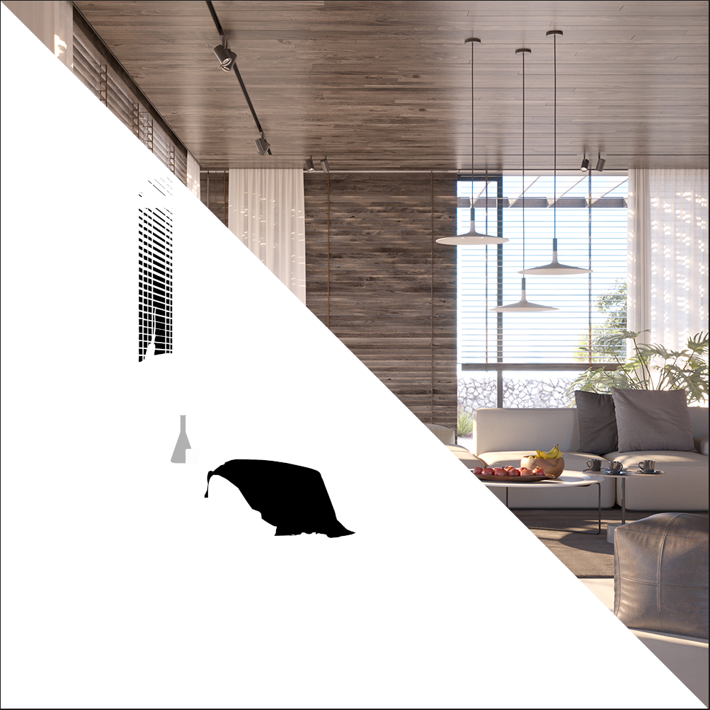

Background
The Background Render Element stores an image of the texture used in the background behind geometry in a scene as seen from the camera. Geometry that blocks the background image renders as black.
This render element interprets a background texture, such as the texture set in the Environment settings, as the background; other types of manually created backgrounds, such as a plane mapped with a texture set outside a window, is not interpreted to be the "background" for this render element.
The Background Render Element is primarily used for layering the Beauty element (or combined render elements) on top of the background image. The Alpha Render Element can be used to create a matte for such a composite.
Beauty Render Element without Background Render Element
When the background is behind a transparent or semi-transparent material such as glass or clear plastic, make sure the Alpha channel is enabled for the material for all render elements; otherwise, the background is not visible in the render element. For example, when using VRayMtl for a glass material, set the Affect channels parameter for both Reflection and Refraction to All channels to cause the background to appear in the Background Render Element behind the glass.

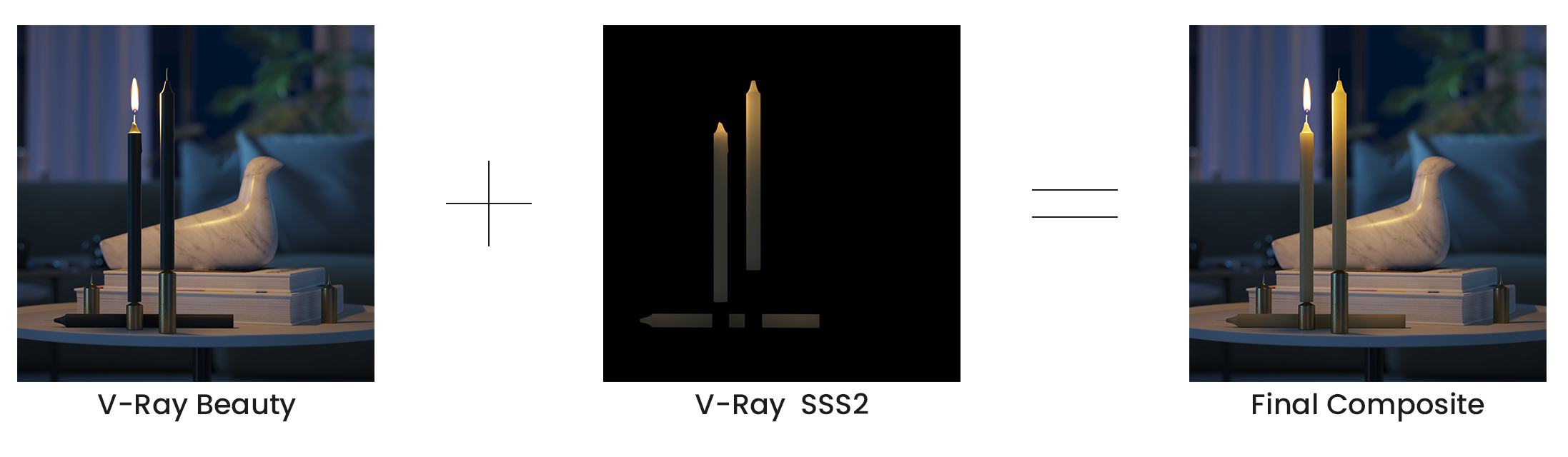

Subsurface Scattering
The Subsurface Scattering Render Element stores subsurface information from VRaySSS2 materials as an image. This render element can then be used to enhance or color-correct just the subsurface scattering component of the image during the compositing process.
The Subsurface Scattering Render Element is useful for changing the appearance of SSS2 elements after rendering in a compositing or image editing software. Below is an example of its use.
Color of Subsurface Scattering on the candles changed
The Subsurface Scattering Render Element is added to the Beauty render to form the final image.

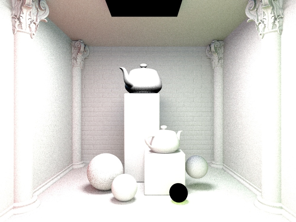

Global Illumination is the indirect lighting bouncing around within a scene to contribute to the overall illumination, as opposed to direct lighting from a light source. This page overviews the two global illumination render elements that may be created through V-Ray and how they are used in compositing. Specific usage for each of these global illumination elements is explained in the Overview.
GI
Raw GI
The Global Illumination Render Elements store indirect lighting information calculated in the scene. The following passes may be generated:
  • Global Illumination Render Element (VRayGlobalIllumination) - Stores the diffuse surface global illumination in a scene when Indirect Illumination is enabled. This pass is already attenuated by the diffuse contribution in the scene and can be used directly in the composite.
  • Raw Global Illumination Render Element (VRayRawGlobalIlumination) - Stores the raw information for the indirect lighting information calculated in the scene, untouched by the diffuse contribution. This pass is used to fine-tune the GI in a scene before attenuating it with the diffuse contributions of the scene.

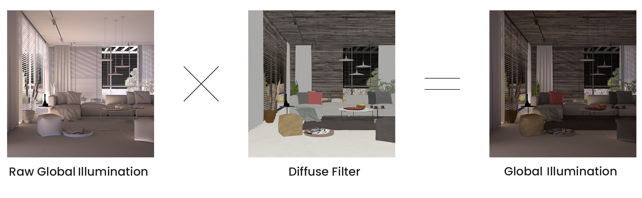

The Global Illumination Render Element (VRayGlobalIllumination) can be used in Back to Beauty compositing to add the GI lighting contribution to the scene. The GI contribution may be adjusted (tinted, brightened, darkened, etc.) in the composite without re-rendering the scene.
When even more control over the GI contribution to the final image is desired, this main Global Illumination Render Element can be re-created by multiplying the Raw Global Illumination Render Element with the Diffuse Filter Render Element:
Raw Global Illumination x Diffuse Filter = Global Illumination
Examples
When Raw Global Illumination is needed in the composite, please also render the Global Illumination element (VRayGlobalIllumination) and the Raw GI element (VRayRawGlobalIlumination).
The Global Illumination Render Element is useful for changing the appearance of indirect lighting after rendering in a compositing or image editing software. Below are a couple of examples of its use.

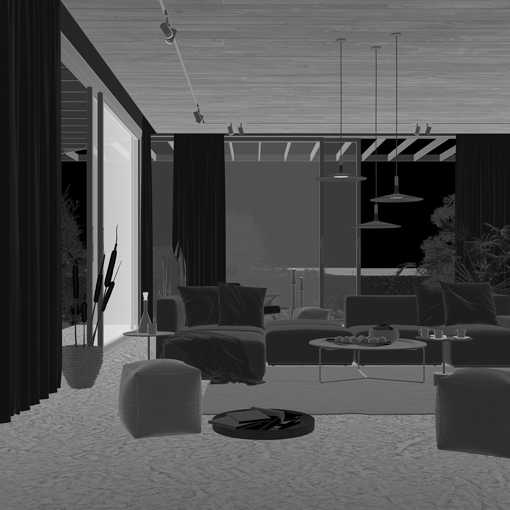

The Raw Global Illumination Render Element stores how much indirect lighting (reflected diffuse light) is received by surfaces in the scene. This raw element is useful for fine-tuning indirect lighting in the compositing process.
The Raw Global Illumination Render Element is untouched by the diffuse colors of the scene and represents the pure indirect lighting contribution. You can use this raw element to reconstitute the Global Illumination by multiplying the Raw Global Illumination with the Diffuse Filter.
For proper results, this raw render element must be rendered along with the Global Illumination element (VRayGlobalIllumination).
Once the scene is rendered, the Raw Global Illumination Render Element is useful for changing the appearance of indirect lighting in a compositing or image editing application. Below are examples of its use.

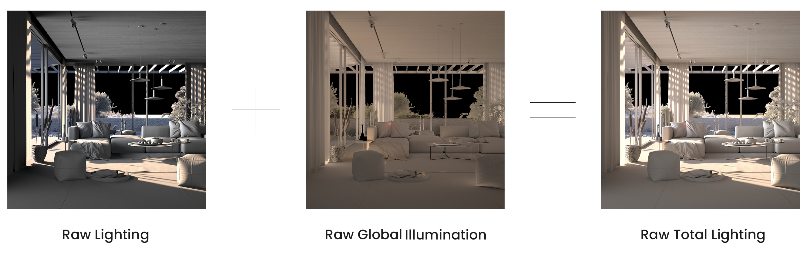

  • Raw Lighting (VRayRawLighting) – Stores the effects of direct lighting on scene objects without the diffuse contribution.

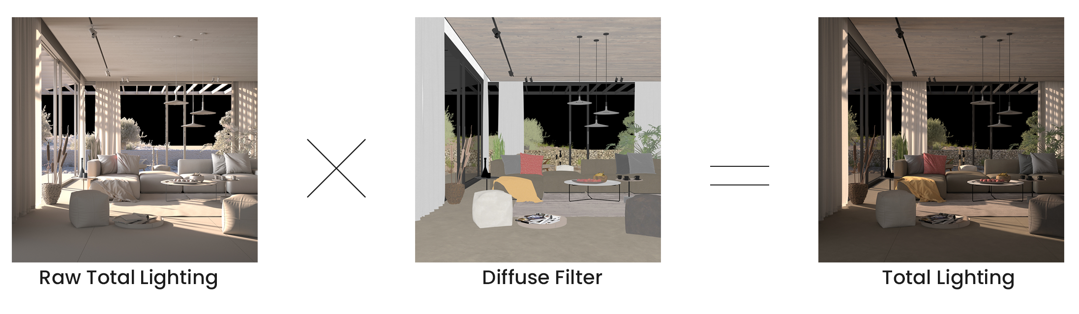

  • Total Lighting (VRayTotalLighting) – Stores the effects of both direct and indirect lighting on materials in the scene, including the diffuse contribution.
  • Raw Total Lighting (VRayRawTotalLighting) – Stores the sum of both direct and indirect lighting in the scene without the diffuse contribution.

Raw Lighting
 Total Lighting
Raw Total Lighting

Raw Lighting x Diffuse Filter = Lighting

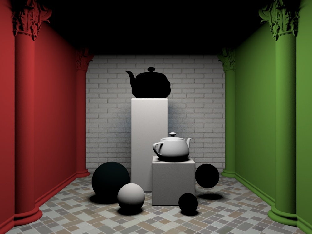

Shadow Select
The Light Select Render Element (RenderChannelLightSelect::light_select_mode) represents the lighting contribution from one or more user-selected lights in the scene. The shadow modes (Direct diffuse shadow and Direct specular shadow) render a color image that works as a reverse mask for shadows caused by a specific light(s). It can lighten, darken, or tint the shadows in post-production.
The Direct Diffuse Shadows channel outputs only the shadows cast by objects illuminated by pre-selected lights. This option has the same output as the Shadow render element. Works with all V-Ray materials that have diffuse (which excludes Stochastic Flakes and V-Ray Flakes 2). V-Ray Toon material is not supported.
The Direct Specular Shadows channel outputs the specular information from the shadows cast by objects illuminated by a pre-selected light. The objects that the shadows are cast on must have reflective material for this channel to be visible. It works with all V-Ray materials that have reflection and glossiness values less than 1.
The Matte Objects Only option (light_select_matte) renders object shadows generated by a predetermined light source onto a matte surface (object with matte properties assigned). It is available for the Direct diffuse shadow Type only. It can add 3D elements to the composite's background image or footage.

Total Lighting
The Total Lighting Render Element is a color image that includes the effects of both direct and indirect lighting on materials in the scene, including the diffuse component. It results from adding the Lighting and Global Illumination render elements or multiplying the Raw Total Lighting and Diffuse Filter render elements.
The Total Lighting Render Element is useful for brightening or dimming all lighting during compositing. Below are a couple of examples of its use.
Brightened Lights
Tinted Lights
Raw Total Lighting x Diffuse Filter = Total Lighting
Raw Total Lighting
The Raw Total Lighting Render Element is the sum of all raw lighting (both direct and indirect) in the scene, without any diffuse details. This render element is useful for changing the appearance of the scene's lighting in a compositing or image editing application.
The Raw Total Lighting Render Element is useful for changing the appearance of the entire scene lighting after rendering, using a compositing or image editing application. Below are a couple of examples of possible uses. The first two images show the render element itself and the Beauty render put together. In the following examples, a Matte Render Element was used to isolate different parts of the scene. Then, the Raw Total Lighting Render Element was brightened and tinted differently to show the range of editing possible.
Brightened Lights with different brightening for the floor, wall, and ceiling
Tinted Lights with different tinting for the floor, wall, and ceiling
Raw Lighting + Raw Global Illumination = Raw Total Lighting

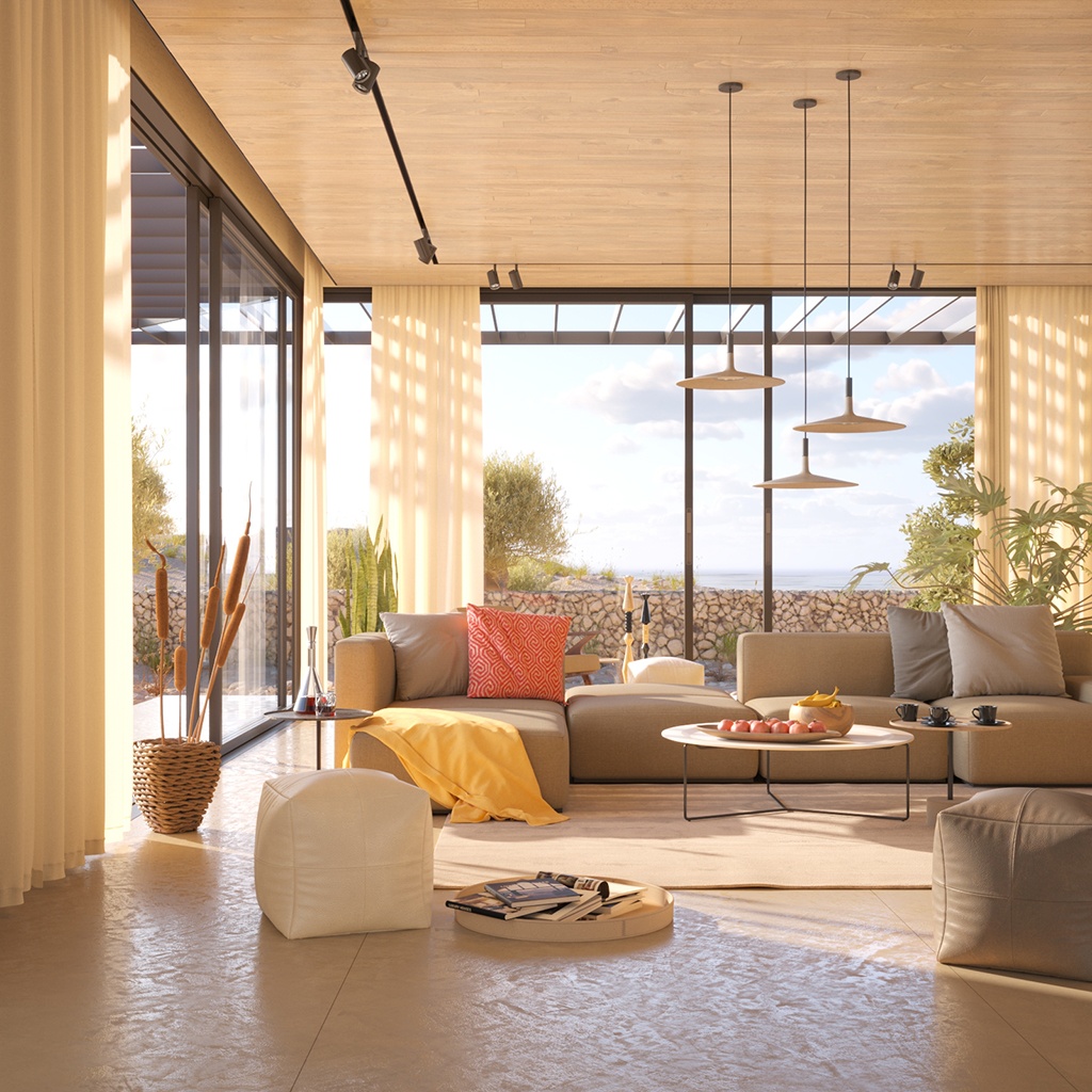

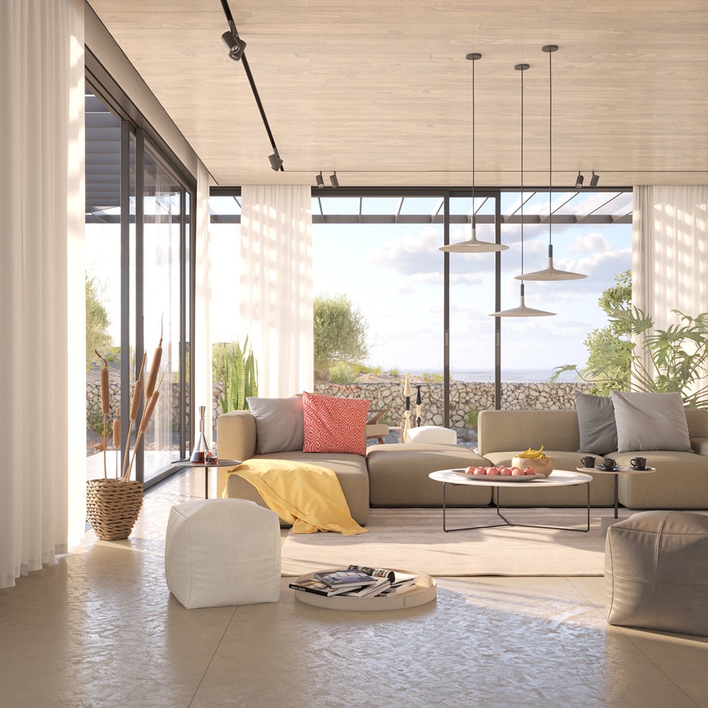

Reflection Render Element
Brightened Reflections
Tinted Reflections

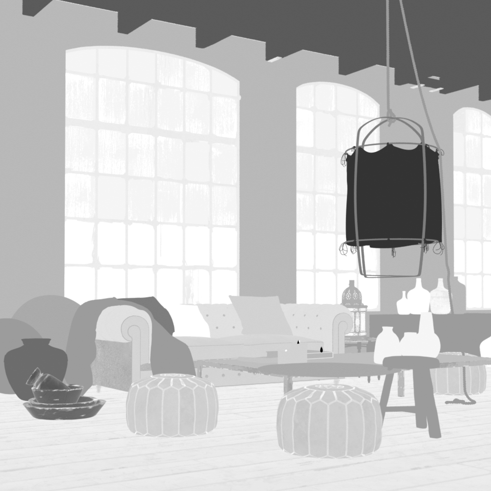

Reflection Glossiness
Type: RenderChannelGlossiness
The Reflection Glossiness Render Element stores the image's reflection glossiness as a grayscale image that represents the degree of Reflection Glossiness set for materials in the scene. White areas have the most reflection glossiness, while dark areas have little.
The amount of reflection glossiness for a material is set by its Reflection Glossiness parameter. For example, V-Ray Material (VRayMtl) has a Reflection Glossiness parameter.

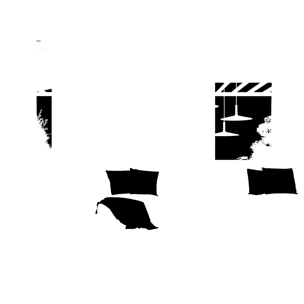

When a Matte Render Element is used, certain objects or materials within the scene can be isolated at a composite level, and the refractivity of these items can be changed without rerendering.

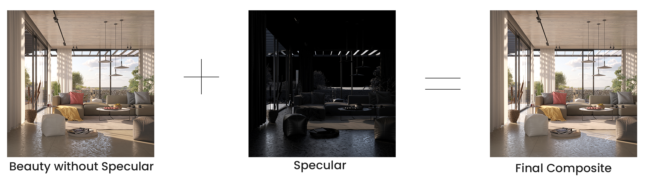

Underlying Compositing Formula
The Specular Render Element is added to the Beauty composite to form the final image.

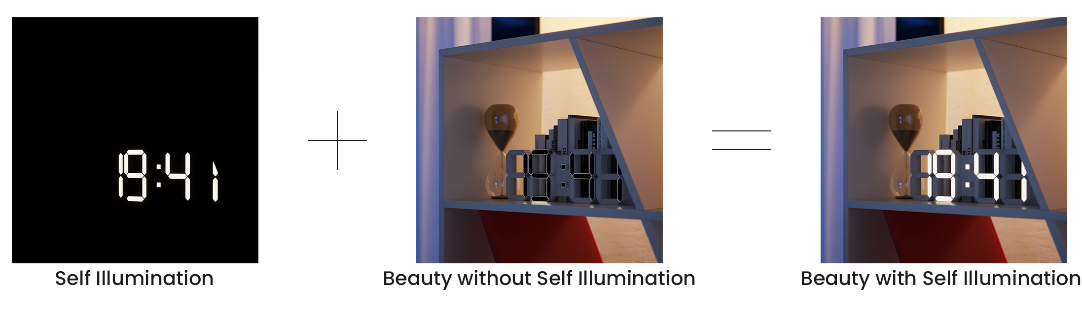

We'll leave the advanced Beauty render elements - Atmosphere, Background, Caustics, Self Illumination, and Subsurface Scattering for the next chapter.

	// Light from perfect mirror reflections
	reManager.add(RenderElement::SPECULAR, NULL, NULL);

	// Light from self-illuminating materials
	reManager.add(RenderElement::SELFILLUM, NULL, NULL);

	// Sum of all lighting
	reManager.add('total_light');
	// Shadows, combined with diffuse. Shadowed areas are brighter
	reManager.add('shadow');
	// Reflected light if surfaces were fully reflective
	reManager.add('raw_reflection');
	// Refracted light if surfaces were fully refractive
	reManager.add('raw_refraction');
	// Attenuation factor for reflections. Refl = ReflFilter * RawRefl
	reManager.add('reflection_filter');
	// Attenuation factor for refractions. Refr = RefrFilter * RawRefr
	reManager.add('refraction_filter');
	// Intensity of GI before multiplication with the diffuse filter
	reManager.add('raw_gi');
	// Direct lighting without diffuse color
	reManager.add('raw_light');
	// Sum light without diffuse color
	reManager.add('raw_total_light');
