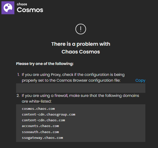

Connectivity Problems
Problem
On some occasions, starting the Chaos Cosmos Browser, leads to an error page pointing to problems with the connection to the Chaos Cosmos services.
Cause
Since Chaos Cosmos is a cloud-based service, it requires connection to the Cosmos service over the internet. There are two network problems which can interfere with that:
  • No internet connection
  • Network firewall or missing proxy configuration
Solution
In the case of No internet connection - fix the network problem and connect to the internet.
In the case of firewall or missing proxy configuration, there are two things to be done (usually, by your IT admins):
  • Configure the Cosmos Browser to work with the proxy set up in your network. You can see detailed instructions in this article.
