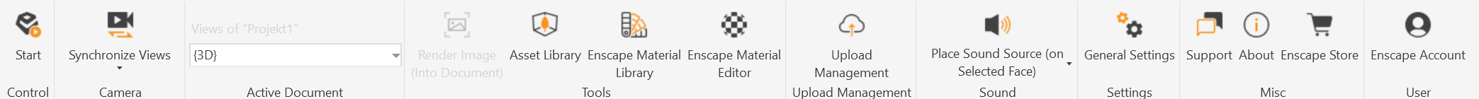

To begin, you must start the Enscape viewport. This can be done by clicking on the Start button located within the Enscape option in Revit’s top horizontal menu bar.
Enscape Toolbar in Revit

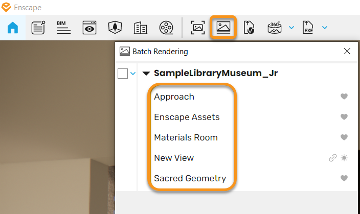

For the Batch Rendering button to become available you will need to have created at least one View via the View Management panel. Having done that, the Batch Rendering button will become available. If no Views are available, this button is grayed out and therefore disabled.
For more details on the Batch Rendering process, please click here.

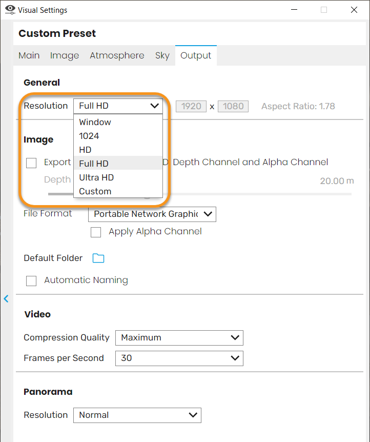

However, before you render your first Enscape image, you should adjust the resolution of your rendering. You’ll find the option to change the resolution under the Enscape Visual Setting’sOutput” tab. You can pick any preset or custom resolution you want (up to 8192 x 8192px), but be warned: using extremely high resolutions may result in the rendering process taking more than just a few seconds – and may even clog your GPU’s VRAM, causing Enscape and Revit to crash or stop responding all together. In such a situation, remember to send feedback to Enscape support who will clarify what caused the crash and provide you with a solution.
The Resolution options

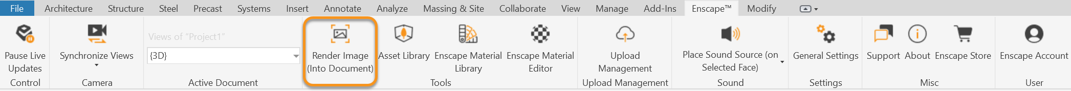

In Revit you can also render single images into the Revit project file itself via the Render Image (into Document) button. If you choose the Render Image (into Document) option, the rendered image will then appear in your Revit’s ‘Renderings’ folder in the Revit Project Browser.
The Render Image (into Document) button for Revit is found in the toolbar in the Revit UI and is only enabled when the Enscape window itself is open.
The Render Image (into Document) button in Revit

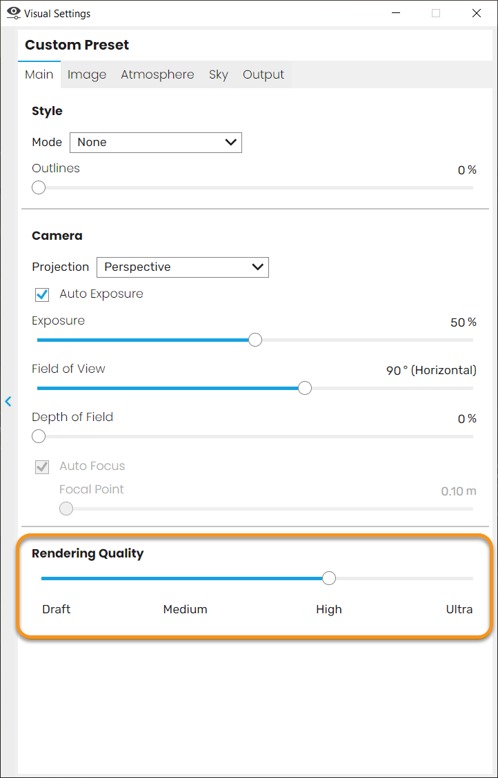

As already mentioned, setting the Resolution to ‘UltraHD’ will give you a high resolution image, but if you then also set the Rendering Quality slider in the Visual Settings’ Main tab to Ultra, this will give you the highest quality image possible.
However, setting Rendering Quality to High or even Medium is generally recommended when using Enscape in real-time to save on GPU resources. You can adjust this to be higher when it comes to rendering the image out if required. If you suffer from crashes when rendering images out to file from Enscape, then look to lower both Resolution and Rendering Quality to FullHD and High respectively.
All settings (e.g. Fog, Depth of Field, etc.) are the same for both rendered images and real time output.
If Rendering Quality is set to Draft, then there will be no glass reflections in the final render.
Rendering Quality Settings

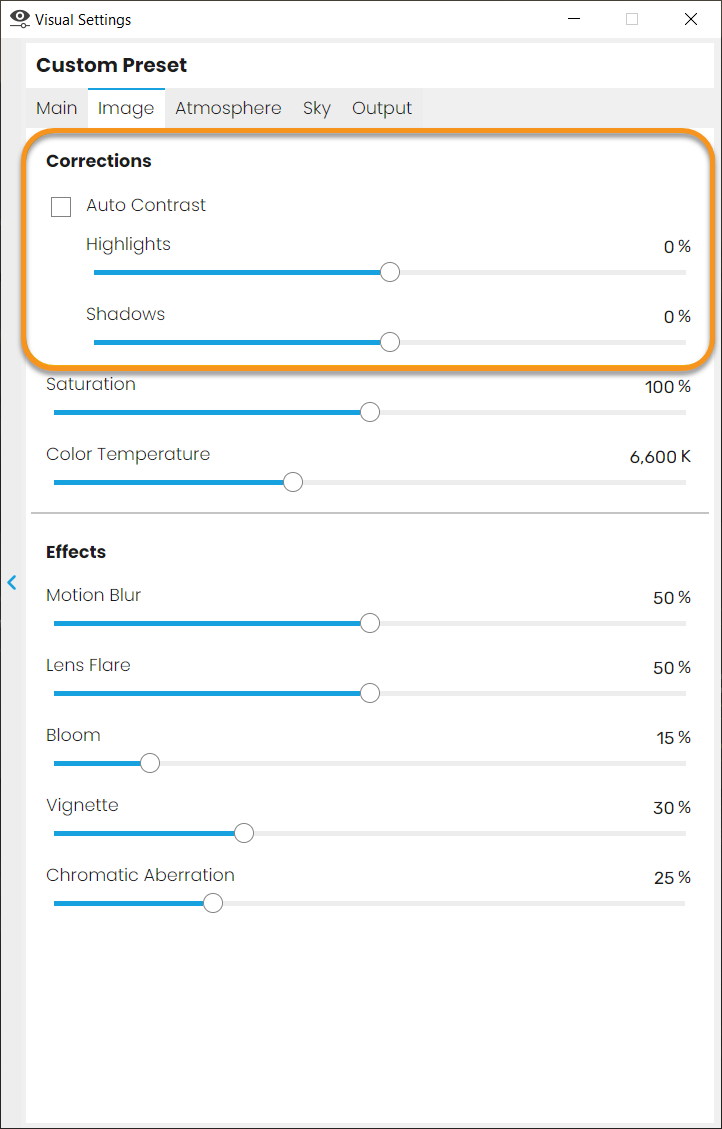

Under the Image tab of the Visual Settings dialog the Auto Contrast setting is disabled by default, allowing you to adjust the strength of the Highlights and Shadows in your render. Enabling Auto Contrast will hide these sliders and apply optimal contrast to the image.
Auto Contrast Settings

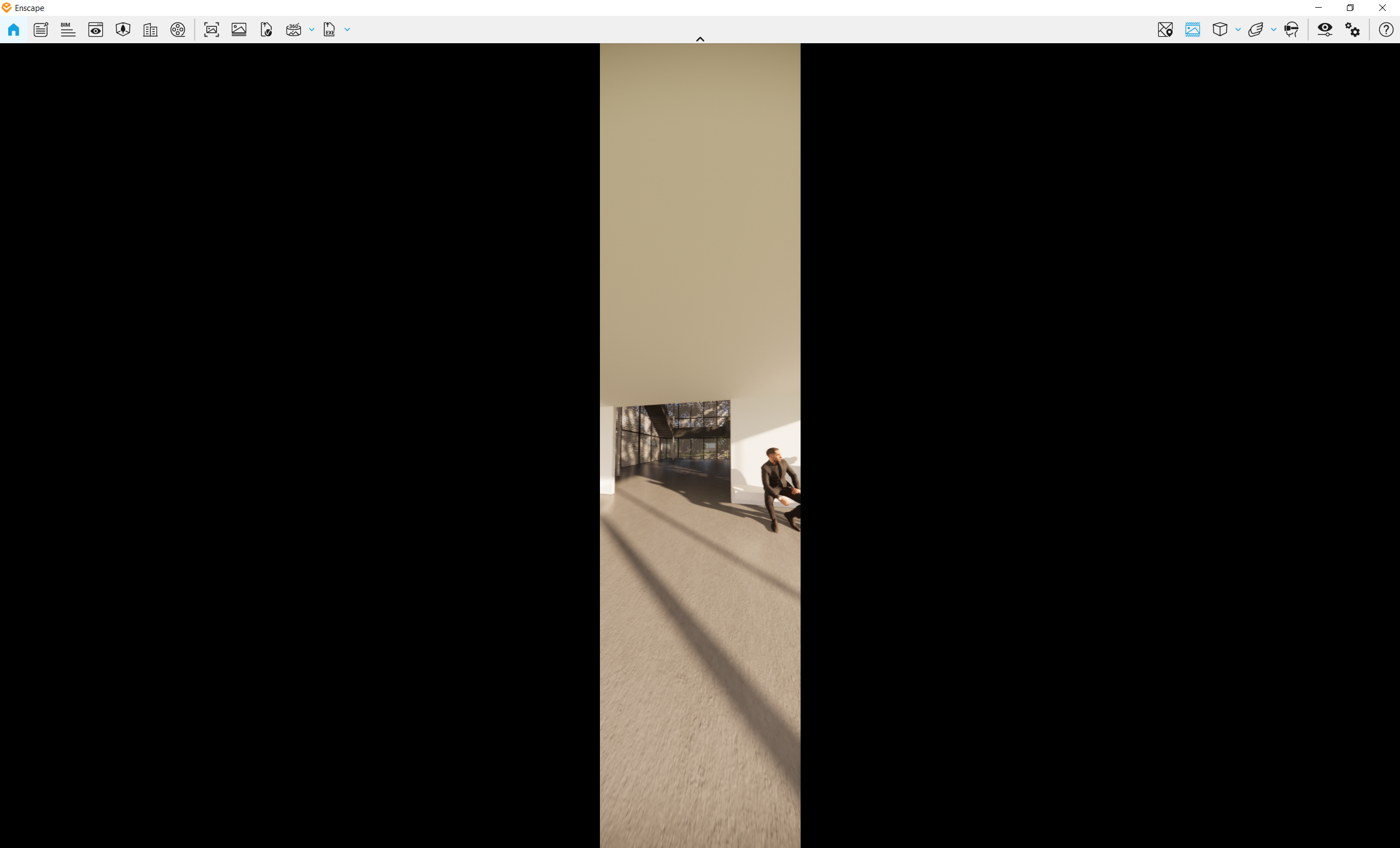

Show Safe Frame
Enscape has a Safe Frame feature, and this can be found in Enscape’s viewport toolbar.
If Show Safe Frame is enabled it will be always be visible in the live Enscape viewport, also when using the Video Editor.
Safe Frame enabled
So, you will still be able to navigate your project, as well as edit and preview video in the Enscape window when Show Safe Frame is enabled.
In the following screenshot, as way of an example, the Resolution is set to a Custom: 500×2000.
Preview when Safe Frame is enabled

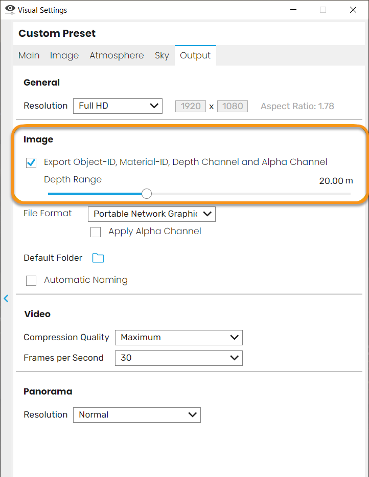

If you’d like to post-process your image in, for example, Photoshop, or incorporate your rendering into a photograph by including a transparent background, a very useful tool is the Export Object-ID, Material-ID and Depth Channel checkbox in the ‘Capture’ settings tab.
Export Object-ID, Material-ID and Depth Channel in Enscape
When active, Enscape will export four images for each image or View – the rendered image as seen in the Enscape window itself, a second image that’s graded from white to black, depending on the distance from the camera (Depth Channel) and third and fourth rendering that assigns a distinctive color to each object (Object-ID), material (Material-ID).

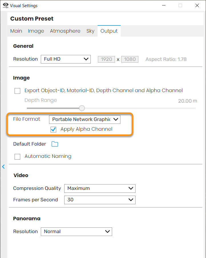

It is also possible to export images with an embedded alpha channel. This feature is only available when setting the file format to either .png, .exr, .tga.
To enable an image to be exported with an embedded alpha channel, make sure the checkbox for Apply Alpha Channel is checked.
The Alpha Channel export also includes information for transparent and semi-transparent materials. This means that if the sky is visible behind a semi-transparent surface, that background (sky) will be removed, without losing the reflection of the objects located in front of the surface.

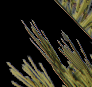

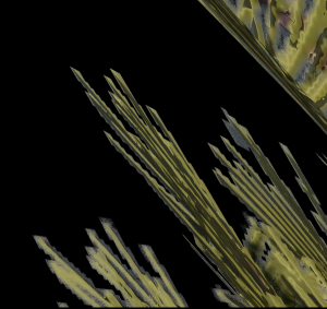

If you find you are not getting crisp clean edges on an exported image (where blue / red artifacts on an edge will be visible when zoomed in on the exported image) when Apply Alpha Channel is enabled, then set the Chromatic Aberration slider in the Enscape Visual Settings -> Image -> Effects section to 0. Here’s a comparison between the Chromatic Aberration slider being set to greater than 0 (enabled) and with the slider set to 0 (disabled).
Off
On

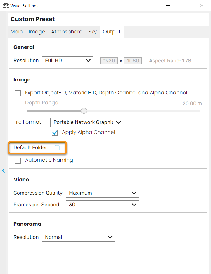

Default Folder
If you specify a Default Folder location in the Visual Settings’ Output tab, using the Screenshot will open the Save Screenshot dialog at that specified location. It is therefore still possible to change the location on the fly.
When using Batch Rendering, the action is the same, unless you link a named View to a Setting Preset, in which case, the location that each named View is rendered out to is dependent on the location specified in the linked Setting Preset.
This means you can assign each named View an individual and specific location when Batch Rendering.
Default Folder option

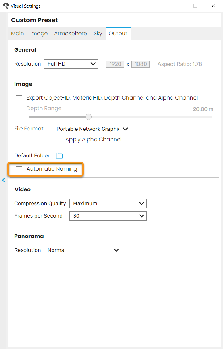

Automatic Naming
Enabling the Automatic Naming in the Enscape Visual Settings’ Output tab will rename the file appending it with the date and time for single images.
When Batch Rendering, the image names will additionally include the name of views, with or without automatic naming applied:
Batch render of multiple views:
filenames include date, time and name of views.
Batch render of a single view with automatic naming:
Batch render of single view without automatic naming:
user is prompted for a filename, the suggested name is however the same as above.
Automatic Naming option
Batch Rendering
Batch Rendering of images takes place when you click the Batch Rendering button. For more information on this topic, please click here.
