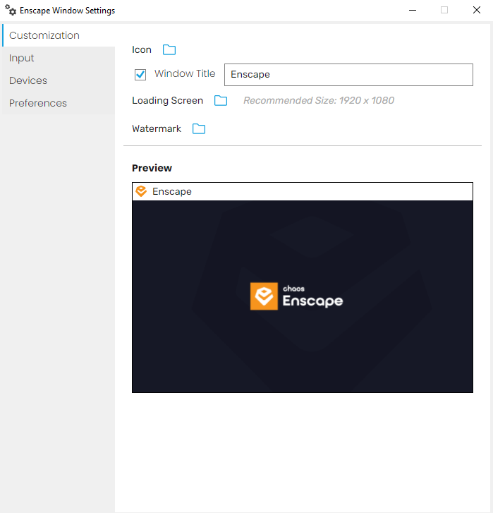

To access the Customization or Preferences settings, start Enscape and in the Enscape Viewport toolbar click on the gear icon that’s associated with the Enscape Window Settings dialog where the Customization tab should be shown by default.
Enscape Renderer Window Settings button
It is here that the options to adapt your Enscape window can be located.
Enscape Customization Settings
How to Customize the Enscape Window
You have various options to adapt your Enscape window:

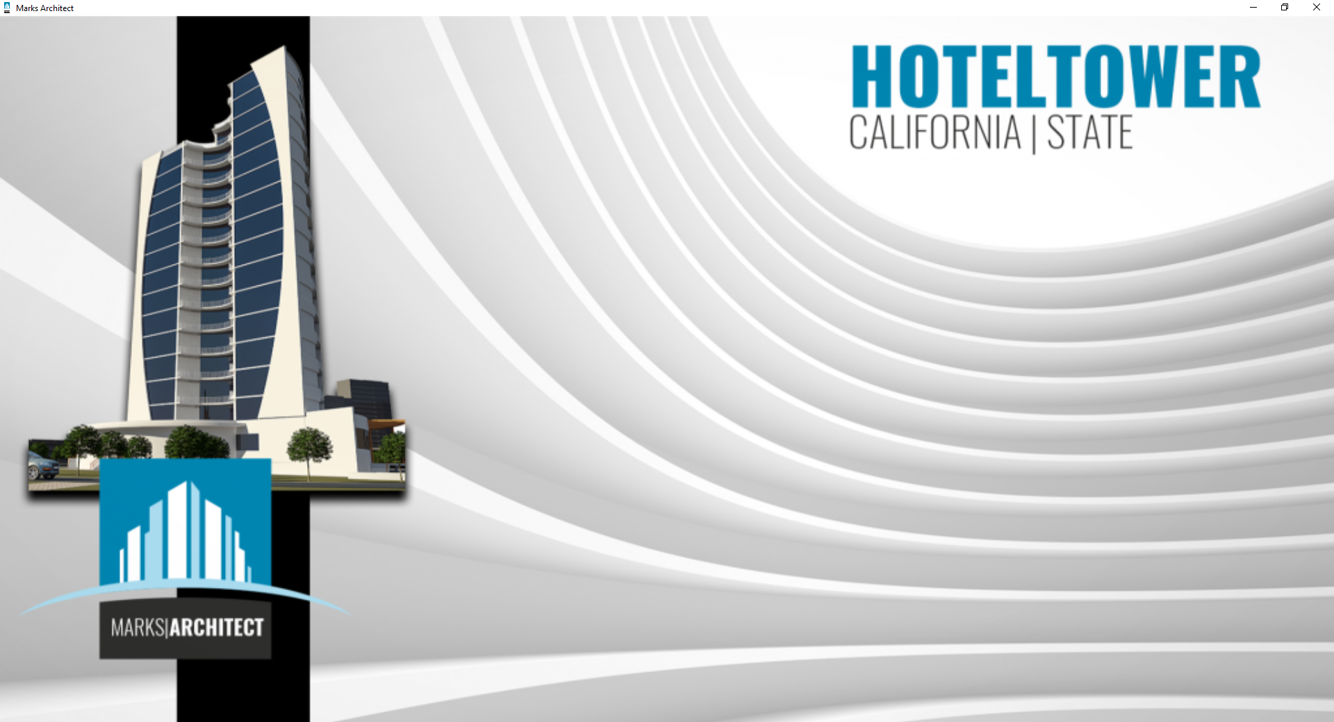

Loading Screen
Select a file (png, jpg, tga) to be used as Enscape loading screen, see example.
The recommended resolution is connected to your current screen resolution and aspect ratio.
If you have a screen resolution of 1920 x 1080 pixels, we’ll recommend the same resolution for the used file.
Example of a custom loading screen for Enscape

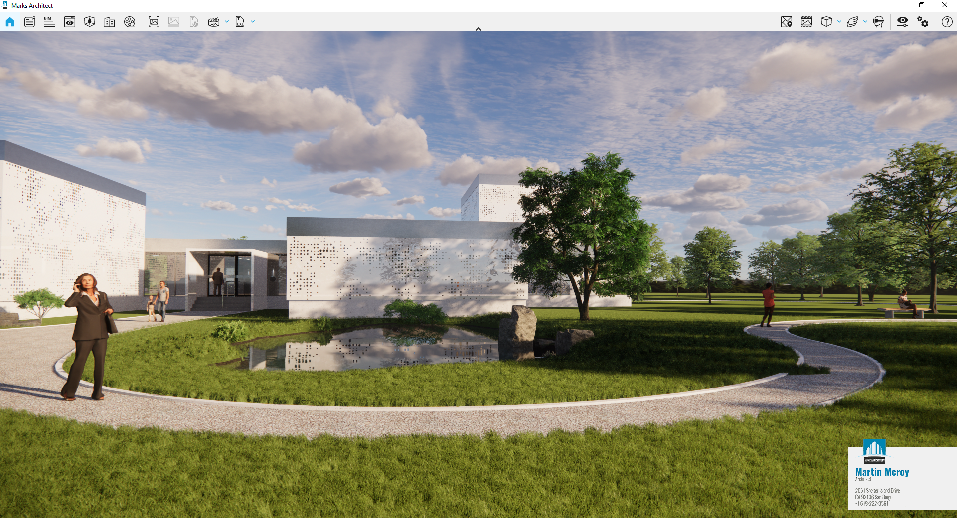

Watermark
Use the Watermark option to first select a file and then also select from a set of nine predefined positions the image will be set to in the Enscape window. This could be your company logo and the name of the working architect, as seen in the example. Additionally, the overlay will be contained in Screenshots, Videos, Standalone Executable files and Web Standalone files that you create.
Example of a custom onscreen overlay for Enscape

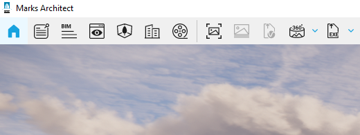

Window Icon
Select a file to be used as the window icon instead of the Enscape icon. For Enscape < 4.0, the file has to be an Icon File (*.ico). For 4.0 or newer versions, this can be any supported image format.
  • This option changes Enscape’s window icon. It affects any icon related to the Enscape window, including
    • The icon in the upper-left corner,
    • The task bar icon,
    • Other Enscape window related icons.
  • It affects Enscape when used from inside your CAD software and the standalone alike.
  • It also replaces the standalone’s file icon.
A customized Icon for the Standalone file
Window Title
This option enables you to change the text which appears in the title bar of the Enscape window.
Customized Window Caption text

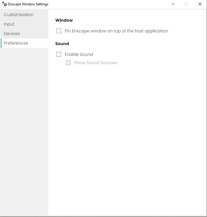

Preferences
By selecting the Preferences tab in the Enscape Window Settings dialog you can access the options to:
  • Window
    • Pin Enscape window on top of the host application
  • Sound
    • Enable Sound
      • Show Sound Sources
Show Sound Sources will only be available if the Enable Sound option is enabled. More information about which CAD’s support sound can be found here.
Enscape Window Settings Preferences options
