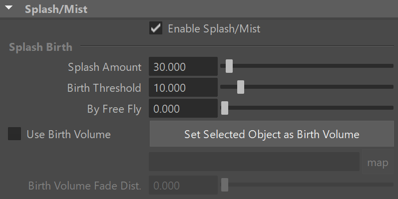

EnablesplEnbl – Enables the birth and simulation of Splash and Mist particles.
Splash Birth
Splash AmountsplBirthRate – Controls the amount of splash relative to the liquid. This value determines how many splash particles are equal to a single liquid particle in volume. This value also affects the particle size, where larger values decrease the size of splash particles. Note: This parameter is the nearest in functionality to the "birth rate" parameter in previous versions. For more information, see the Splash Amount example below.
Birth ThresholdsplBirthTresh – Splashes are born when the local curvature of the liquid surface exceeds this value. The lower the threshold is, the more places on the liquid surface will produce splashes.
By Free FlysplByFreeFly – How likely a free falling or flying liquid particle will turn into splash. At 0.0, free falling/flying liquid will not convert into splashes. The main usage of values above 0.0 is in waterfall simulations. It is not recommended that this parameter be changed to a value other than 0.0 for ocean simulations because this might create splashes over the ocean surface or even in air pockets under the water surface. For more information, see the By Free Fly example below.
Use Birth Volume | useSplashBirthVolume – When enabled, allows the splash to be born naturally by the simulation only inside a specified geometry object. The splash born inside the Birth Volume can travel outside the volume without a problem. The difference between this approach and spawning splash inside a volume manually from a Source object is that using a Birth Volume, the splash birth will follow the simulation criteria of the simulation and will look and behave more naturally.
Set Selected Object as Birth Volume - When a polygon mesh and a Phoenix Simulator are selected, the selected object will be used as the Birth Volume for the generation of Splash particles in this simulator.
Birth Volume | splashBirthVolume – Specifies a geometry object to confine splash particles. To do this, select the simulator and the confine geometry and from the Phoenix FD menu, select Set Splash Birth Volume.
By default, the birth volume geometry is not automatically converted to a non-solid and it will behave as a rigid body in your simulation. In this case, you can still use the Birth Volume Fade Dist to expand an area around the object where Foam/Splash births are possible. You can convert the geometry to a non-solid from its Phoenix FD Extra Attributes in order to allow liquid to exist inside it as well.
Also note that birth volumes will interact with the simulation even if they are hidden. If you wish, you can exclude the Birth Volume from the Scene Interaction rollout.
Birth Volume Fade Dist | splashBirthVolumeFade – Controls how far the splash particles will spawn around the specified Birth Volume geometry object, in world units.

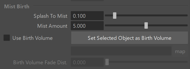

Mist Birth
Splash to MistsplSplitRate – Controls how fast the splash particles are converted into mist. This value determines the portion of the splash volume that is turned into mist after traveling one meter (3.3 feet). During its motion, a splash particle constantly produces mist particles, decreasing the volume of the splash. When the entire volume is exhausted, the splash particle disappears. This parameter controls how fast this happens. If the value is 0.0 the mist is not simulated at all, and if you restore a simulation containing mist, the mist will be deleted.
Mist AmountsplMistMult – Controls the amount of mist. This value determines how many mist particles are spawned by a single splash particle.
Use Birth Volume | useMistBirthVolume – When enabled, allows the mist to be born naturally by the simulation only inside a specified geometry object. The mist particle born inside the Birth Volume can travel outside the volume without a problem. The difference between this approach and spawning mist inside a volume manually from a Source object is that using a Birth Volume, the mist birth will follow the simulation criteria of the simulation and will look and behave more naturally.
Set Selected Object as Birth Volume - When a polygon mesh and a Phoenix Simulator are selected, the selected object will be used as the Birth Volume for the generation of Mist particles in this simulator.
Birth Volume
 | mistBirthVolume – Specifies a geometry object to confine mist particles. To do this, select the simulator and the confine geometry and from the Phoenix FD menu, select Set Mist Birth Volume.
Birth Volume Fade Dist | mistBirthVolumeFade – Controls how far the mist particles will spawn around the specified Birth Volume geometry object, in world units.

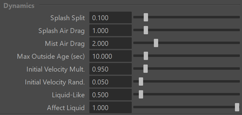

Dynamics
Splash Split | splSplitToSplash – Controls how quickly the flying splash particles split into smaller ones, creating a trail. If you set it to 0.0, the splash particles would not split at all.
Splash Air DragsplAirFriction – The air friction of the splash droplet. A value of 1 represents the air friction of an average rain droplet.
Mist Air DragsplMistDrag – The air friction of the mist. This value determines not only how fast the speed decreases, but also the influence of the wind. The larger this value, the larger the wind's influence.
Max Outside Age (sec) | splTimeOut – If a particle exits the grid and its age (in seconds) exceeds this parameter, it will be killed instantly. This parameter affects both splash and mist. Note that this is not the time since the particle exited the grid, but the time since the particle was born.
Initial Velocity Mult.splVMult – When the splash particles are born, they are initialized with the velocity of the nearest liquid multiplied by this value. This parameter greatly affects the general appearance of the splash. When it is below 1, the liquid droplets fly in front of the splash and produce a clearly visible track.
Initial Velocity Rand.splVRand – Controls the randomness of the velocity direction when splash particles are born. This affects the birth of splashes both by liquid particles, and by splitting of splash particles into smaller splash particles. The velocity is randomized equally in all directions, not just in the direction of splash travel, or perpendicular to it.
Liquid-Like | splLiquidLike – Controls the ability of the splash particles to stick to each other, forming different strings and tentacles, so the splash behaves more like liquid and blends better with the behavior of the liquid mass. The higher this value, the larger the acceleration needed to break the connection. Note that larger values will increase the calculation time. For more information, see the Liquid-Like example below.
Affect LiquidsplAffectLiq – Controls the conversion of liquid to splash, and splash back into liquid. When this value is not zero, the splash birth causes some of the liquid to disappear, and then when the splash enters the liquid the splash particles are replaced by liquid. A value of 1 with splashes and mist enabled produces a physically accurate simulation where liquid, splash and mist are constantly converted into one another, and the sum of all three at any point during the simulation is the same as the original liquid. This option is good for Waterfall simulations but not so much for ocean simulations where you want the ocean surface to be smooth, as it would create bumps in the liquid mesh where splashes fall into the liquid.
 When a Splash particle is converted into a Liquid particle, it inherits the Default RGB and Default Viscosity values set under the Liquid rollout.
