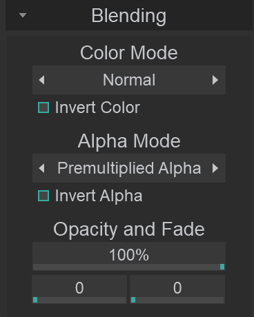

The Blending Property Panel allows you to control the color and alpha blending for the current layer, and set up an animated fade effect.
Properties
UI Path: ||Property Panel|| > Blending panel
Color Mode – Allows you to choose from the five different color blending modes below. You can cycle through them with the Previous Mode and Next Mode buttons or you can right click and choose a mode from the context menu.
Normal – This is the standard blend mode which simply takes each pixel from the top layer if present. Otherwise the bottom layer is used.
Add
– This blend mode simply adds pixel values of one layer with the other. In case of values above 256 (in the case of RGB), white is displayed.
Multiply
– Multiply blend mode multiplies the RGB numbers for each pixel of the top layer with the RRB number for the corresponding pixel from the bottom layer. As a simple multiplication can get values as high as 65025, which is far higher than the maximum allowed value, 255, the result is divided by 255. The result is a darker picture.
Screen
– With Screen blend mode the values of the pixels in the two layers are inverted, multiplied, and then inverted again. This is in some way the opposite of multiply. The result is a brighter picture.
Difference
– Difference subtracts the top layer from the bottom layer or the other way round, to always get a positive value. Blending with black produces no change, as values for all colors are equal to 0. (The RGB value for black is 0,0,0). Blending with white inverts the picture
Invert Color – Inverts the layer colors.
Alpha Mode – Controls how the Alpha channel is applied. You can choose from several modes. You can cycle through them with the Previous Mode and Next Mode buttons or you can right click and choose a mode from the context menu. The different alpha modes will yield different results when applied. The following explanations assume a Normal blending mode. For more information, see the Alpha Mode Comparisons example below.
Ignore Alpha – The image is treated as fully opaque. The existing alpha channel (if any) is ignored. The alpha channel of the result will show a white rectangle.
Normal Alpha – The foreground color is mixed with the background color. This is suited for images with independent color and alpha channels.
Premultiplied Alpha – Assumes that the foreground color has been multiplied by the alpha channel and mixes it with the background color.
Invert Alpha – Inverts the layer's alpha channel.
Opacity and Fade – Controls the opacity of the current layer and allows for fade in and out effects
Layer opacity – Controls the Opacity of the current layer. You can drag it to change the opacity or right click and reset its value from the context menu.
Fade In length / Fade Out length – These sliders allow you to animate the opacity of the layer in order to achieve Fade-in and Fade-out effects. The opacity will always be animated from 0% to its current value or vice versa. A value of 30 for the left slider means that the opacity of the layer will be animated from 0% to its current value for 30 frames. The animation will start at the beginning of the sequence or at the In point if there is one. A value of 30 for the right slider means that the Opacity of the layer will be animated from its current value to 0% for 30 frames. The animation will start 30 frames before the end of the sequence or the Out point if there is one.
