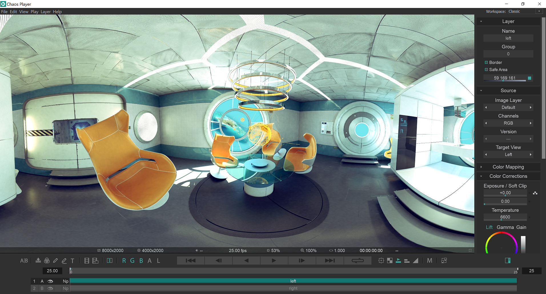

Once the composition has been set you can use the stereoscopic view button (next to the channel view buttons) to cycle between left, right and stereo views.
Manual Setup
To manually set up a stereoscopic composition you need to do perform the following steps:
  • First you need to load the sequence for the left and right channel in Chaos Player. (See the Quick Start for more information.)
  • In the Source tab of the Property Panel select each layer and specify its target. (i.e. set the Target View for the left channel to Left and for the right channel to Right).
Setting up the Left and Right views
  • You can toggle between the Left, Right and Stereo view in the Preview Area by clicking on the Stereoscopic view button (next to the Channel view buttons).
  • To select the Stereoscopy method right click on the Stereoscopic view button and select the method from the drop down menu. You can choose between four different methods: Red/Cyan Anaglyph, Green/Magenta Anaglyph,Interlaced Stereo and Checkerboard.
