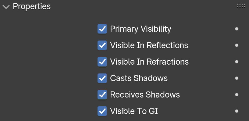

Render Stats
Primary Visibility – When disabled, the object will not be visible. See the Primary Visibility example.
Visible In Reflections – When disabled, the object will appear perfectly transparent to reflection rays. See the Visible in Reflections/Refractions example.
Visible In Refractions – When disabled, the object will appear perfectly transparent to refraction rays. See the Visible in Reflections/Refractions example.
Casts Shadows – When disabled, the object will not be casting shadows. See the Cast Shadows example.
Receives Shadows – When disabled, the object will not receive shadows.
Visible To GI – When disabled, the object will be considered perfectly transparent to GI rays.

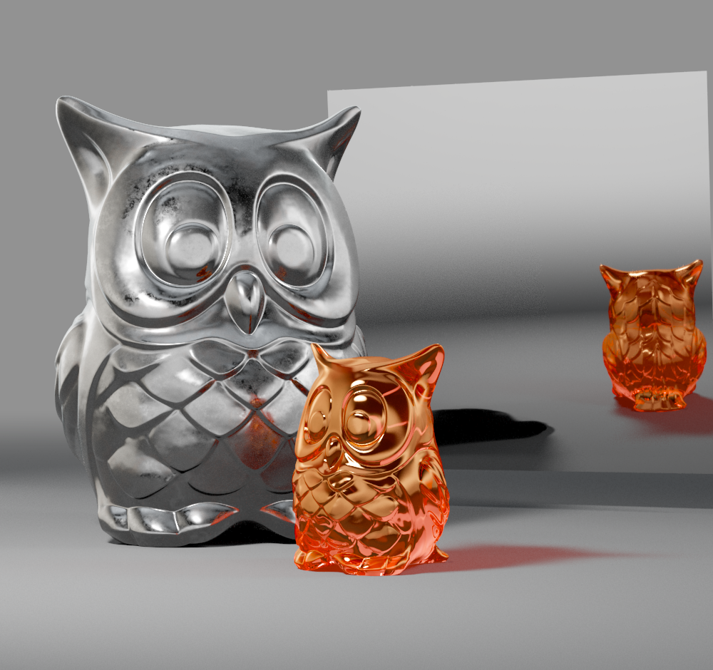

Example: Primary Visibility
This example shows the effect of the Primary Visibility parameter. The V-Ray Render Stats material is applied to the glass owl figurine.
When Primary Visibility is disabled, the glass owl figurine is not visible to the camera, but it is still visible in reflections and refractions and continues to cast shadows.
Off
On

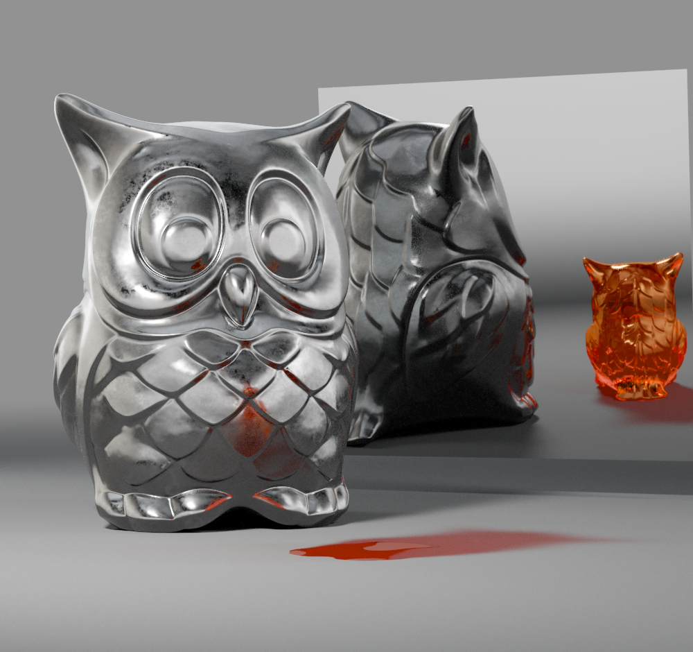

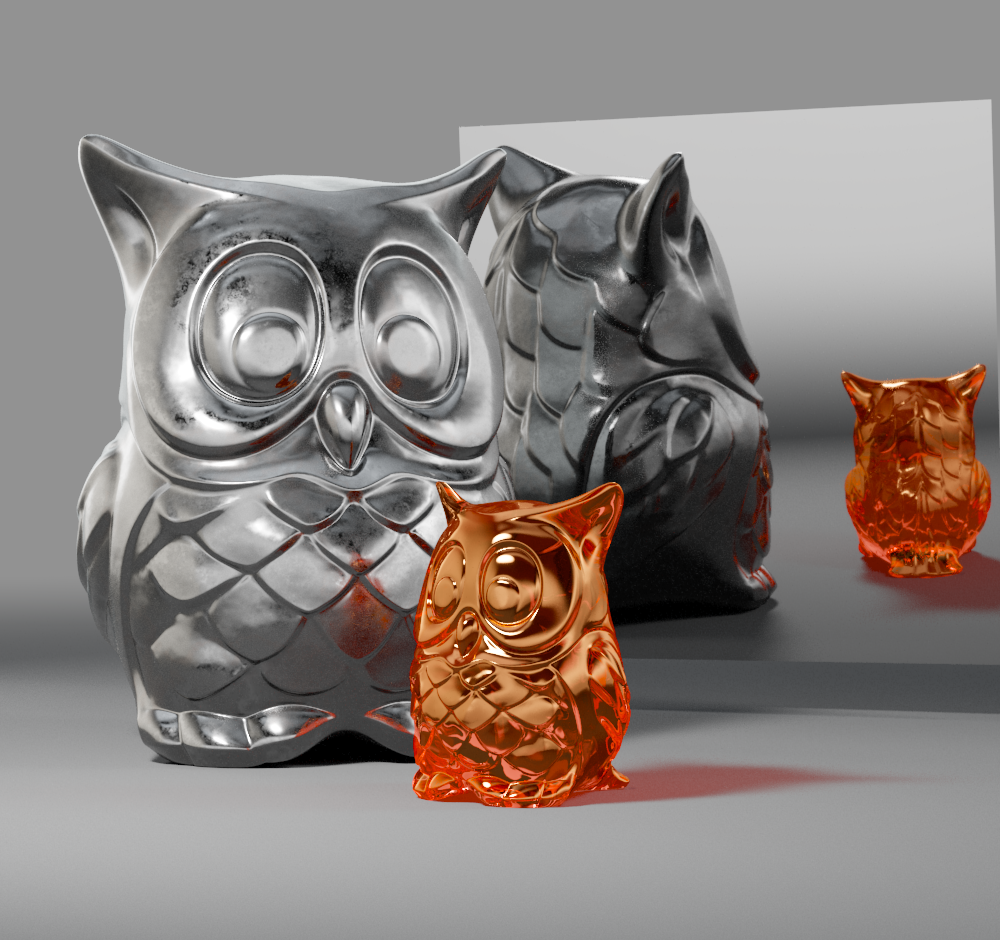

Example: Cast Shadows
This example shows the effect of the Cast Shadows parameter. The V-Ray Render Stats material is applied to the metallic owl figurine.
On
Off

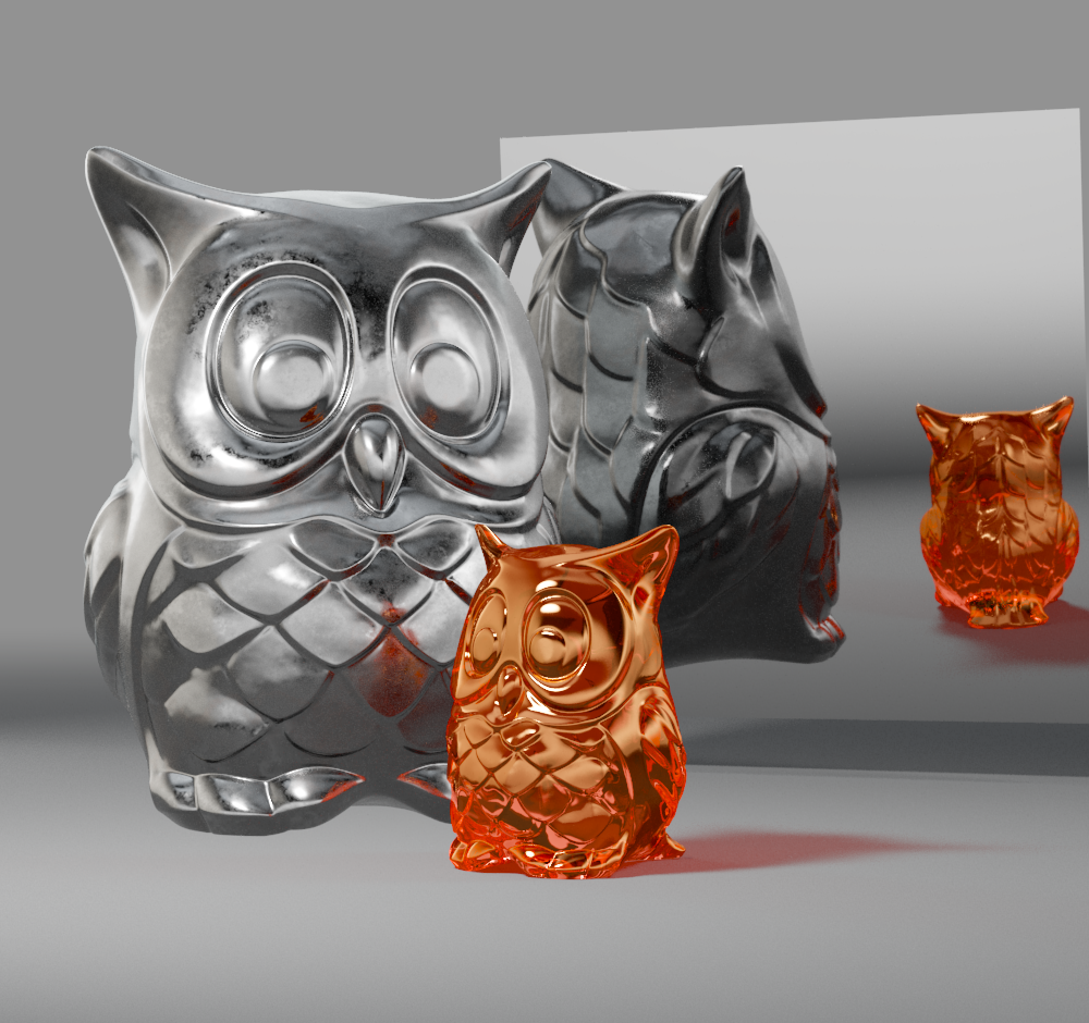

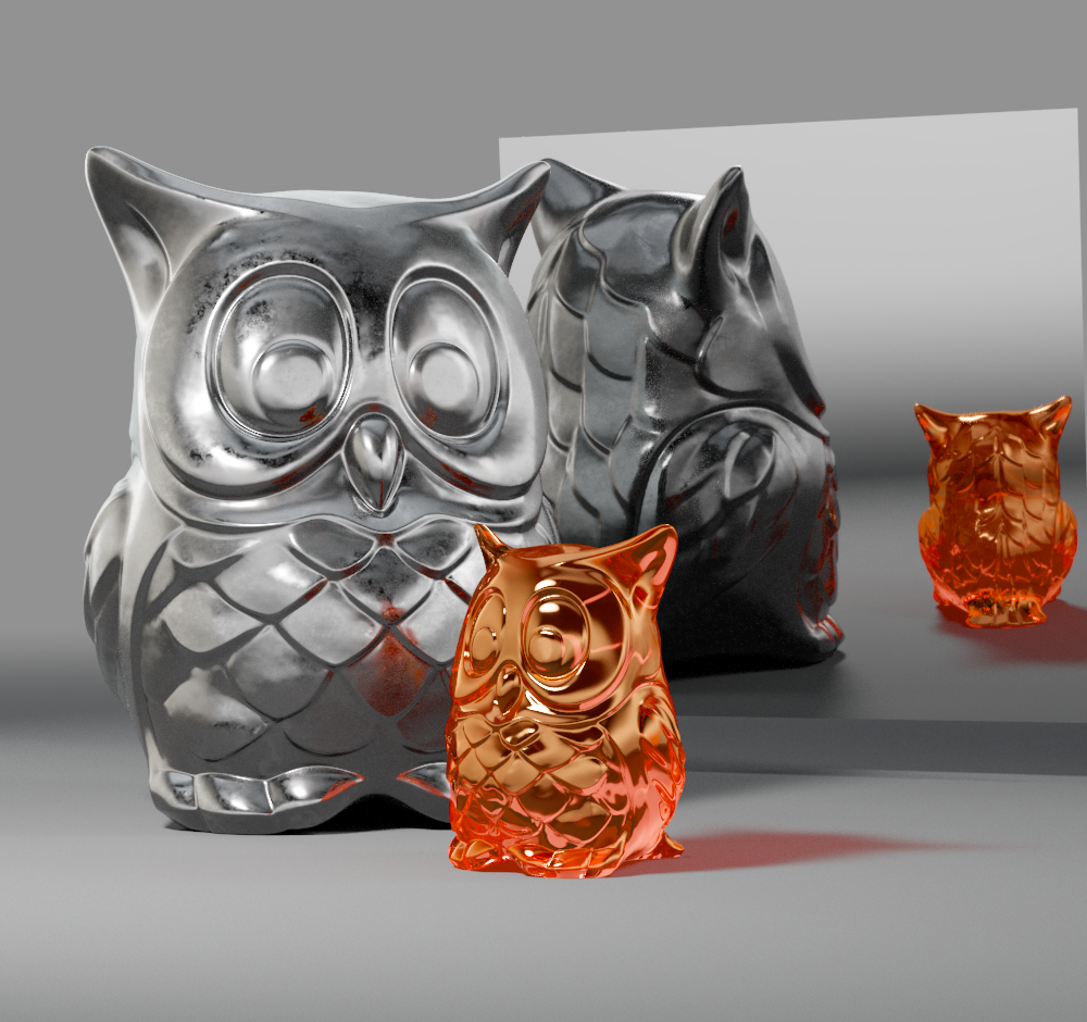

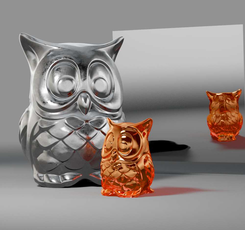

Example: Visible in Reflections/Refractions
This example shows the effect of the Visible In Reflections and Visible In Refractions parameters. The V-Ray Render Stats material is applied to the metallic owl figurine.
When Visible In Reflections is off, the metallic owl is transparent to reflection rays, and respectively when the Visible In Refraction is off, the metallic owl is transparent to refraction rays. When both options are off, the metallic owl is neither visible in the mirror plane nor in the glass owl figurine.
Visible In Reflections and Visible In Refractions are on
Visible In Reflections is off, Visible In Refractions is on
Visible In Reflections is on, Visible In Refractions is off
Visible In Reflections and Visible In Refractions are off
