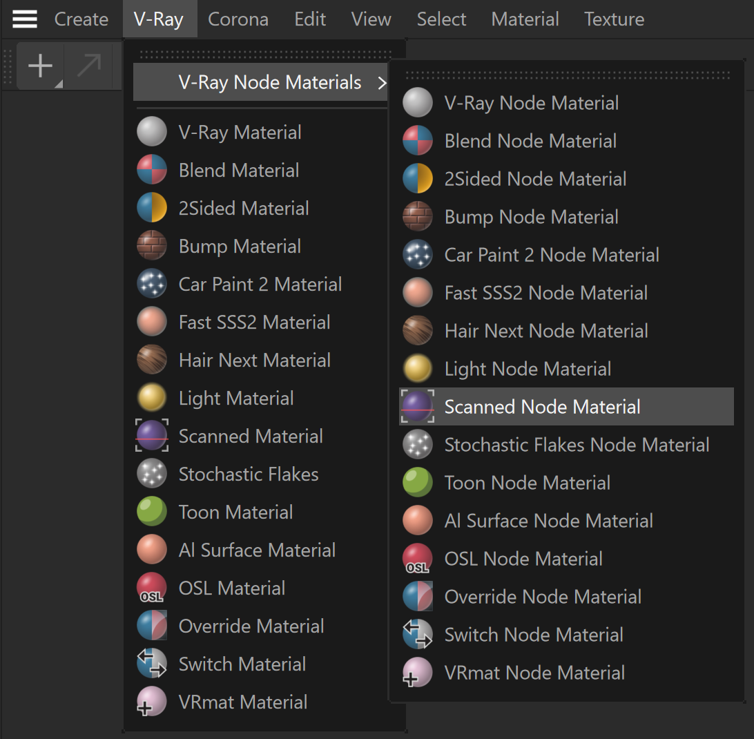

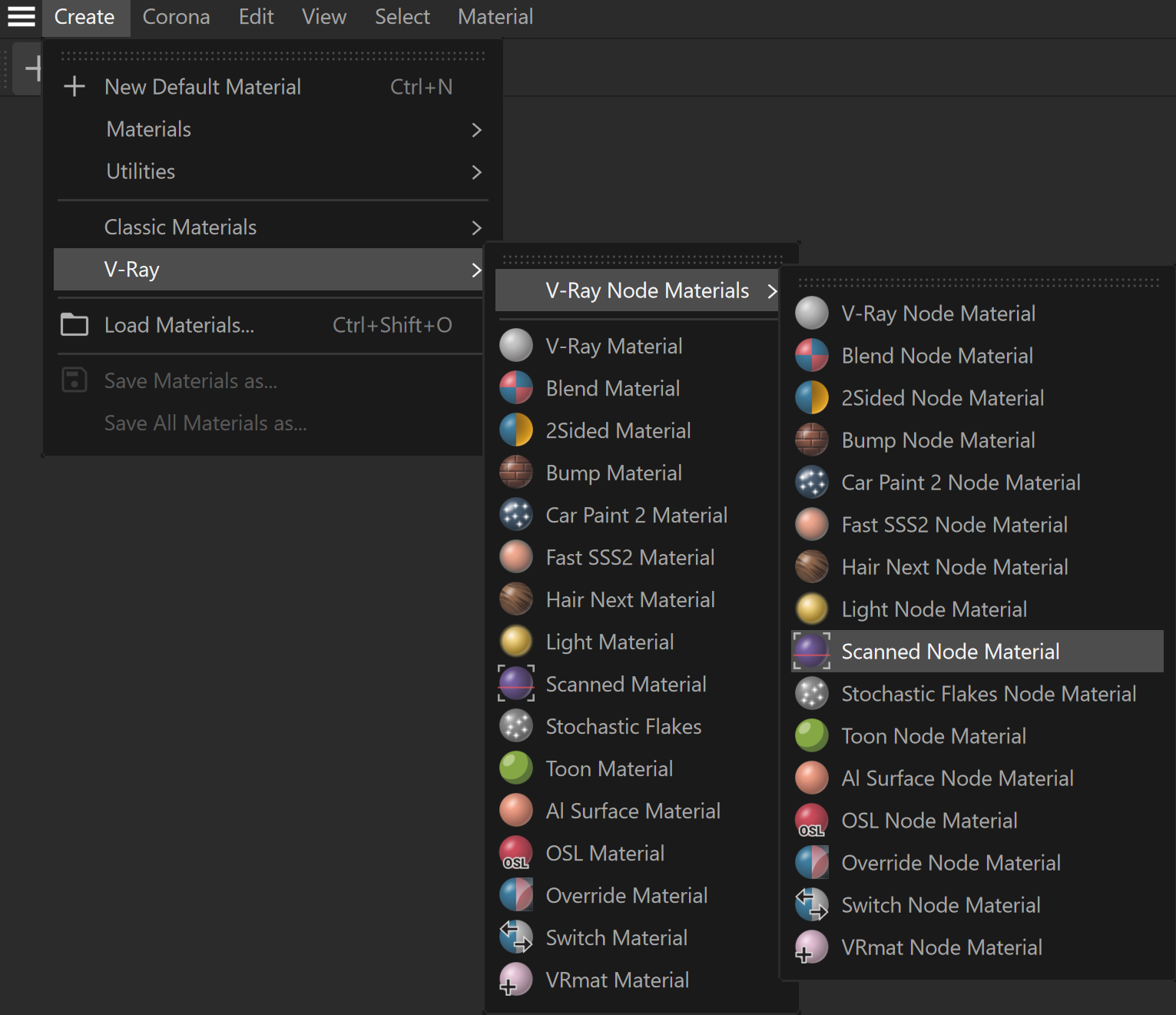

UI Paths
||V-Ray|| > V-Ray Node Mateirals > Scanned Node Material
||Create|| > V-Ray > V-Ray Node Materials > Scanned Node Material (disabled Separate menu for V-Ray materials)

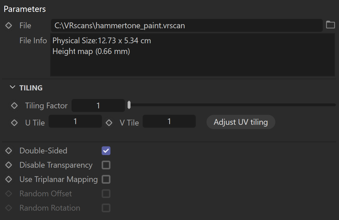

File – The file name with the data for the scanned material; files have a .vrscan extension.
File Info – Displays info about the loaded .vrscan file.
TILING
Tiling Factor – Global multiplier for U and V coordinates.
U/V TIle – Controls the position of the texture along and U or V axes.
Adjust UV Tiling – This tool automatically sets the tiling to match the size of the object. See how to apply this function.
Double-Sided – Enables both sides of the material.
Disable Transparency – Turns off transparent properties of the material.
Use Triplanar Mapping – Ignores the object's default UV mapping and assigns one with U and V axes parallel to the nearest object-space axes.
Random Offset – Randomizes the material offset when Triplanar Mapping is used.
Random Rotation – Randomizes the material rotation when Triplanar Mapping is used.

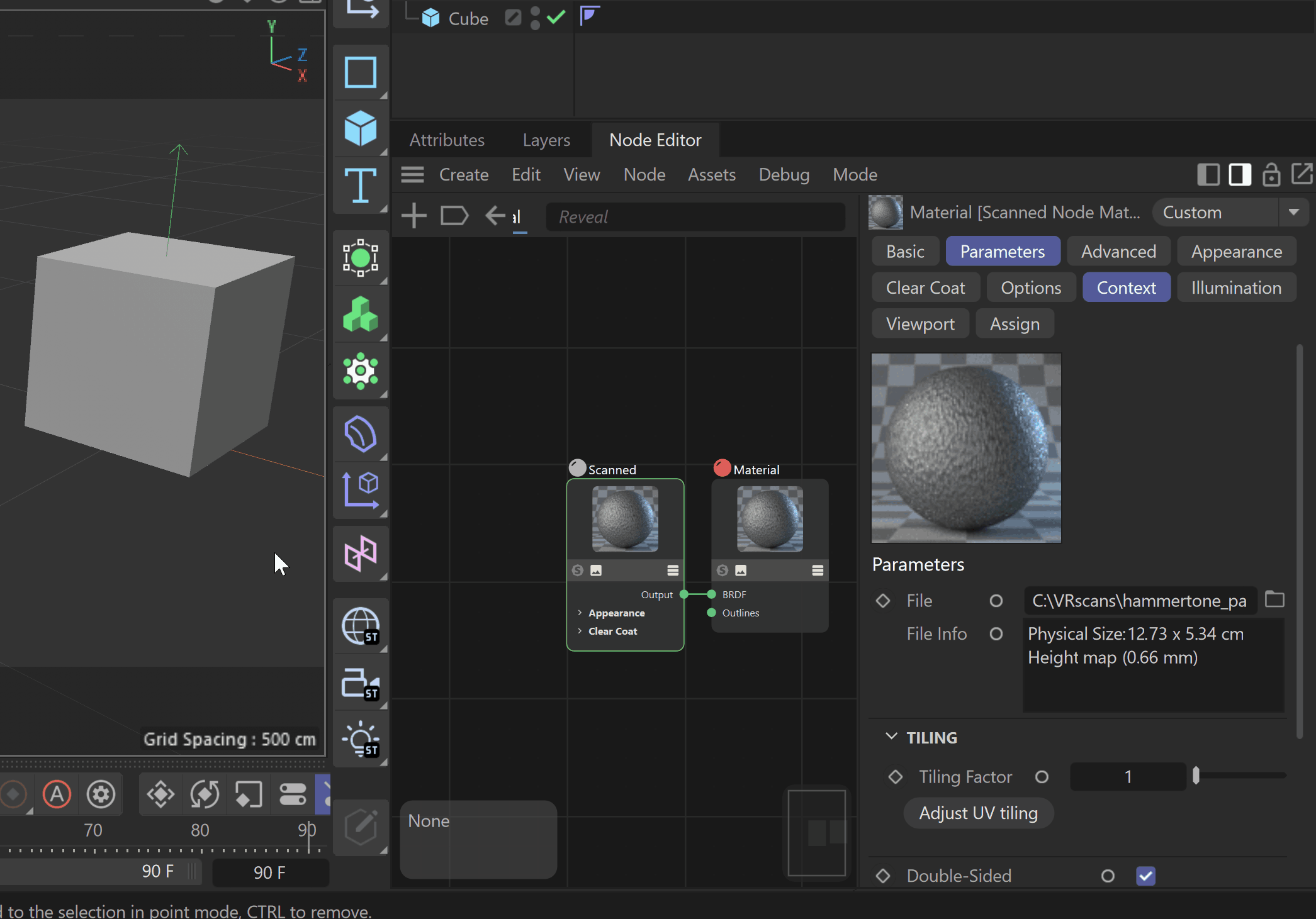

Adjust UV Tiling Walkthrough
  • The material needs to be applied to the geometry before any calculations can be done, as they are based on the object.
  • To activate the automatic calculation of the UVs, click on the Adjust UV Tiling button.
  • The cursor is then replaced with an eyedropper icon. Using the cursor, select the object, the Scanned material is applied to, from the viewport.
  • Then, the tool calculates the exact sizes and creates a UVW Transform node. It attaches it automatically to the Scanned material and adjusts the Transform S. parameter's U and V axes accordingly.
In the GIF, you can see the texture changes as the UVs are adjusted.
Click on the GIF to view it in full size

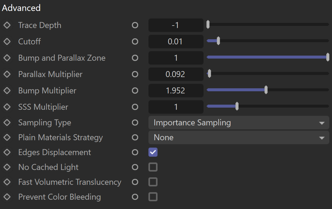

Advanced
Trace Depth – Controls the number of reflection bounces. A value of -1 means that the reflection bounces are controlled by the global V-Ray trace depth in the Global switches rollout of the Renderer Settings.
Cutoff – A threshold used to speed up reflections. If the contribution of reflections falls below this threshold, the reflections are not traced. This is similar to the Cutoff of the V-Ray Material.
Bump and Parallax Zone – Determines the point where additional bump and parallax no longer exist and only natural height effects remain. This option is especially useful in side views of the material, where it might appear flat or less detailed. A value of 0 adds no additional bump and parallax. Value of 1 adds additional bump and parallax equally, regardless of the view angle. All scanned materials by default have the most suitable value loaded for this parameter to achieve the most realistic look. If you need full control over the bump and the parallax, set the value to 1 and work with the Parallax and Bump Multipliers
Parallax Multiplier  – A multiplier for additional parallax and edge displacement strength.
Bump Multiplier – A multiplier for the additional bump.
Sampling Type – Determines which samples are taken around pixels involved in "blurry" effects such as anti-aliasing, depth of field, indirect illumination, area lights, glossy reflections/refractions, translucency, motion blur, etc.
Importance Sampling – Bases the number of samples allocated to a value on the importance of certain aspects, depending on the case. For instance, distance from the camera, if objects are too far, or if more samples are needed to render a realistic result.
Uniform sampling – The number of samples is evenly taken over the entire image.
Plain Materials – A strategy used for material display. It controls the visibility of textures, if any are present. Possible values are:
None – The full material evaluation is always used. The object must have valid UV coordinates.
Average BRDF – Averages the BRDF and can be used to speed up the rendering for previews. Because texture details are removed, this also removes any tiling artifacts that might arise if the scanned sample does not tile very well. UV coordinates are still needed because most BRDFs are slightly anisotropic.
Average Symmetric BRDF – Smooth representation of the material with no maps visible.
Scramble –
Edges Displacement – Uses a special technique that makes the edges of the geometry appear slightly jagged inwards. This option is useful when rendering close-ups of materials with bumps. It is faster than actual displacement and helps to achieve better realism.
No Cached Light – Allows you to disable the cached light for the material, ensuring physical accuracy without the need to switch off GI of the entire scene. Disabling this option results in faster, but less physically accurate render.
Fast Volumetric Translucency – Relevant only to volumetric translucent V-Ray scanned materials. When this option is enabled, the calculation of the volumetric translucency is fast, but less accurate.
Prevent Color Bleeding – When enabled, the indirect GI/glossy rays see the material as gray, thus preventing coloring of the near objects.

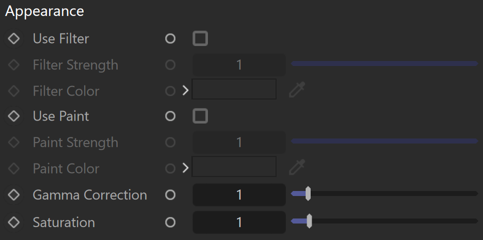

Appearance
Use Filter – Enables the use of the color filter.
Filter Strength – Multiplies the effect of the filter.
Filter Color – A color multiplier for the material sample that can be used to tint the material. Keep in mind that it affects the color of the reflections as well as the post effects. A texture node can also be attached to this slot.
Use Paint – Enables the use of Paint Color.
Paint Strength – Multiplies the effect of the paint.
Paint Color – Changes the color of the material without losing the texture or changing the reflection color. For example, changing the color of wood or leather without losing their textures. A texture node can also be connected to this slot.
Gamma Correction – Adjusts the gamma of the material (including paint color and filter color, if used) as a post-effect.
Saturation – Controls the saturation of the material (including paint color and filter color, if used) as a post-effect.

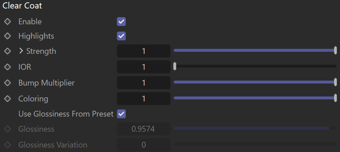

Clear Coat
The clear coat parameters are similar to those found in the Car Paint 2 Node. These parameters are only available if, while scanning an object, it is determined that the object possesses the properties of a material with a clear coat.
Enable – Enables the tracing of a clear coat layer for the material.
Highlights – Enables highlights from point light sources for the coat layer.
Strength – Specifies the strength of the coat reflections.
IOR – Determines the Index of Refraction of the coat layer and controls the strength of the reflections. A value of 1.0 does not produce any reflections and disables the coat layer. Higher values produce stronger clear coat reflections. The .vrscan file contains the correct value (typically 1.6) for this parameter, which is set automatically when the file is loaded but can be adjusted higher or lower if needed.
Bump Multiplier – The coat layer has a built-in bump map stored in the material sample file. This allows you to control the strength of that bump.
Coloring – Turns the coat reflections colored.
Use Glossiness From Preset – When enabled, the glossiness values are taken from the .vrscan file.
Glossiness – Determines the glossiness amount, when the Use Glossiness From Preset option is disabled. Glossiness determines the sharpness of the reflections. A value of 1.0 means perfect mirror-like reflection; lower values produce blurry or glossy reflections.
Glossiness Variation – Controls the effect of glossiness growth under shallow observation angles. This parameter represents a real physical effect that can be seen in brushed metals, plastics, etc. One common example of this effect is seen in a stainless steel pan - its reflection lines become sharper when viewed from an angle. The parameter range is 0-1. Higher values produce a faster transition to fully glossy when the observation angle becomes more shallow.

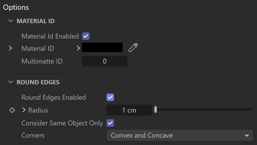

Options
Material Id Enabled – Enables the use of Material ID.
Material ID – The color used by the Material ID render element. You can also use a shader here.
Multimatte ID – The integer ID of the material to be used by the Multi Matte render element.
Round Edges Enabled –  Enables the round edges effect, which uses bump mapping to smooth out the edges of the geometry during render time.
Radius – Specify a radius (in world units) for the round edges effect. Since the actual geometry is not being changed and only the normals of the faces are affected, large values here may produce undesirable effects.
Consider Same Object Only – When enabled, the rounded corners are produced only along edges that belong to the same object which has the attribute applied. When disabled, rounded corners are produced along edges formed when the object with the attribute intersects other objects in the scene.
Corners – Choose which edges are considered in the calculation. Possible options are:
Convex and Concave – Considers all edges.
Convex Only
– Only applies Round Edges effect to edges with convex angles.
Concave Only –
Only applies Round Edges effect to edges with concave angles.

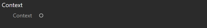

Context
Context – Allows the attachment of a Context node (UVW generator) to adjust the UVWs of the texture. For more information, visit the Context Nodes page.
