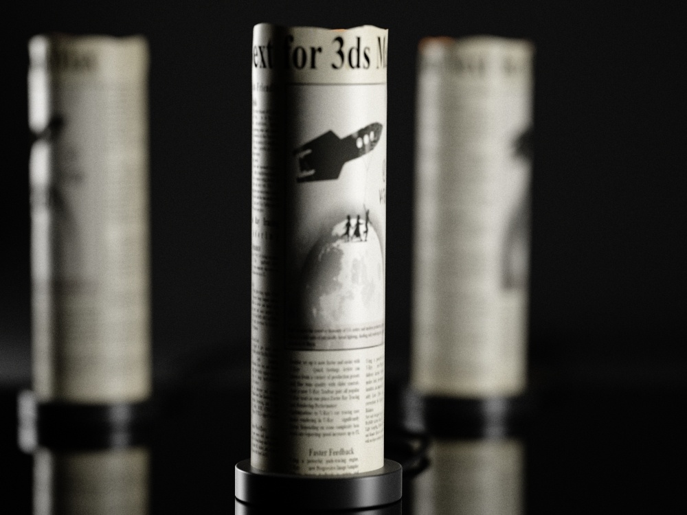

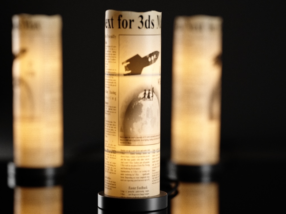

Step 3: Adjust the translucency
Translucency determines which side (front or back) relative to the camera is more visible in the render.
Select the VRay2SidedMtl node. In the Parameters rollout, set the Translucency color to the desired value. Note that darker colors make the VRay2SidedMtl look more solid, while lighter colors make it more sheer and allow more light from the back side to pass through the object.
Change the slider below the image to the right, to see a few different examples of the Translucency value in the 2-Sided material when there is only a Front material linked.
It looks good but can be further improved if the other side of the newspaper uses another print. Therefore, we use a back material.
Translucency is set to black. No light is passing through.
Translucency is mid-gray.
Translucency is set to white, allowing all the light to pass through.
Move the slider to see the example renders.

Change the slider below the image to the right, to see a few different examples of the Translucency value in the 2-Sided material.
Translucency is set to black. No light is passing through and the back material is not visible.
Translucency is mid-gray, allowing light from the back to pass through and making both materials visible. Thus, both materials contribute equally to the final result.
Translucency is set to white, allowing all the light to pass through. Only the back material is visible in the render.
Final Image
Here's the final image with the Translucency set to mid-grey:
