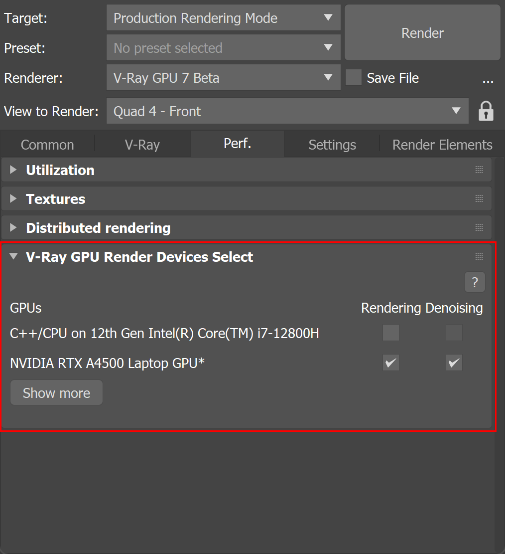

Can I choose which devices are used for GPU rendering?
Yes. See the GPU setup section for instructions on how to do this.

How can I check which devices on my system can be used for GPU rendering? Why my devices are not listed?
Check the list of devices in the GPU settings tab. Keep in mind that in certain setups 3ds Max does not recognize some of the devices.
If 3ds Max doesn't properly recognize any CUDA devices, V-Ray automatically fallbacks to using the CPU for CUDA calculations (as if the c++/cpu device was selected for CUDA rendering).
