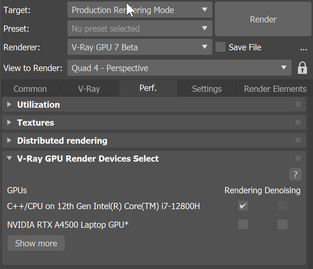

You may not want to use all available GPU devices for rendering, especially if you have multiple GPUs and you want to leave one of them free for working on the user interface or you may want to combine your CPU and GPU together (see the Hybrid Rendering section below). To do this, you can use the control in the V-Ray GPU Render Devices Select in 3ds Max, which allows you to specify which devices you want to use for GPU rendering without restarting 3ds Max.
Alternatively, you can use the supplied GUI tool, which you can find in Start Menu > Programs > V-Ray 6 for 3ds Max 20xx > Select rendering devices for V-Ray GPU for 3ds Max 20xx, where xx is the 3ds Max version.
After changing this option, you need to restart the 3ds Max (or V-Ray Standalone) if it is running for the changes to take effect. If the V-Ray GPU render server is running as a Windows service, you may need to stop it from the Services applet in the Control Panel.
The Select devices for V-Ray rendering tool also allows for selecting GPU devices for denoising.
Note that when multiple devices are selected for denoising, out of all the devices that match the query only the device with the highest compute capability is used for the denoising process.
The asterisk (*) sign next to a GPU device's name in the list means that a monitor is connected to that GPU device. If two or more monitors are connected to the GPU device, there are 2 or more asterisks next to the GPU device name.
There is a tooltip that appears upon hovering over the asterisks that shows information on the GPU and number of monitors connected to it.
