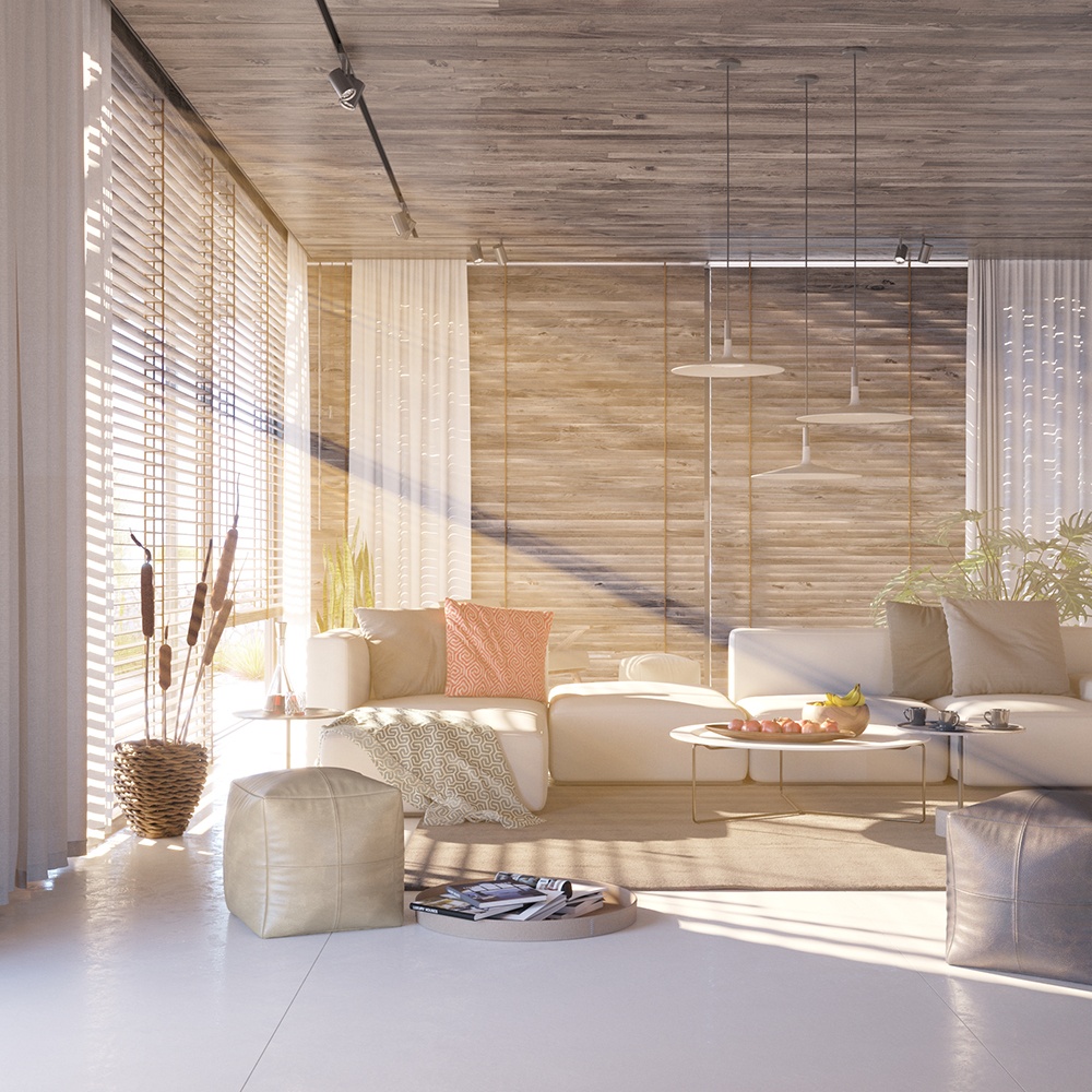

Common Uses
The Atmosphere Render Element is useful for changing the appearance of the atmosphere and volumetric effects in a rendered image using compositing or image editing software. In the example, fog is generated using the VRayEnvironmentFog. A warmer color is assigned to the fog and the intensity is increased using the Atmosphere RE.
Before
After
