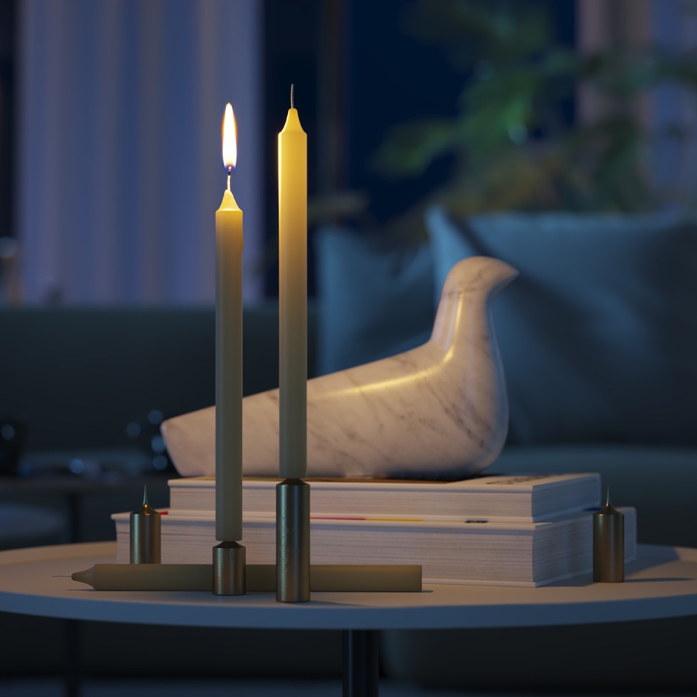

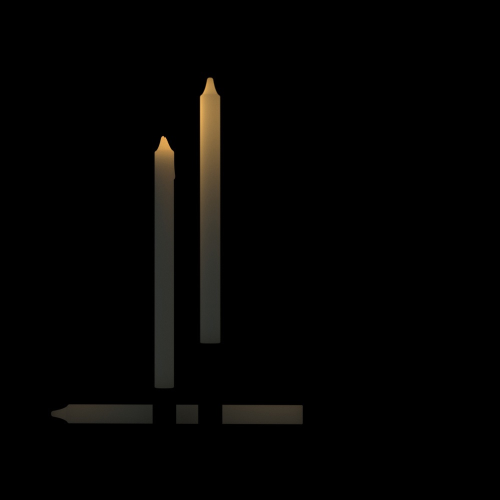

The Subsurface Scattering Render Element is useful for changing the appearance of SSS2 elements, after rendering, in a compositing or image editing software. In the example, the scattering color is changed to red using the SSS2 RE. See the render before and after compositing.
Before
After

The VRaySSS2 Render Element is added to the Beauty composite to form the final image.
