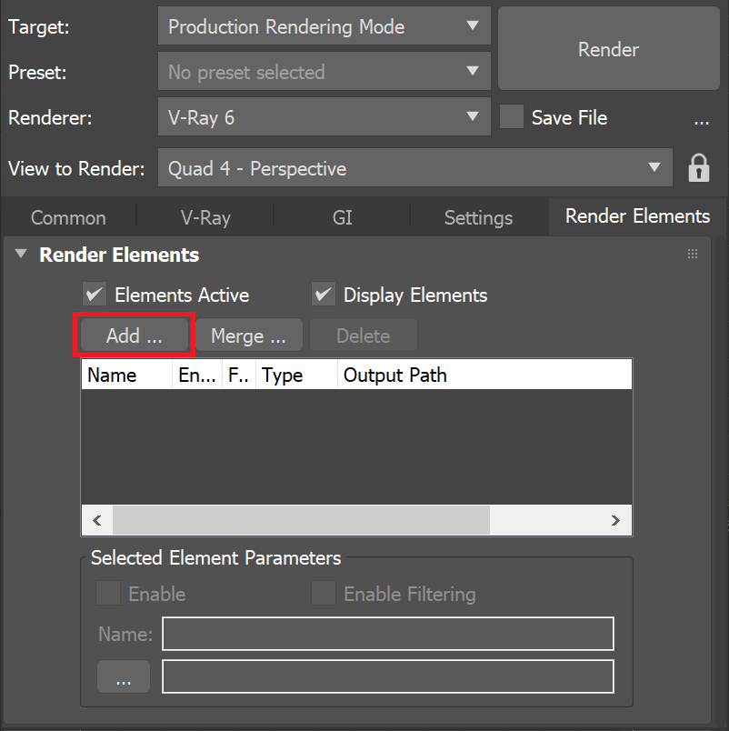

This render element is enabled through the Render Elements tab of the Render Setup window in 3ds Max and displays its parameters in a rollout at the bottom of the window:
VRayVFB – When enabled, the render element appears in the V-Ray frame buffer.
Deep output – Specifies whether to include this render element in deep images.
Color mapping – Applies the color mapping options specified in the Color mapping rollout (Render Setup window > V-Ray tab) to this render element. This option is enabled by default.
Multiplier – Sets the overall intensity of the render element, where 1.0 is the standard multiplier.
Denoise – Specifies whether to denoise this render element.

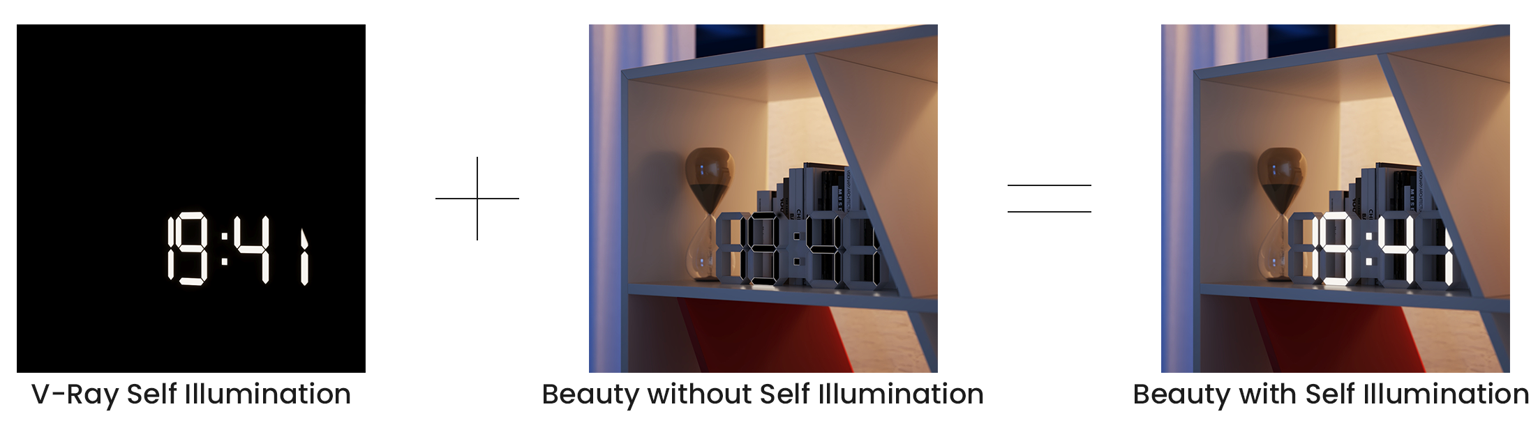

The Self Illumination Render Element is useful for changing the appearance of self-illuminated surfaces, after rendering, in a compositing or image editing software. See the render before and after compositing.
Compositing Formula
The VRaySelfIllumination Render Element is Added to the Beauty render to form the final image.
