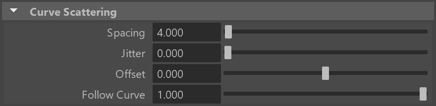

Curve Scattering Parameters
The options in this menu are active when the scattering mode is set to 1D - On Curves.
Spacing – Determines the spacing between instances in scene units. See the Spacing example below for more information.
Jitter – Randomly jitters instances along the curve. Each instance has Spacing applied on both sides, except the instances at the end of the curve. The Jitter value is divided between those two Spacings. To allow instances to jitter in all their Spacing distance, the Jitter needs to be set to 2. See the Jitter example below for more information.
Offset – Determines how much the instances are offset in one direction of the curve. When set to 1, all instances replace the one after them, as the offset equals the whole value of the Spacing. See the Offset example below for more information.
Follow Curve – Determines how scattered instances are oriented along the curve. Assigning a value of 1 makes instances follow the curve and are oriented along the local tangent direction. See the Follow curve example below for more information.

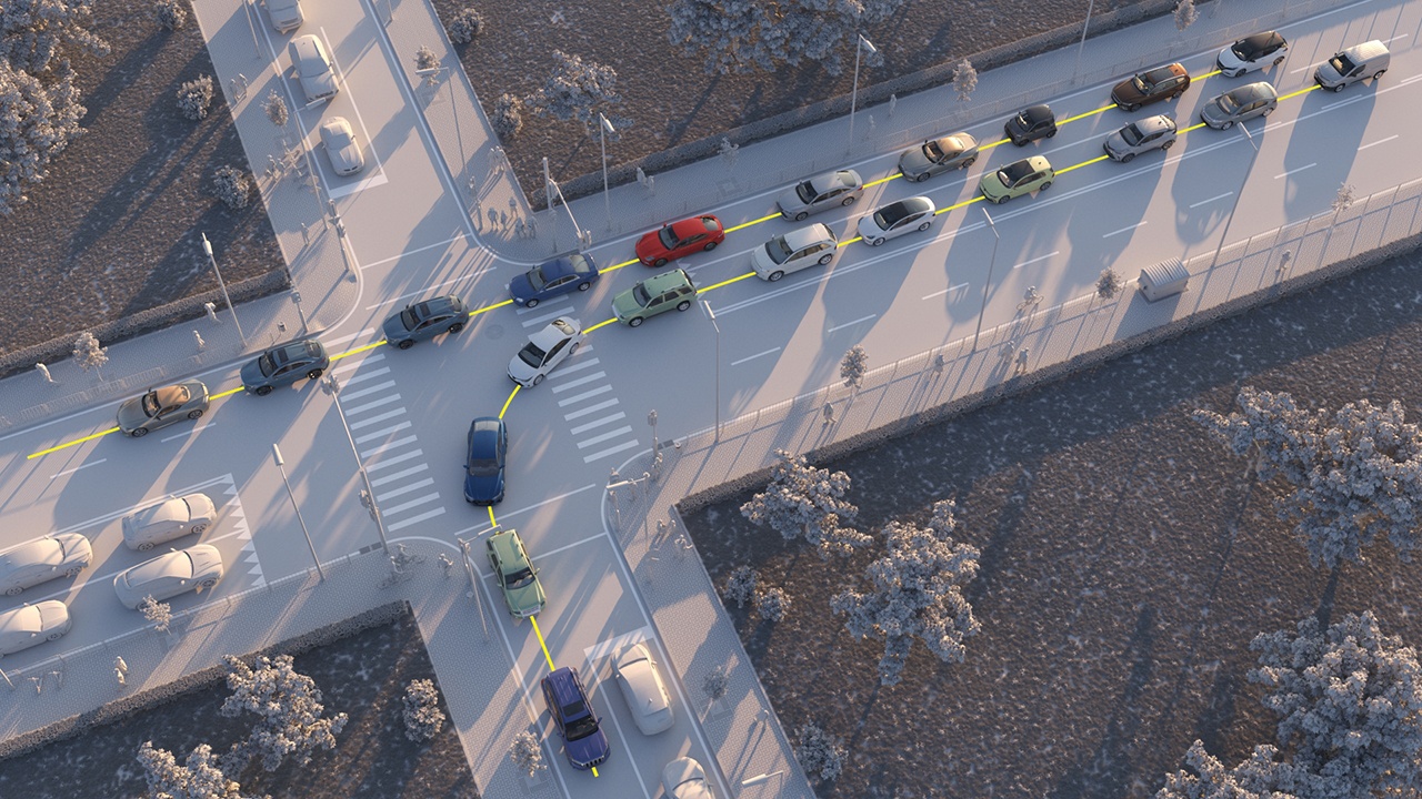

Spacing = 500

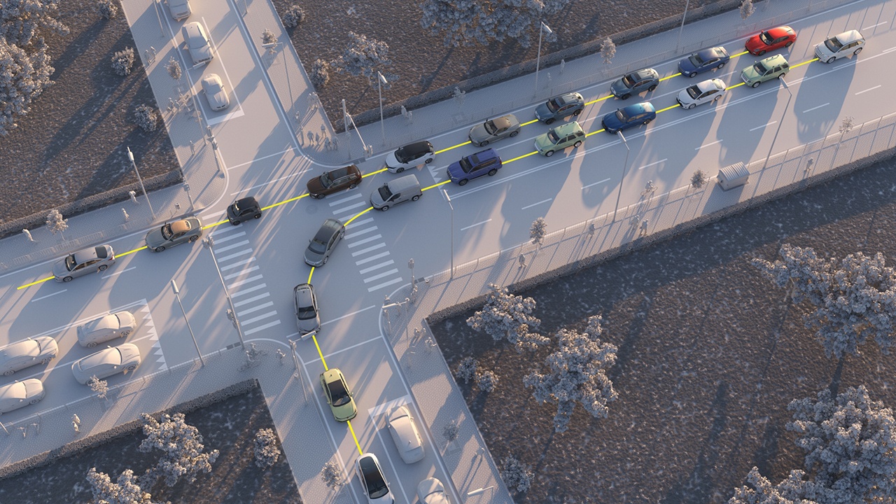

Spacing = 750

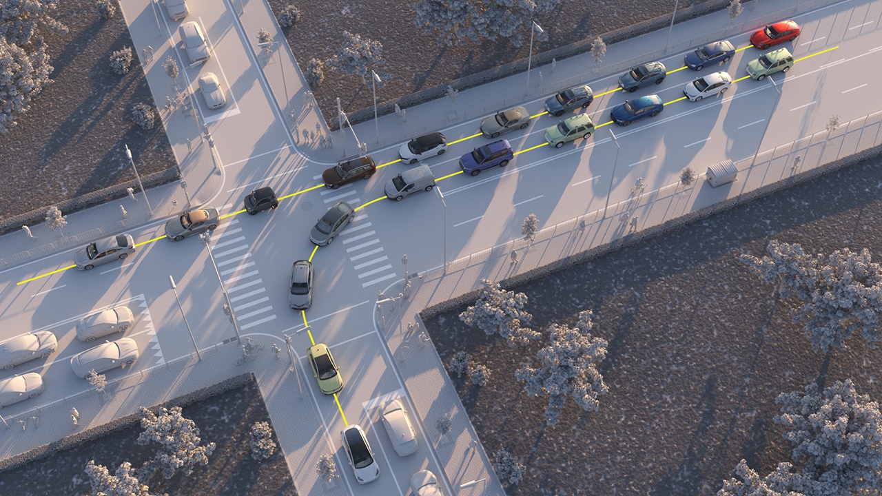

Spacing = 1000

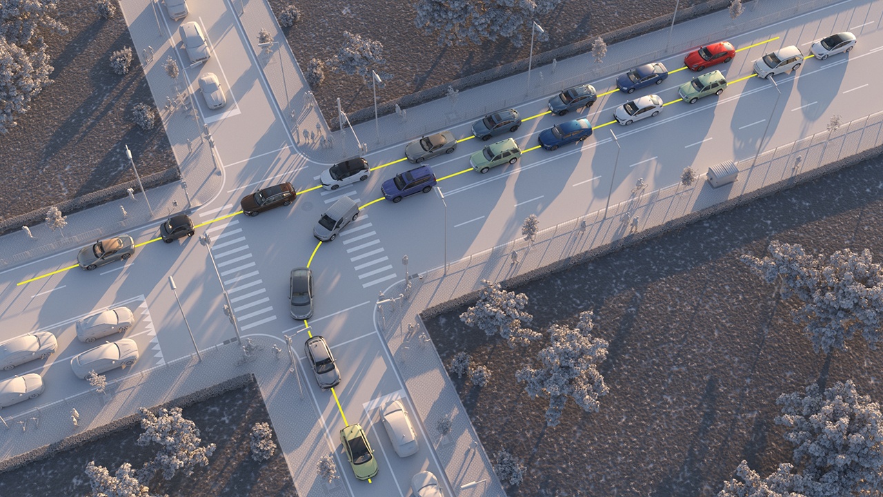

Spacing = 2000
