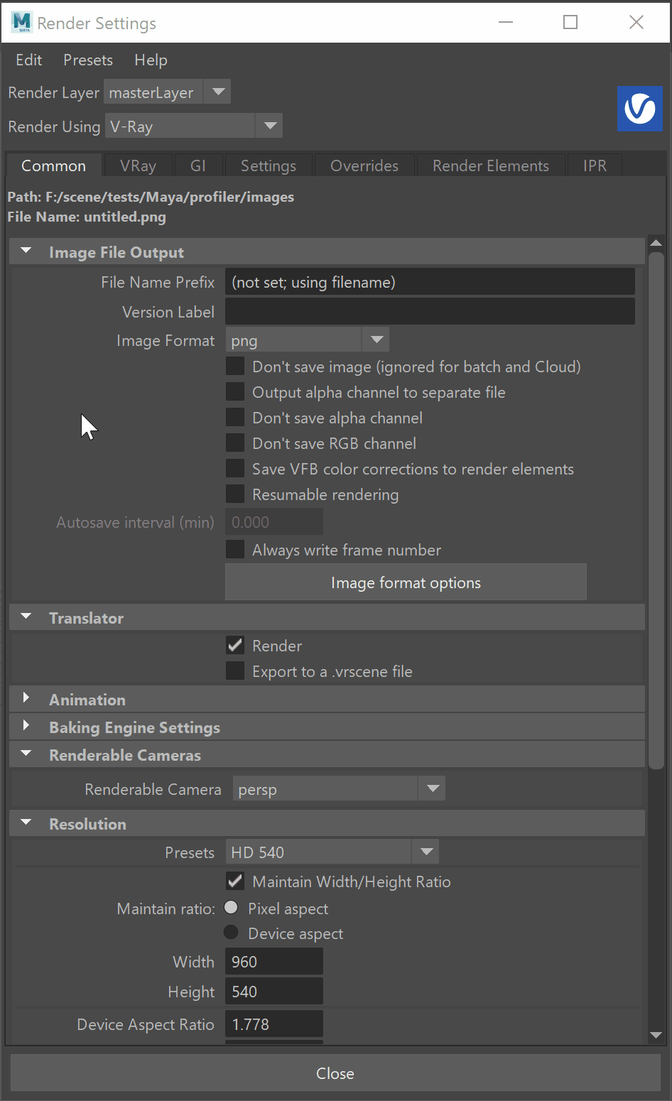

Navigate to the Render Settings window and select V-Ray GPU as the engine.
Go to the V-Ray tab > Renderer > Engine. From the drop-down menu, select V-Ray GPU.
You will see the V-Ray render devices selection rollout appear with a list of all supported devices found on your computer. If you have more than one GPU device, you can choose between them or use all of them. This is the place where you can enable the CPU device to render in hybrid mode with V-Ray GPU. For more information, please visit the GPU Setup page.
