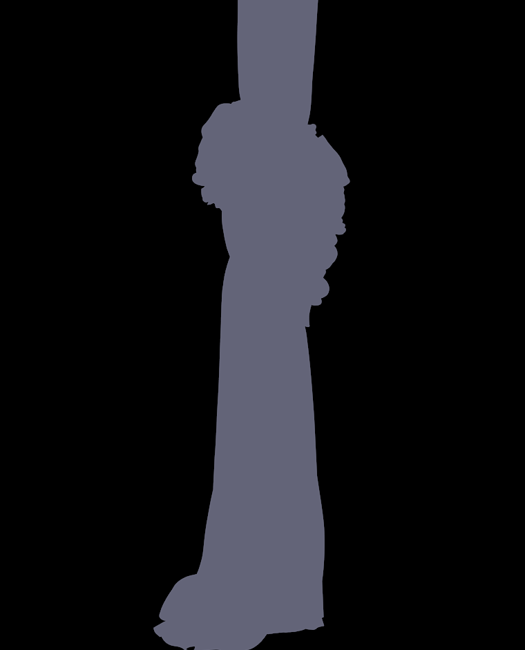

The Raw Sheen Reflection Filter Render Element is similar to the Sheer Filter Render Element, except it is not affected by Fresnel falloff. The result is a solid mask showing the areas of reflection calculated for the VRayMtl Sheen Layer.

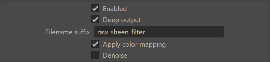

Attributes
Enabled When enabled, the render element appears in VFB.
Deep output – Specifies whether to include this render element in deep images.
Filename suffix – The text added to the end of the rendered file, when saved as a separate file (e.g. myrender.raw_sheen_reflection.vrimg).
Apply color mapping – Applies the color mapping options specified in the Color Management rollout of the VRay tab in the Render Settings window to this render element. This option is enabled by default.
Denoise – Enables the render element's denoising, provided the Denoiser render element is present.
