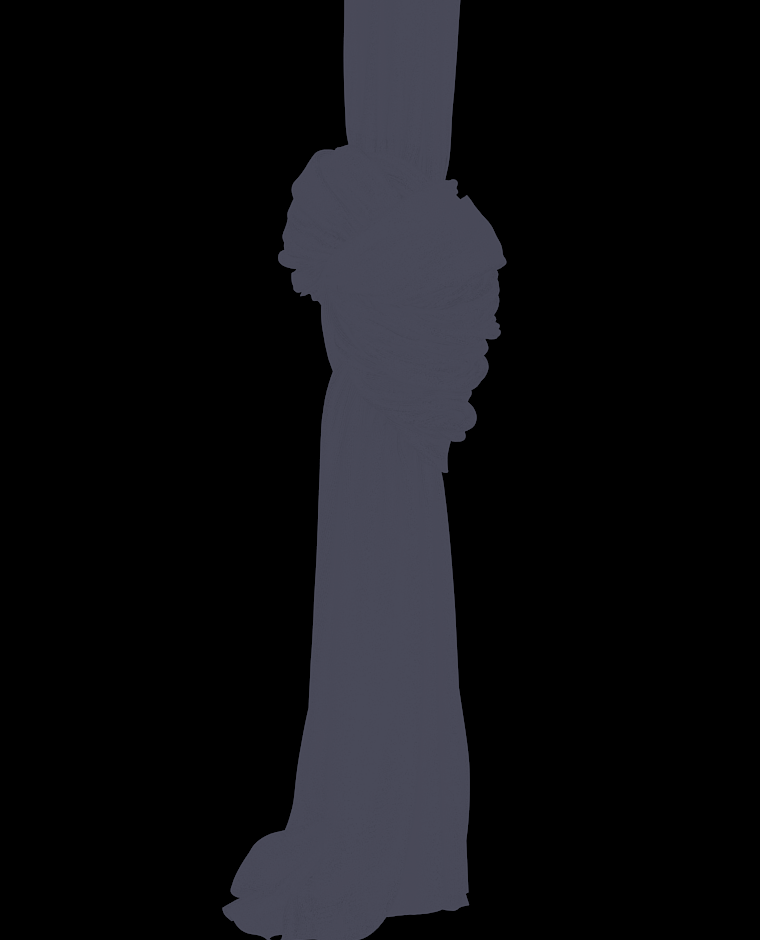

The Sheen Filter Render Element stores reflection information calculated from the VRayMtl Sheen Layer. Surfaces with no Sheen values set in its material(s) will contain no information in the render pass and will therefore render as black.
While the Raw Sheen Reflection Render Element gives the full reflection of objects reflecting in the scene, Sheen Filter RE shows how much of that reflection should come through in the composite. In other words, the filter defines the strength of the reflection, while the raw reflection channel defines what is being reflected in the image. When these two elements are multiplied, the true level of reflection is given and produces Sheen Reflection RE. Using these component parts of the reflection, you can better fine tune the reflection in your final composite.

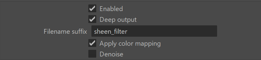

Attributes
Enabled When enabled, the render element appears in VFB.
Deep output – Specifies whether to include this render element in deep images.
Filename suffix – The text added to the end of the rendered file, when saved as a separate file (e.g. myrender.SheenFilter.vrimg).
Apply color mapping – Applies the color mapping options specified in the Color Management rollout of the VRay tab in the Render Settings window to this render element. This option is enabled by default.
Denoise – Enables the render element's denoising, provided the Denoiser render element is present.
