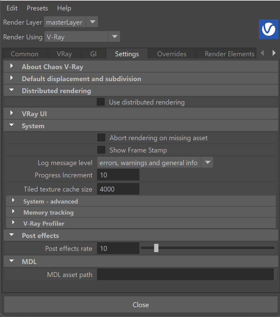

This page covers the Settings tab in the Render Settings window.
The Settings tab provides system-wide control for various V-Ray features.
UI Path: ||Render Settings window|| > Settings tab
Global Settings
The following rollouts change settings globally throughout V-Ray:
- Default displacement and subdivision - Controls displacement and subdivision quality.
- VRay UI - Customizes the V-Ray user interface.
- System - Customizes various system parameters such as memory usage and frame stamps.

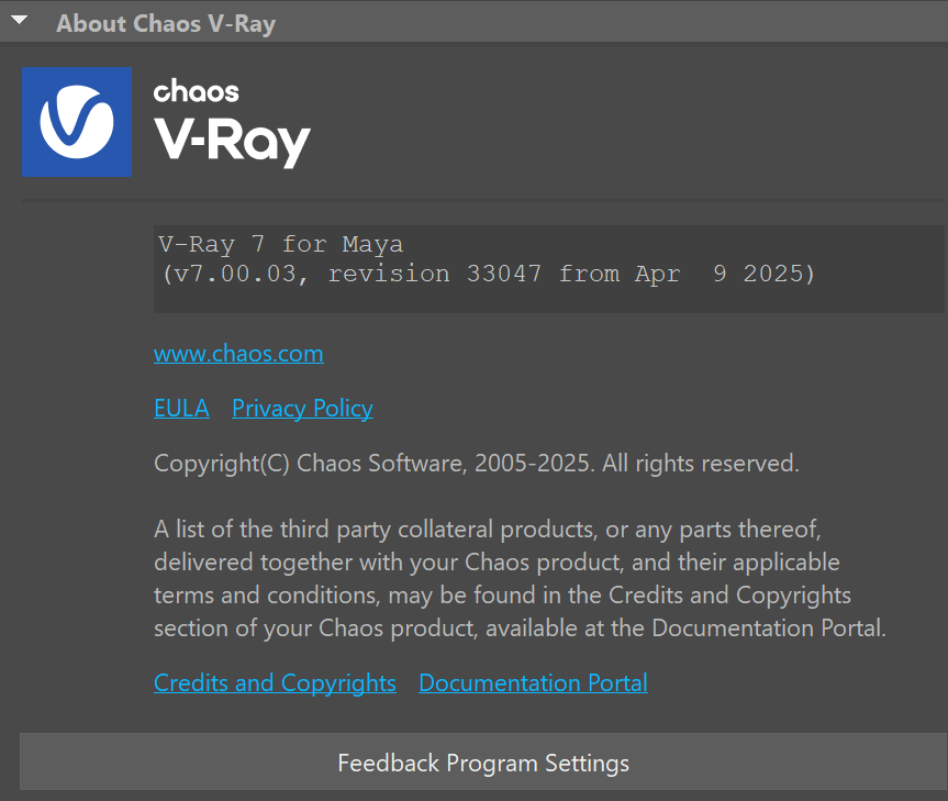

About Chaos V-Ray
The About Chaos V-Ray rollout holds information about the current V-Ray version that can be copied. The rollout also provides access to:
The About Chaos V-Ray rollout is accessible from the Render Settings window > Settings tab.

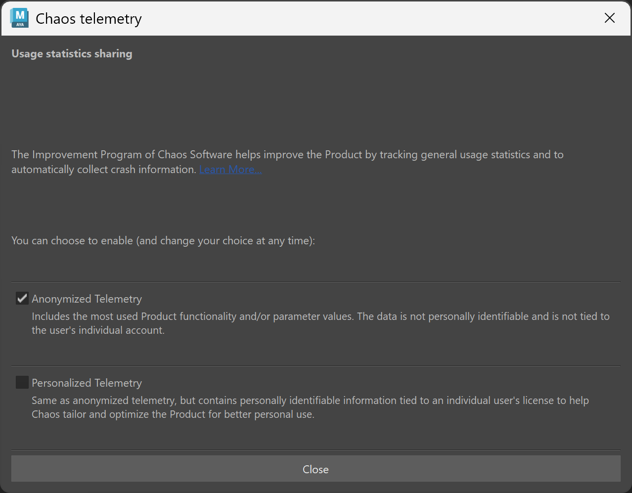

Chaos Telemetry Program
You can change your V-Ray telemetry settings from this window at any time. For more information on Chaos Telemetry Program, see the Chaos Telemetry page.
Rendering Over a Network
The Distributed rendering rollout enables or disables rendering over a network and provides settings for the rendering process.
