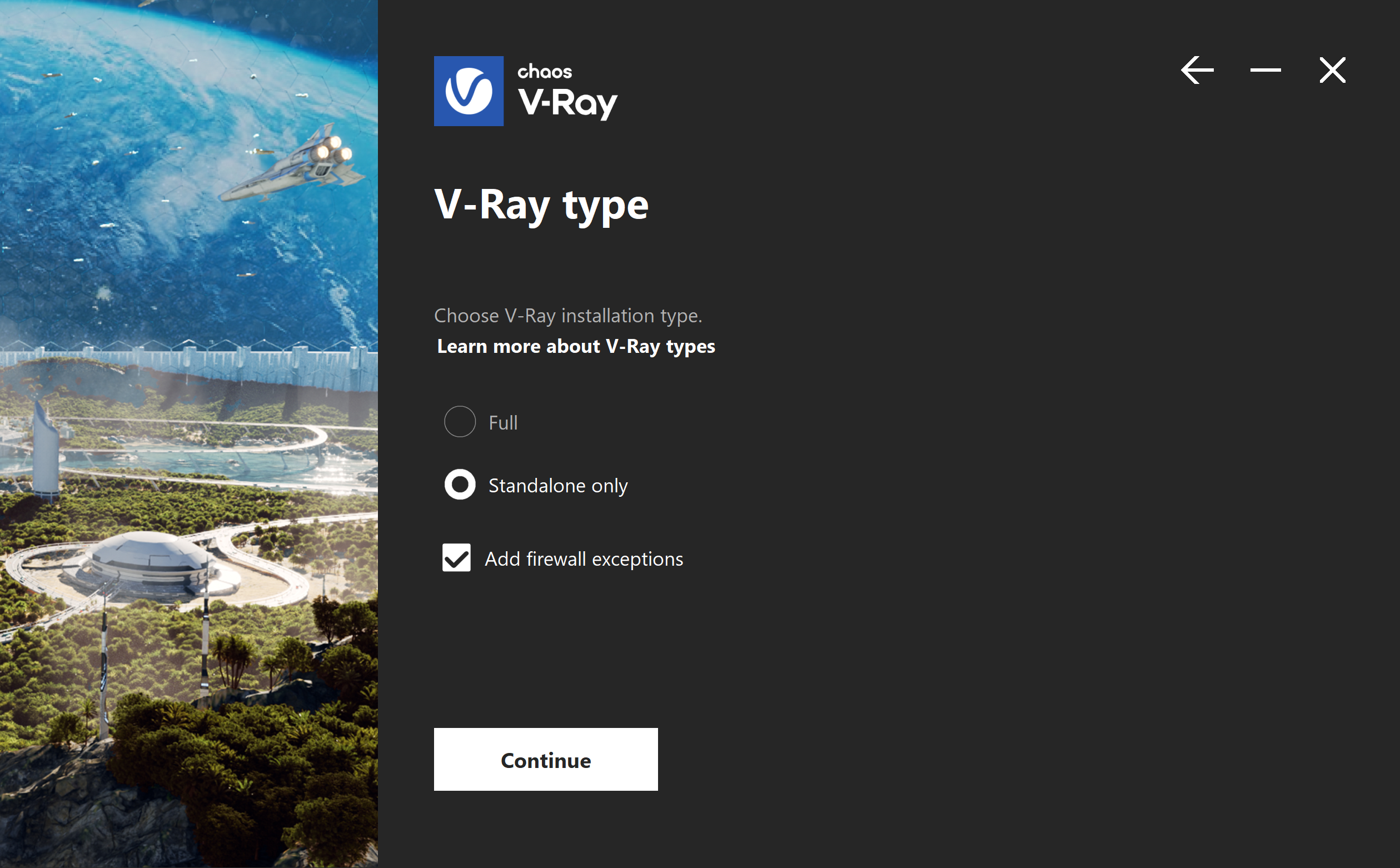

Similar to the process of getting V-Ray for Maya installed on your workstation, you'll need to install V-Ray for Maya on any computers to which you wish to distribute your render jobs. But instead of the Full install option, the Standalone only option works if you only plan to use that machine as a render server only.
Make sure to use the same version installer as the workstation from which you plan to render. This helps ensure that the V-Ray Core is the same version used on all servers, and prevents any mismatch of supported features. V-Ray standalone can also be used on a render machine that doesn't have Maya installed.

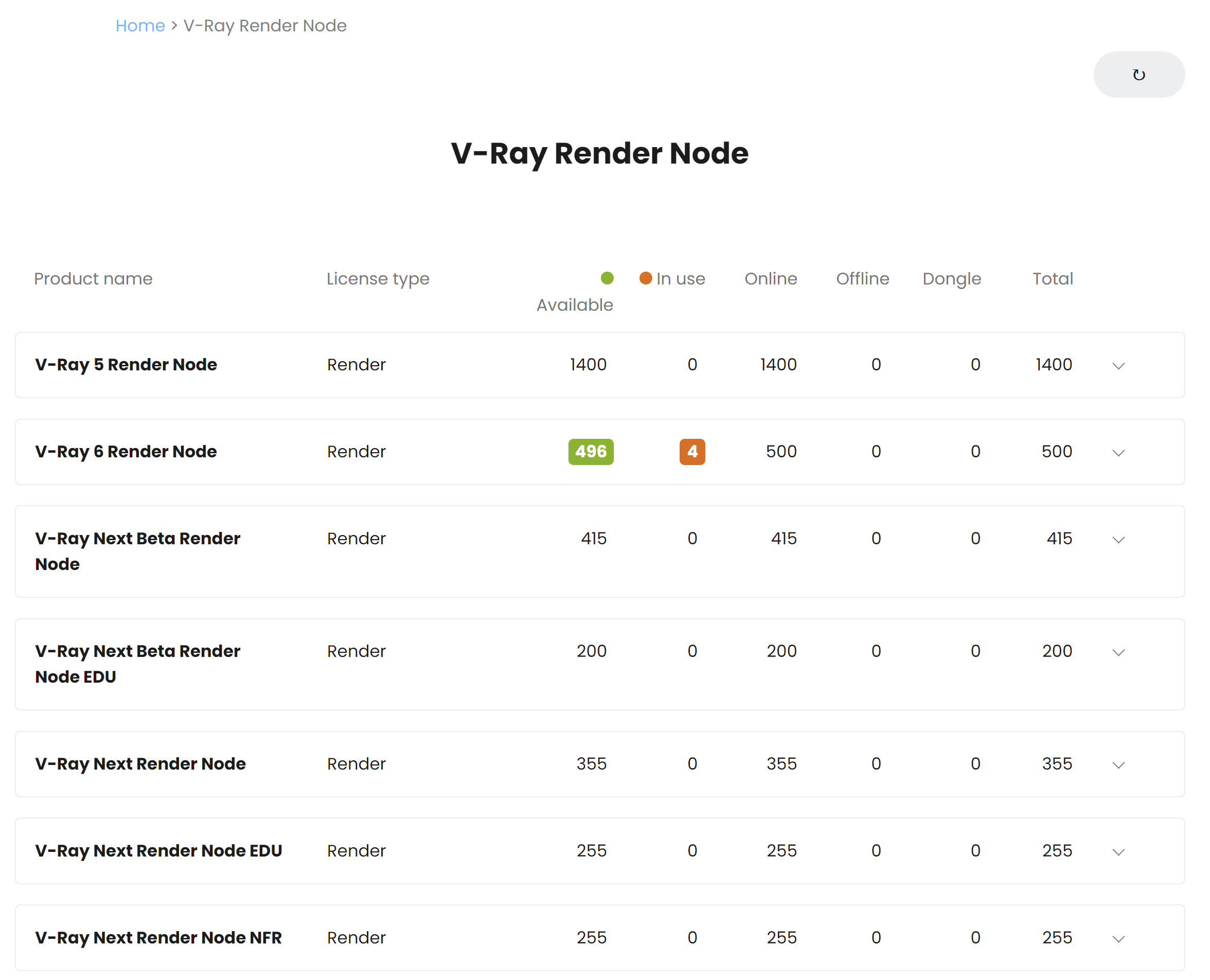

Next, make sure you have an active V-Ray License, by either installing the online license server on your computer, or by connecting to a license server on your network. Each render server will need access to a V-Ray Render Node license. This process is made easy with the V-Ray Online Licensing System by loading http://localhost:30304/#/ (or use the IP address of the computer running the licensing system, with the port 30304). For more details on this process, please see the Changing the Product License Setup page.
Important to note from the image above is the number of Render Node licenses that are Available.

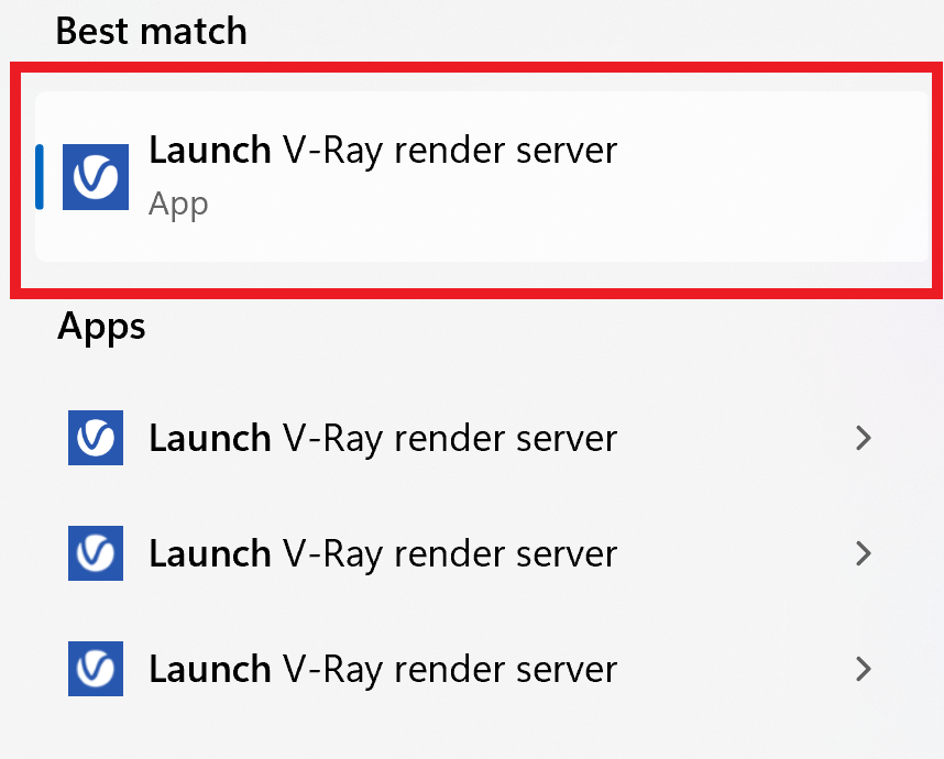

Now that everything is set and ready to go, we need to get the additional computers to start listening for render jobs on the network. Run the V-Ray Render Server application that is installed with V-Ray for Maya: Launch the V-Ray render server on all desired render machines. This is done in the Command Prompt for Windows with the following command: C:\Program Files\Chaos\V-Ray\Maya 2024 for x64\maya_vray\bin\vray.exe -server
For Linux and macOS, the vrayserver command is used and can be found at /usr/Chaos/V-Ray/Maya20xx-x64/vray/bin/vrayserver and /Applications/Chaos/V-Ray/Maya20xx/vray/bin/vrayserver
The executable is a shortcut linked to the vray.exe file with additional flags added to start the render server and open the correct communication port. This manual start process is great if you don't want the computer to render in server mode all the time. However, you'll have to remember to turn it on every time the computer starts up and you need it to render.
If you don't want to do this manually every time, simply register the server as a service either through the installation process or by registering the V-Ray render server application as a service through the OS.

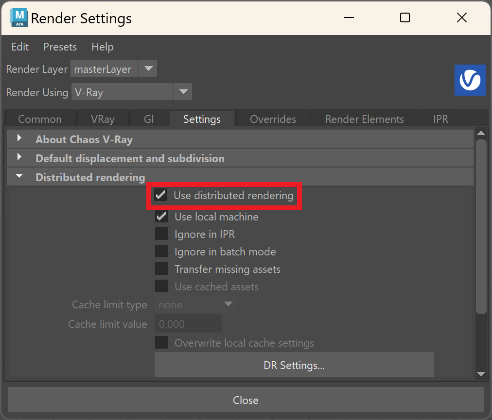

Once you have your scene in Maya ready to render, turn on Use distributed rendering from the Settings tab of the Maya Render Settings window.

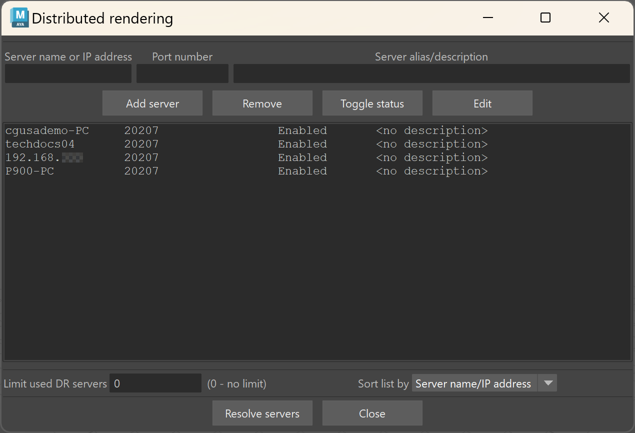

Let's first start with the DR Settings... button to make sure the nodes are set up in our Maya session.
Enter the name or IP address of the render servers into the Server name or IP address box in the upper left text box of the Distributed rendering settings window. The default port should be 20207. You can include a description, which is helpful if using IP addresses to help remind you which server is which.

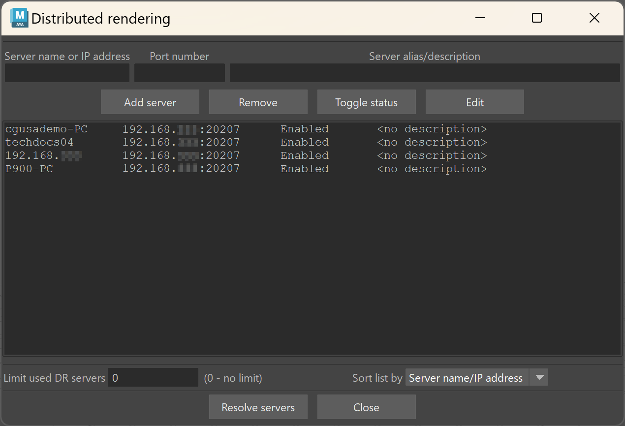

In case you entered server names instead of IP addresses, you will need to click Resolve servers to convert those entries from names to IP addresses, ensuring that your render client will be able to properly communicate with those machines. This step is not required if you have already entered IP addresses for all your render servers in this list.
Close the window and return to the Render Settings window. The rest of the settings below are optional, depending on how you want to render (or work while rendering).
If you prefer to offload the rendering to all the render servers and leave the resources on your computer more available for other tasks, disable Use local machine, so that your workstation will not help with the rendering process.
If you are using image textures, HDRI files, vray proxy objects, or any other kind of external assets, consider enabling Transfer missing assets. This makes local copies on your servers to ensure that they have access to the project's assets. This can also be used when your project is not saved in a shared location on a network. You can also enable  Use cached assets if you think you need to render more jobs from the same project and don't want to have to transfer project files every time you render. Cache limits can be set based on time or size to keep the cached assets from piling up and taking up too much hard drive space on the server machines. However, the commonly preferred workflow is to keep the project and its assets stored on a shared network drive so that renders can take place without having to wait for transfers.
