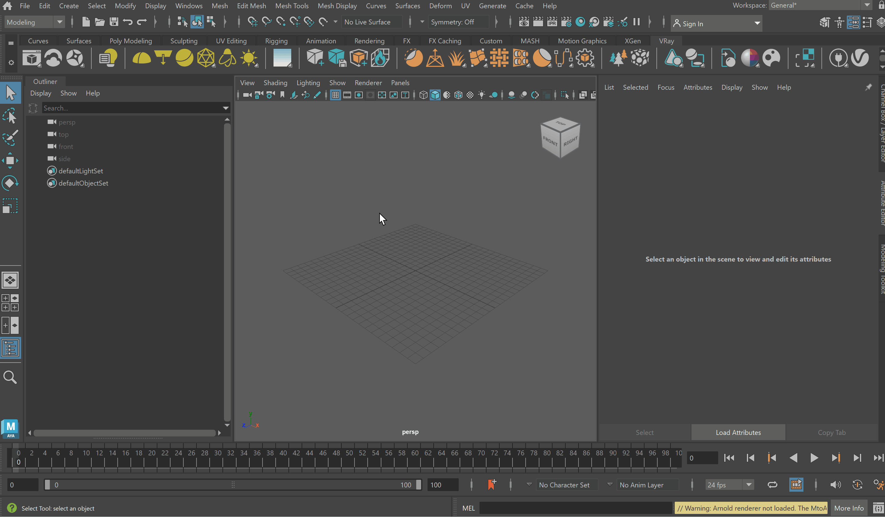

Start Maya.
Open the Plug-in Manager from the Windows > Settings/Preferences > Plug-in Manager menu. Load the vrayformaya.mll plugin.

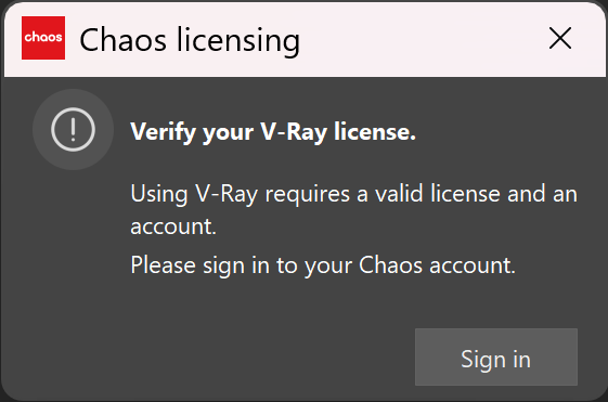

The first time you use V-Ray, a prompt to log in with your Chaos account may appear.

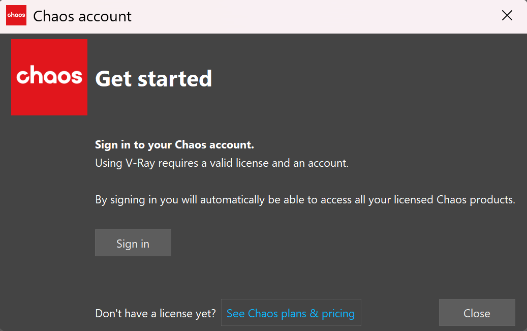

  • Open Maya and go to V-Ray menu > Licensing > Chaos Account.
  • Select Sign in from this dialog.

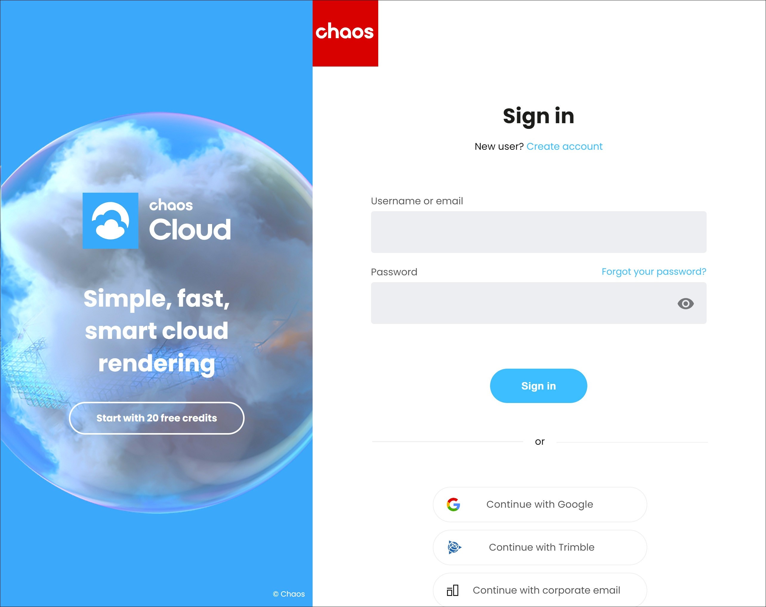

  • Enter your Chaos credentials.
You can use your Chaos account credentials.
Your existing Enscape, V-Ray, Corona, Anima or Veras logins are all Chaos accounts and work for all our products.
If you have never had a Chaos account, you can create one at this step.

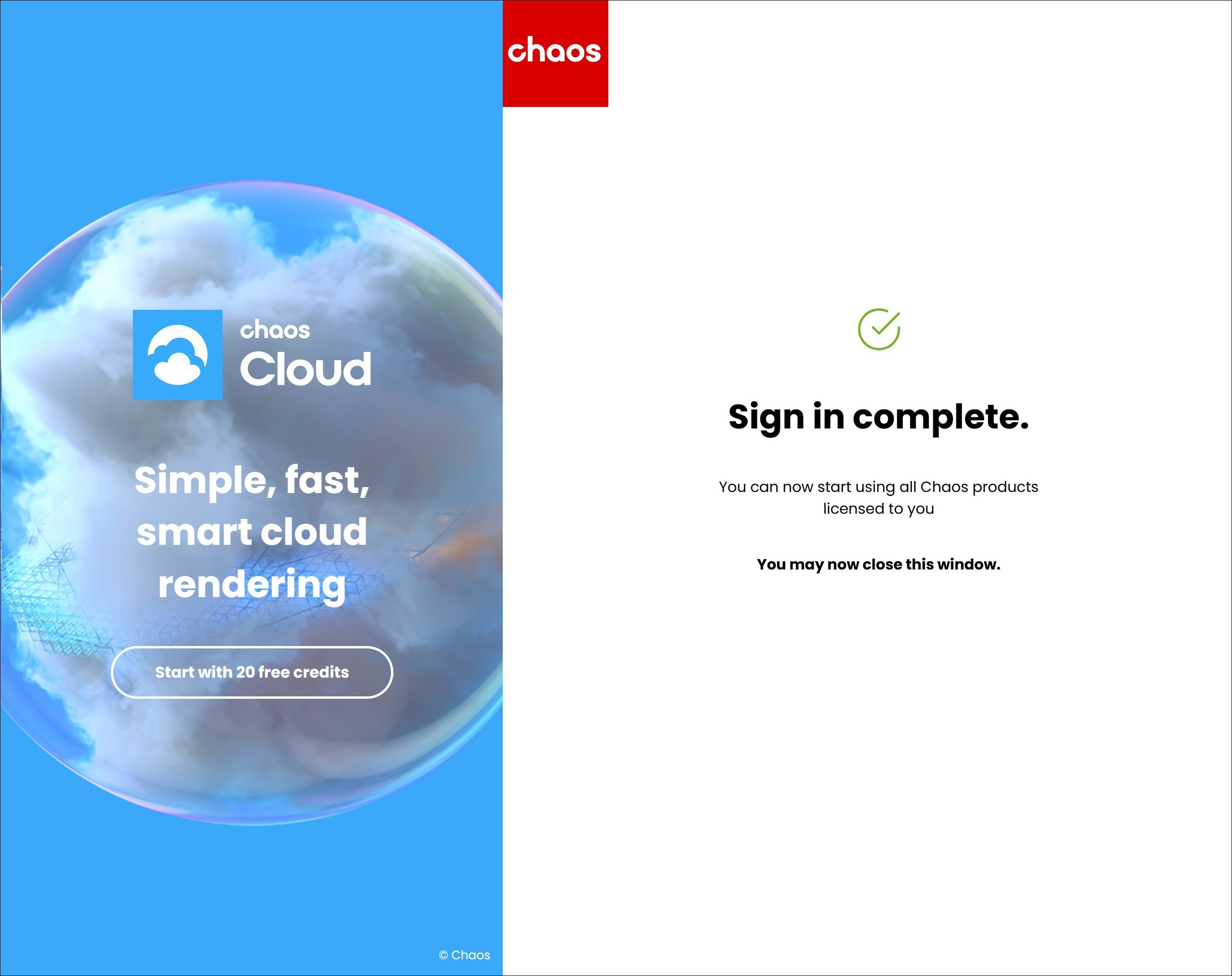

You can close the login page after seeing the confirmation for a successful login.
You can now start using your Chaos product.
