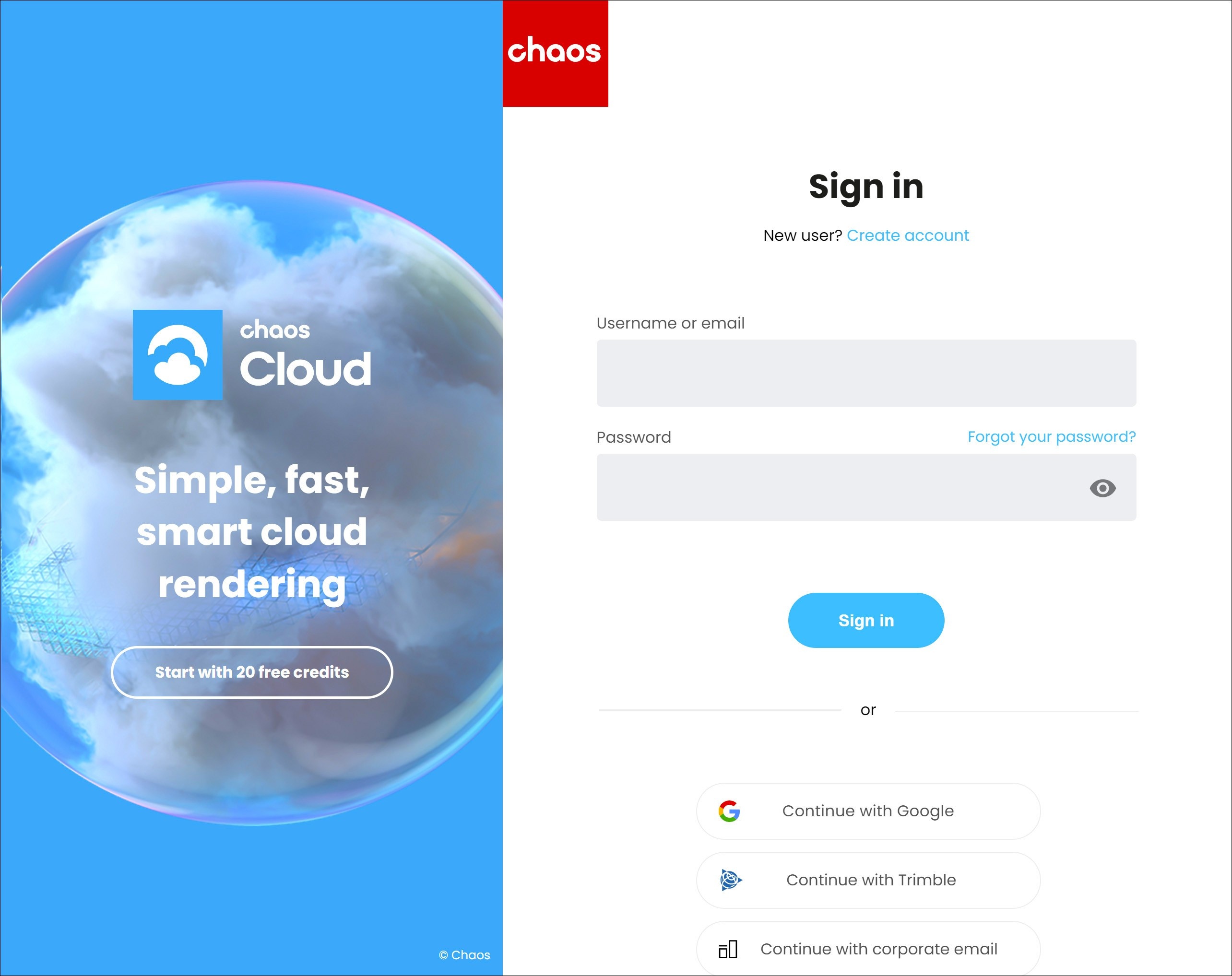

The first time you use V-Ray, a prompt to log in with your Chaos account may appear. |
Alternatively, - Open Maya and go to V-Ray menu > Licensing > Chaos Account.
- Select Sign in from this dialog.
- Enter your Chaos credentials.
You can use your Chaos account credentials. Your existing Enscape, V-Ray, Corona, Anima or Veras logins are all Chaos accounts and work for all our products. |
If you have never had a Chaos account, you can create one at this step. |
Chaos Single Sign-On Page |

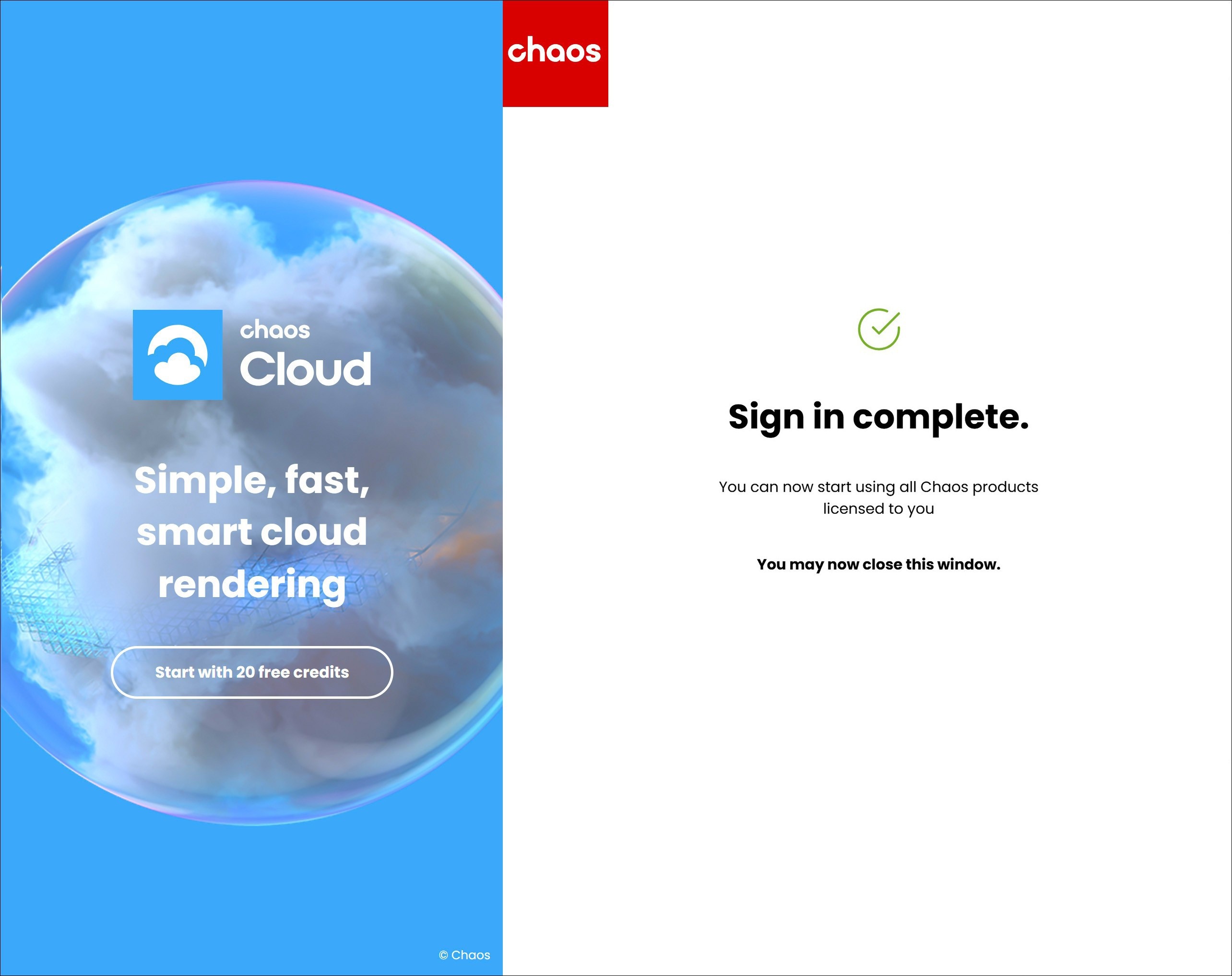

You can close the login page after seeing the confirmation for a successful login. You can now start using your Chaos product. |
Sign in confirmation |
