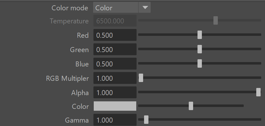

Basic Parameters
Color mode – Specifies the mode in which the color is determined:
Color – The color is directly specified by the Color parameter.
Temperature – The color temperature (in Kelvin) is specified by the Temperature parameter.
Red – Specifies the value for the Red channel. Note that the full intensity is reached at 1.0 for this parameter (and not 255).
Green – Specifies the value for the Green channel. Note that the full intensity is reached at 1.0 for this parameter (and not 255).
Blue – Specifies the value for the Blue channel. Note that the full intensity is reached at 1.0 for this parameter (and not 255).
RGB multiplier – Specifies a multiplier for the color strength.
Alpha – Specifies the value for the Alpha channel. Note that the full intensity is reached at 1.0 for this parameter (and not 255).
Color – This color swatch can be used to visualize the resulting color. It can also be double-clicked to bring up the standard Maya color chooser.
Gamma – Specifies a gamma correction applied during rendering. This does not affect the Color swatch.

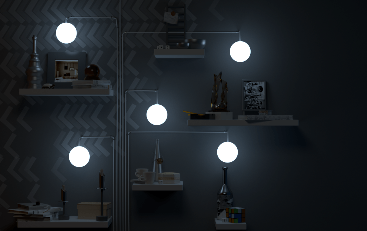

In each example below, the sphere lights have the same VRayLightMt applied to them.  A VRayTemperature texture map is applied to the VRayLightMtl to show various color temperatures between each example image.  The VRayTemperature has Color mode set to Temperature.
In the final image below, five separate VRayTemperature texture maps were used, each with a different color temperature to show a variation. No other changes were made to the VRayLightMt.

Each mesh lights uses a different VRayLightMt & VRayTemperature,
each with its Color mode set to a different Temperature value
