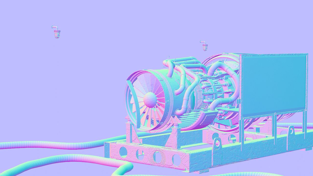

Bump Normals Render Element

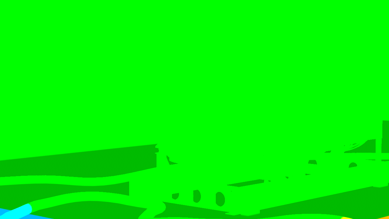

The World Positions pass

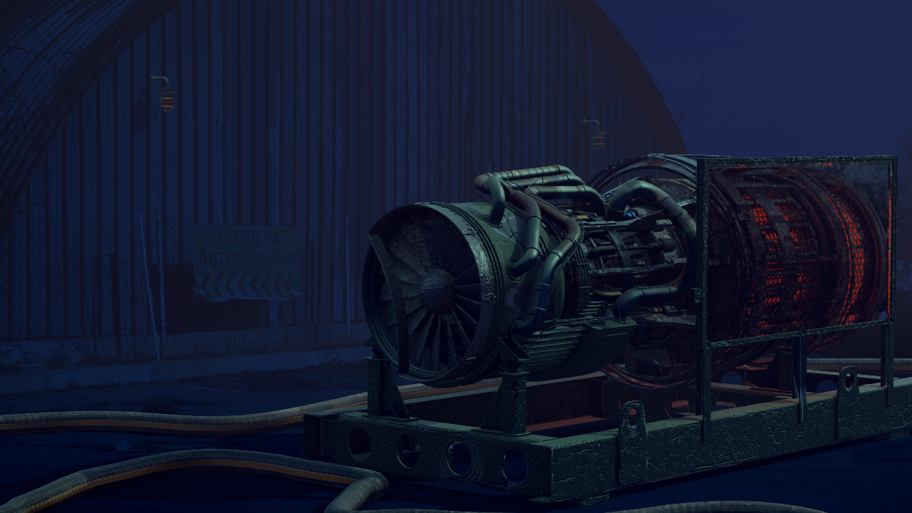

Original Beauty Composite
